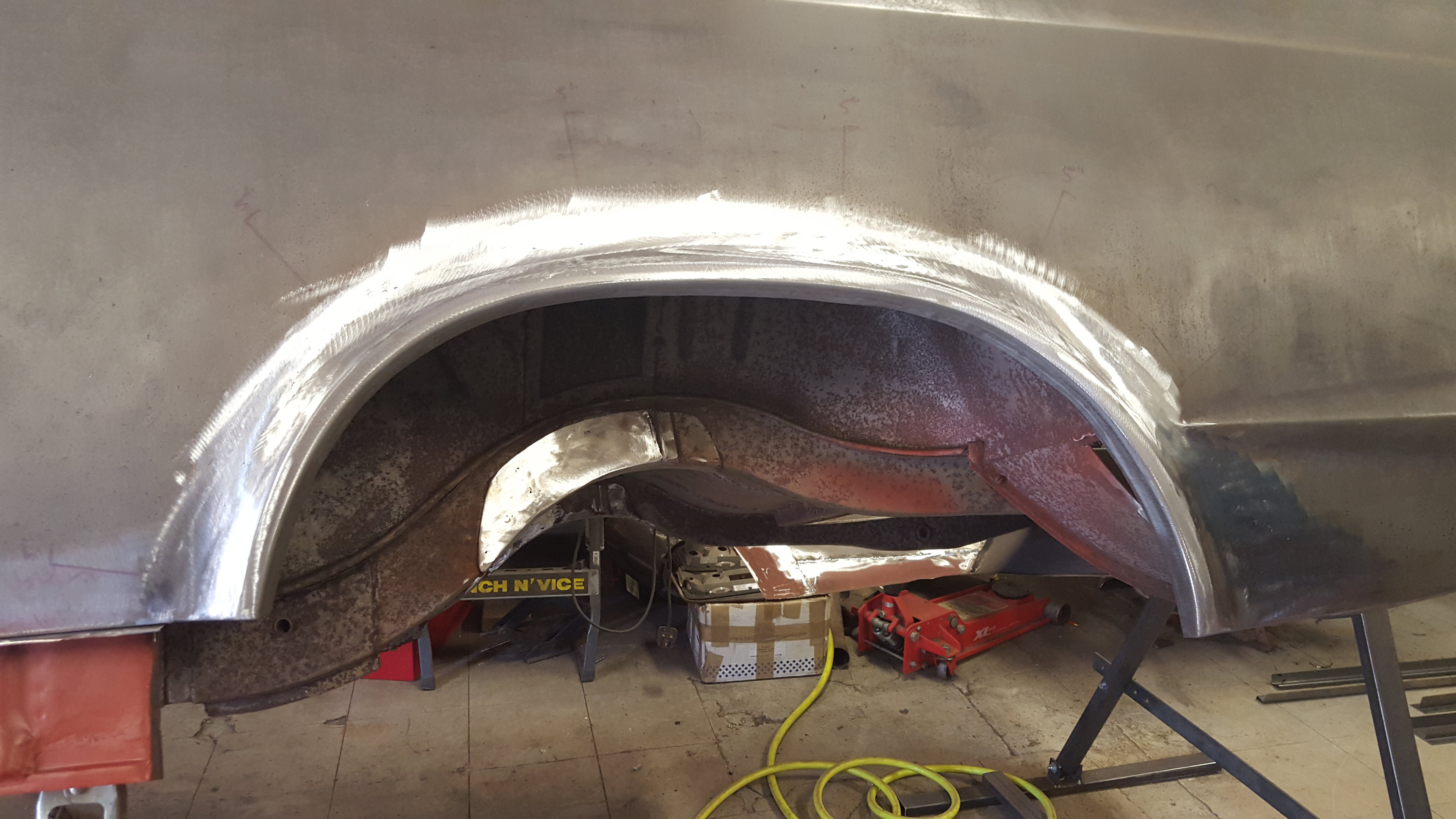

The Aston would take around 60 hours to do the inner, outer sills and the rear radius arm area. On one side.
An outer arch to do it nicely takes about 6 hours. You have to take your time to weld it in. The sill could be done replaced in a day. So it just depends on hourly rates.
You could easily spend a few days replacing outer sills and repairing the inners where needed.

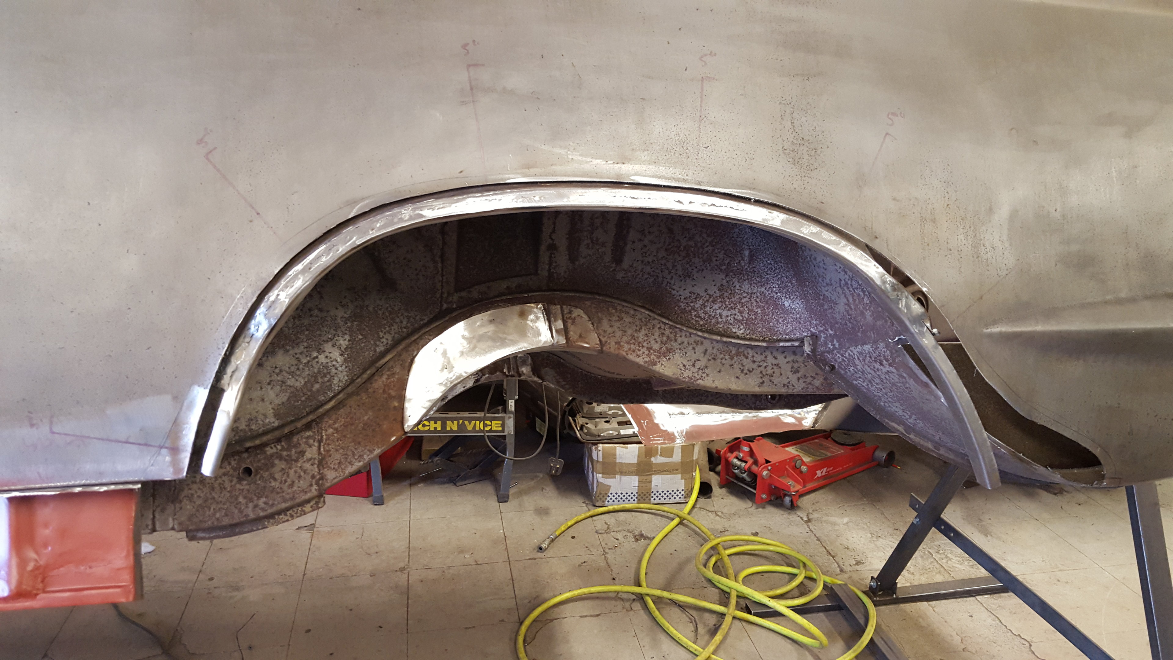

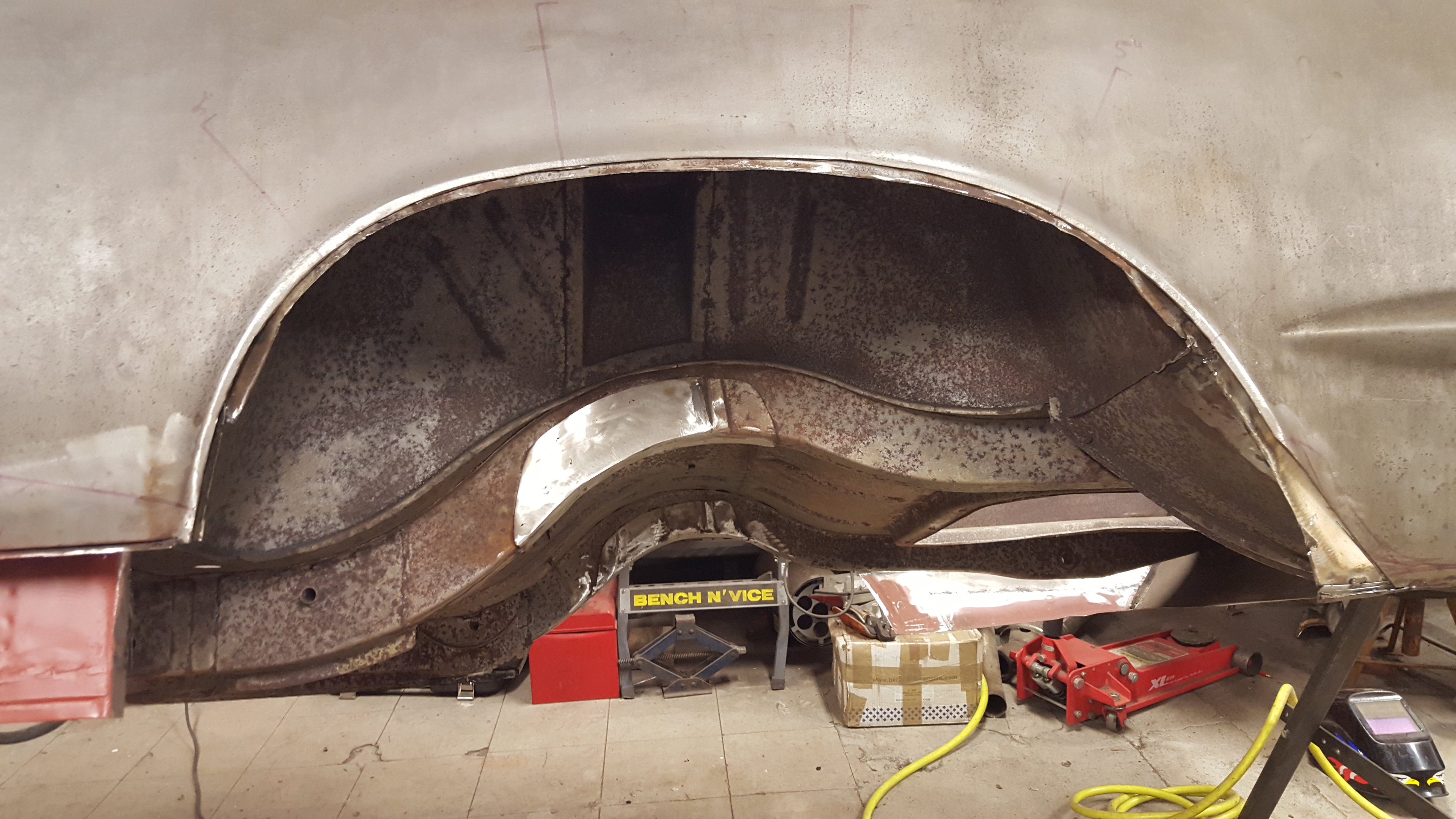

Here's a mk1 Lotus Cortina rear arch.
Completely butt welded in, no overlapping.

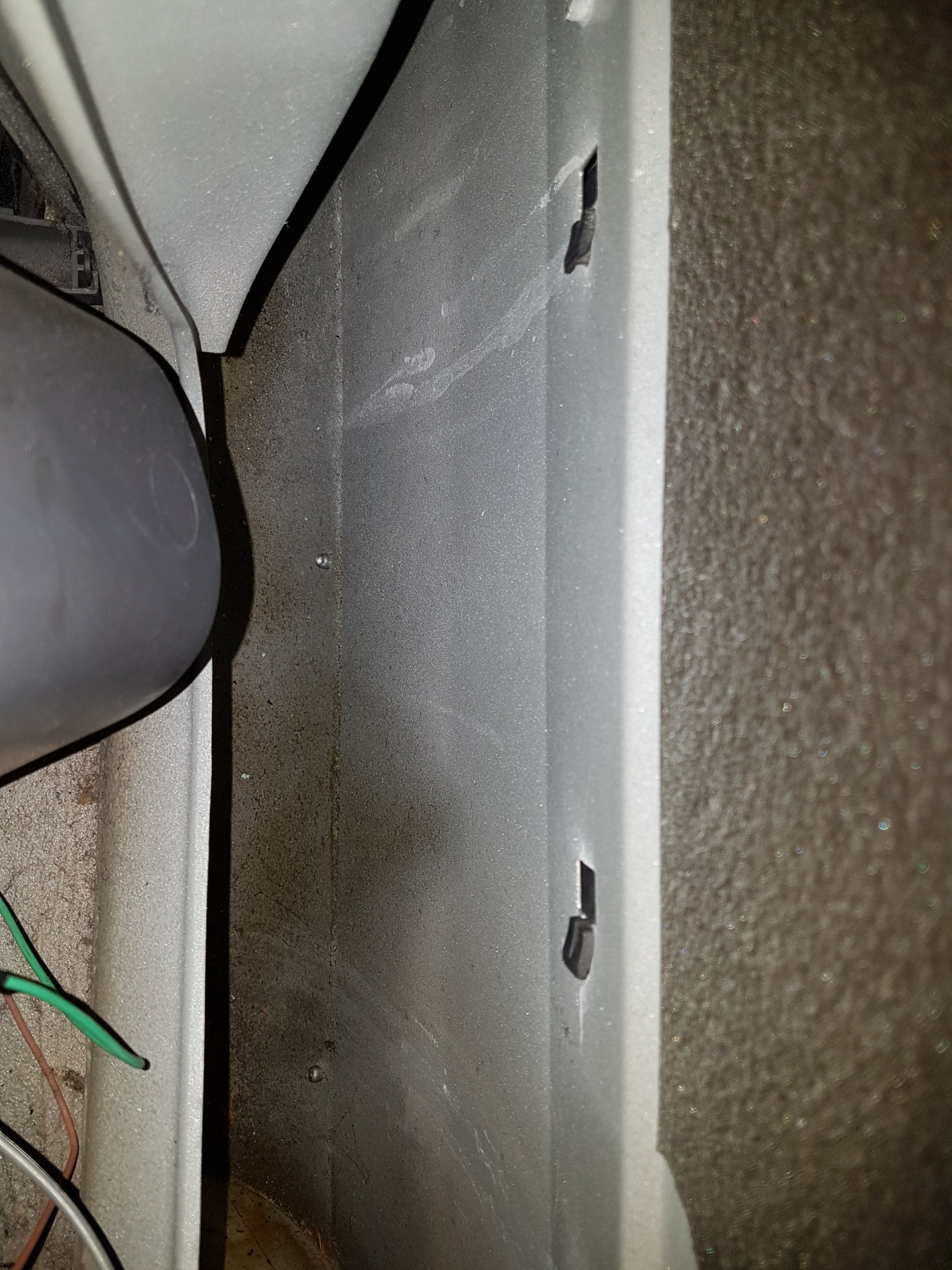

Do the rear door cards simply pop off in order to inspect these areas?
If so - is there a preference in how to remove them? The clips holding them in are fragile, I'm led to believe?

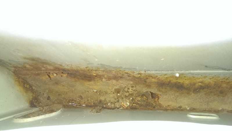

Despite a dire need of a polish, the external view of its first wash in about three months yesterday looks ok from the outside. Its the view from the inside that concerns me!

@Darren S the best way is flip your seats forward, remove lower rear bench sections and undo the plastic fixing at the bottom on show and also the 17mm? bolts holding the the metal seat belt buckle fixing at the bottom, peel back the door rubber seals and also think you need to remove the front seat belt sliding bars, then they are clipped and also hooked over a lip at the bottom of the rear windows. So you need to pull them inwards and then upwards if this makes sense. Be careful not to rip your speaker wires out, or just remove them first if your unsure, and the cards are also clipped firmly with large lugs into the boot / parcel shelf plastics, but you shouldn't need to remove the complete door card just to inspect the areas in question anyway.

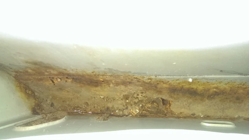

What do you reckon Gally, is mine treatable from the inside? Sill is solid when poked with screw driver.

If you look closely you can see where the water has got in through the side molding and sat in the sill with no where to go.

Take the skirts off and poke from outside, mine was much worse with the skirts removed. Done be deceived by it feeling solid inside, mine was packed solid with crap in the skirt.

I was poking fooking hard! TBH i might just be done with it and fit new sills. I don't think they are shot but I don't want to do the job twice. Given the rust is minor now would be the right time. Anyone know if you can buy new sills from Renault? Would make the job much easier.

I think you can buy the front part of the sill but the rear comes complete with the 1/4 panel.

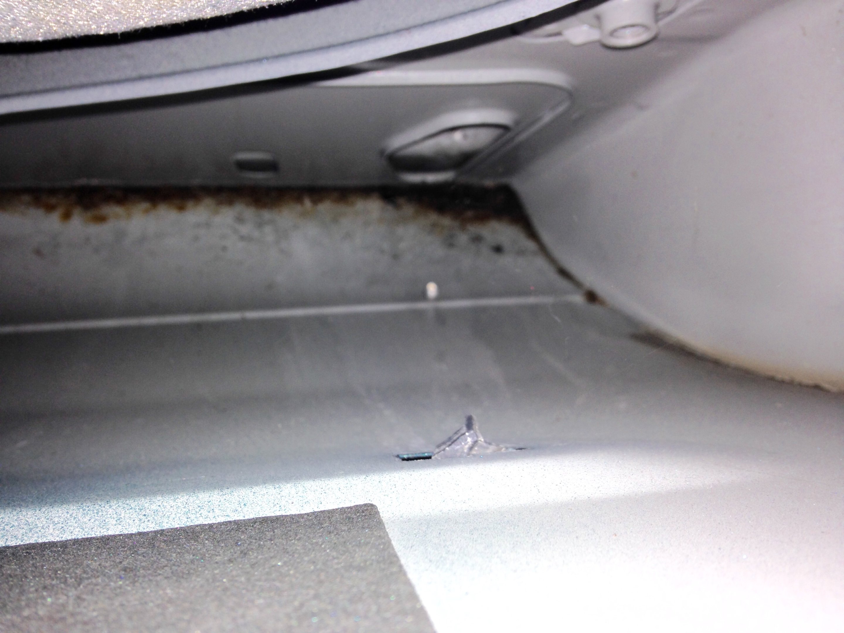

Had a look at my wife's tonight after finding mine were a little rotten.
Lou's ph1 and inside the sill.
Waxoyled. I'll be giving it some more this year!

As mentioned, it could be fixable.. Replacement sill sections are available from the like of Euro Car Parts for about £42. The new section is big enough in height to cover the removed section of rust.
Full length replacement sills are available, and the rear part extends up into the rear quarter by about 150/200mm from memory.

It doesn't look to bad, I wouldn't have thought you'd be able to hole it. If you've removed the interior panel completely see if you can clean it up a little, pour in some kurust maybe Jack up the back of the car or go for a short drive. Let I'd dry for a few days then get some dinitrol waxoyl, they do one which has an inhibitor in it to neutralise it. If your keeping it then see how it looks in 6-12 months before you decide on fitting sills?

Will get some ordered and fit when the summers out. If they are as you say I will have the rear 1/4 modified so it's just the sill, don't want the 1/4 panel touched as it's bang on.

That's an idea, Phaser suggested something along the same wave length.
