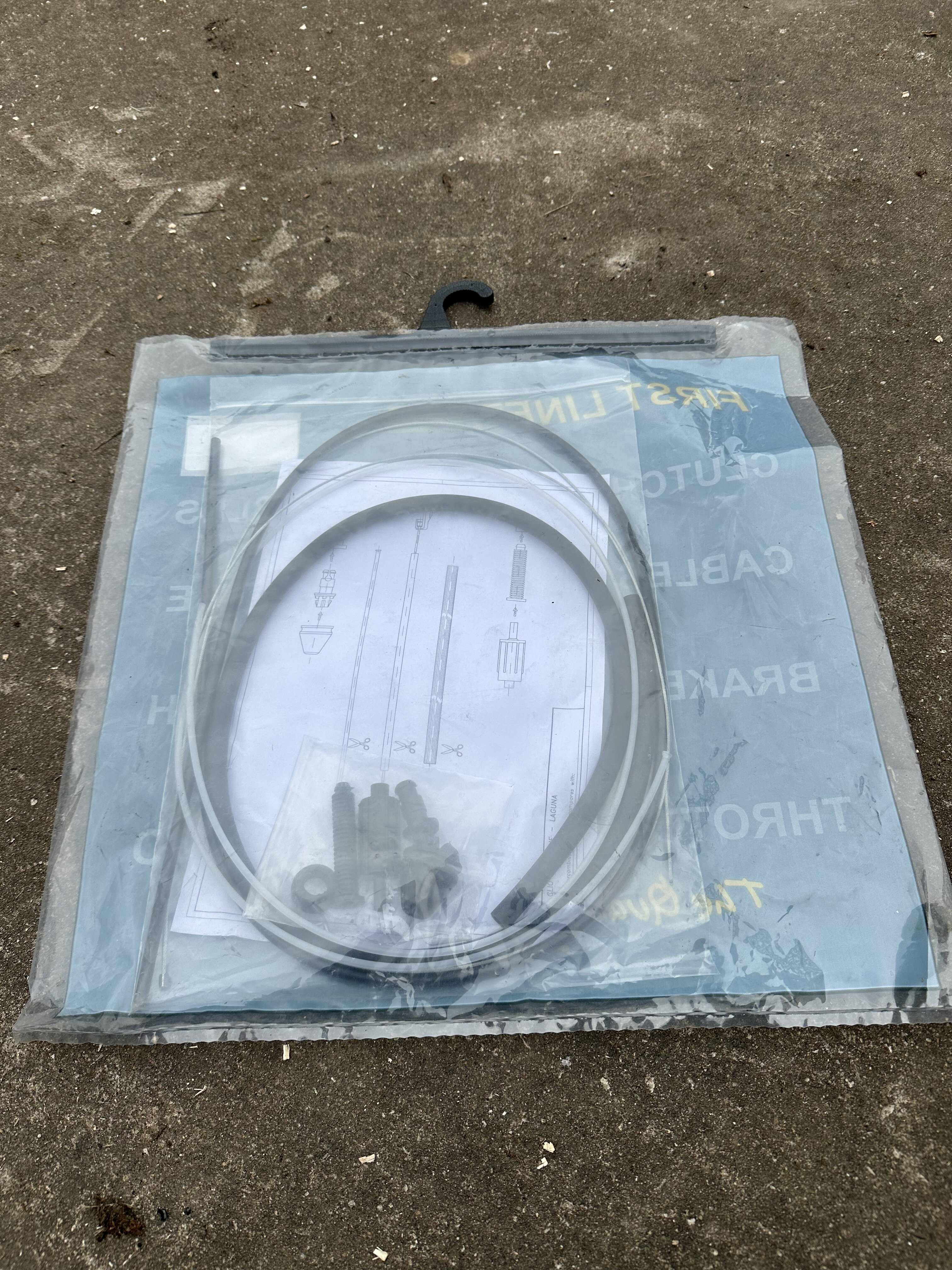

KitsonRis
I’ve got this one from GSF on mine
The shealth goes all the way from the bulk head to the throtte which from past experiences most do not and have some exposed cable.
Annoyingly I had to cut mine down but this is to get a better cable routing for the ITB's but should not be a problem with a standard throttle body
