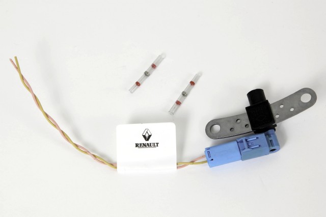

Most likely the TDC. Mine did this last year, replaced it with the newer 'upgraded' version and zip tied it in place to be more secure and its not done it since.
it could be something else as im no mechanic so don't just take my word for it but it does sound similar to what mine did and would only crank after rocking or moving the car slightly. Just don't think the sensor was picking up a signal correctly. left it like this for about a week and one morning on the way to work it just kept almost dying at anything over 3k revs then eventually died further up the road

Now, it's been a while but I'm 99% sure the TDC sensor has no effect on the fuel pump. Fuel pump should prime when you turn the key to stage 2 without cranking.
  dan's cast offs.
IT IS NOT YOUR TDC SENSOR. don't waste your money buying one. relays or wiring under fuse box first port of call.
