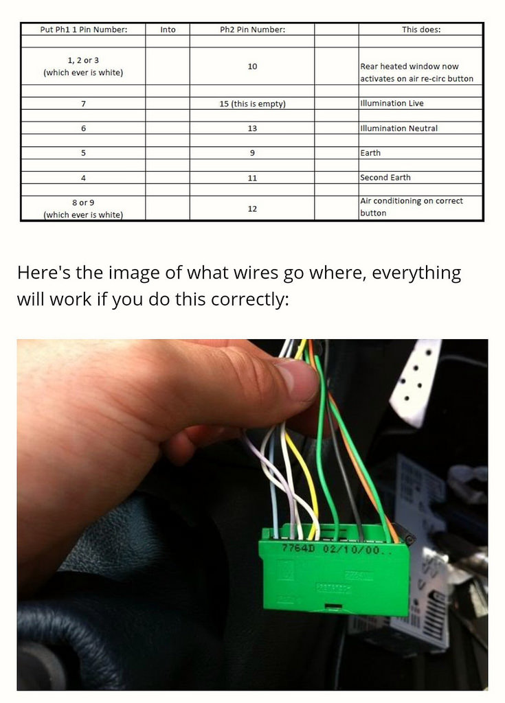

Heater controls don't light up when lights are on and aircon button doesn't work
It's all wired as per guide in image below. however I didn't do the wiring so I don't even know what white wires are the right ones, there are more than one!
2018-07-17_12-01-21
Aircon button does nothing, doesnt light up, doesn't engage aircon pump. Relay and fuses are fine.
Recirculation button lights up and only then will aircon button light up if fan, speed is on speed 2 or above.. But aircon pump still won't engage ?
Is there a way to just ghetto wire a switch for the on /off of aircon? It's a black Ph1 and I'm sweating!!

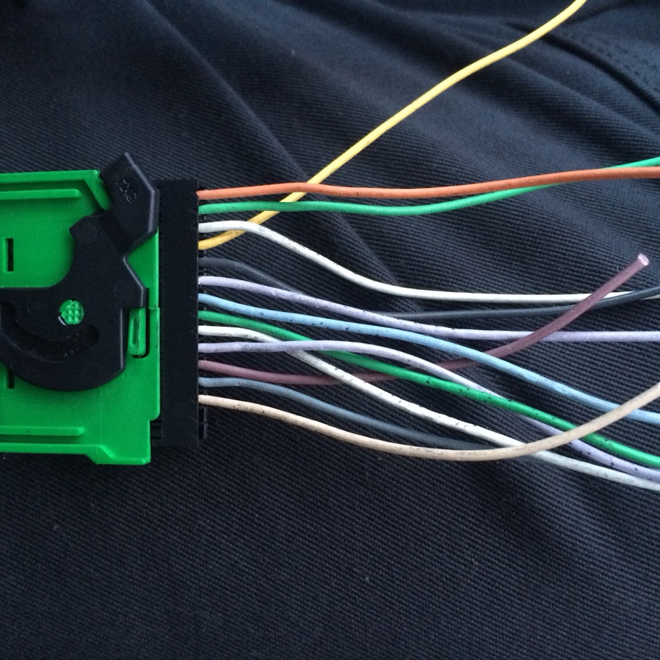

This is the Ph1 wiring plug ,
so I’m guessing you need to know what does what ?
I’ll see if I can find some generic diagrams to come up with some info .
