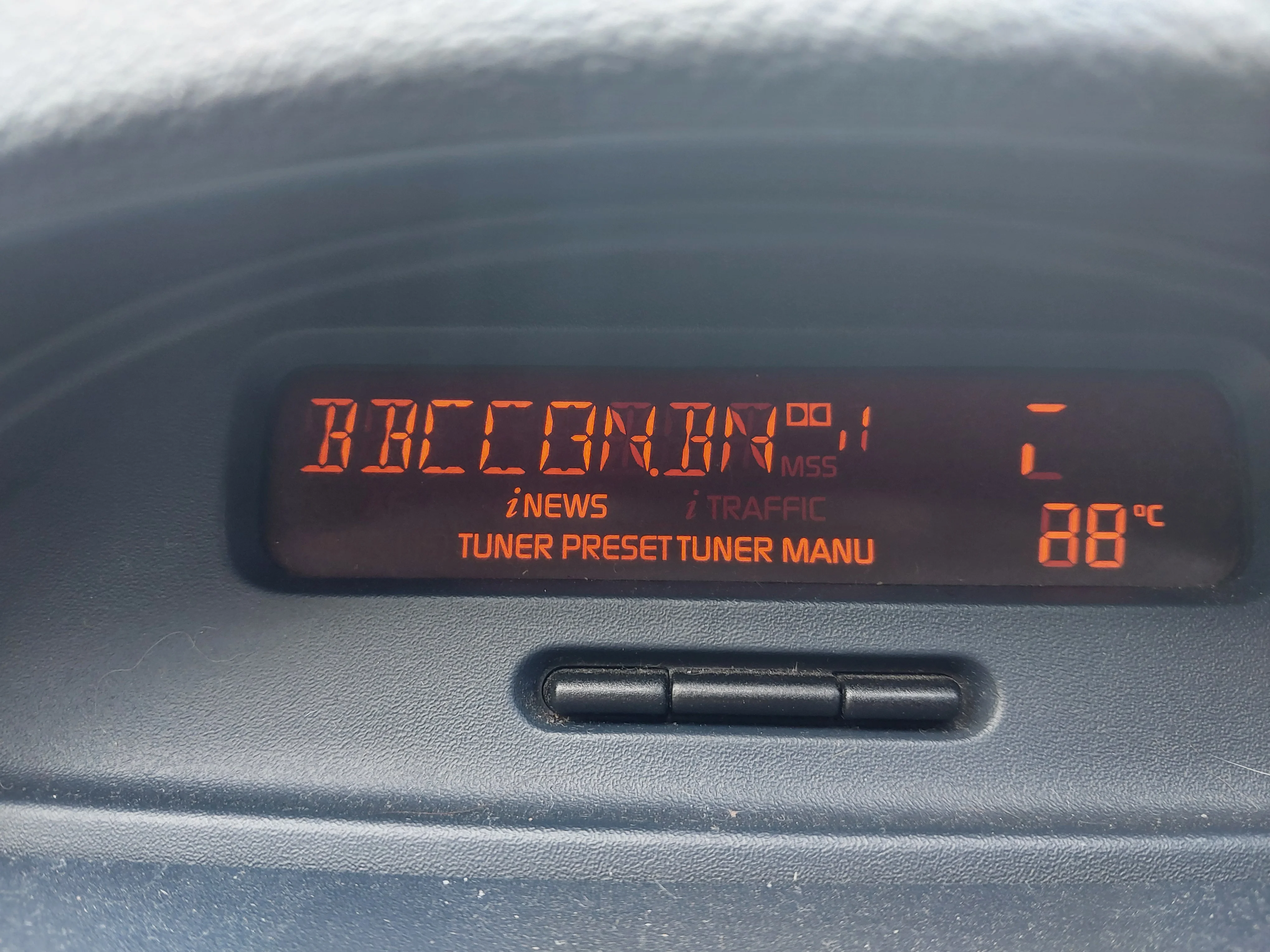

Back in the Summer, I locked up my PH1 172 for a few minutes. Upon returning, the key fob wouldn't work. I then had to open the car manually, but the alarm kept going off - and there was nothing I could do to stop or reset it. Starting didn't seem affected and the key appears to work with the immobiliser fine. After that point, the radio display's been garbled (see photo attached).

I am pondering whether there is a connection between the intermittent fan / garbled radio display / alarm problem. Could the UCH be to blame? Is the radio display connected, or is it more liikely having problems on its own?
Sounds like UCH or Easter ingress into the loom itself perhaps. You'll need a specialist look at it imo, maybe not Renault in particular but a car wiring specialist may be able diagnose
