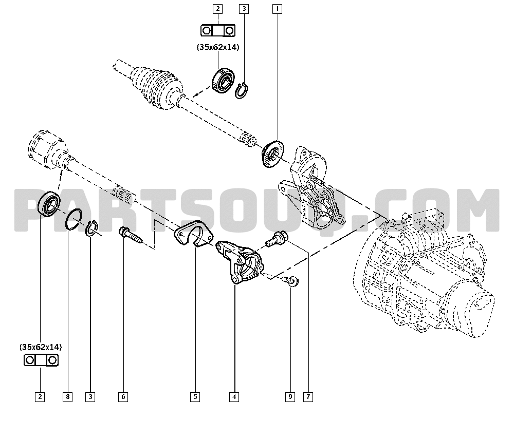

One option open to you is fit the wider spaced Ph2 front subframe and use 172 Cup driveshafts, though these are now £370 a side OE from Ktec racing
Shaftec R209AR & R209AL are around £100 a side, and a friend has experienced no problems to date with Shaftec in 50k miles of use.
You can still buy a RH 182 OE & LH 182 Cup shaft, though you have to swap the 15mm ABS ring for a 7.5mm on the 182 Cup shaft.
https://www.k-tecracing.com/search.asp?catid=45
Also you would need a mid bearing support housing 8200186845 from a 182 or non Cup 172 Ph2, and I`m not sure if the F4R 730, 732 blocks have mountings to fit one.
You will need to check the rear of your block.
