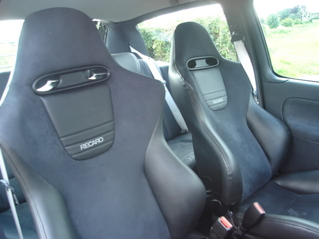

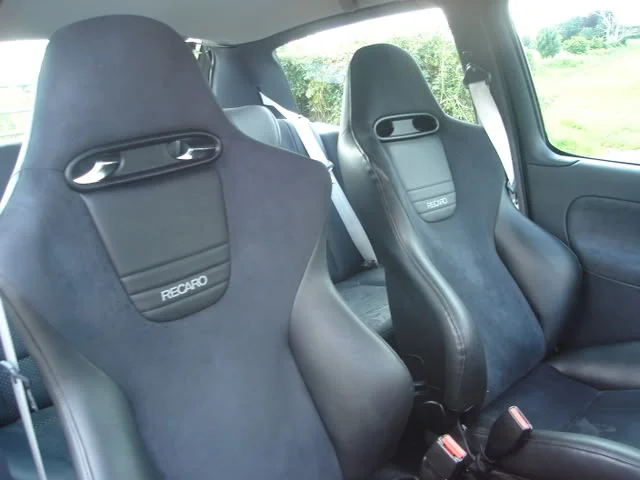

ok
Gaz_
  Extreme mode
Excellent. I could still get £700 ~ if i sold them tomorrow. Not a bad investment imo.

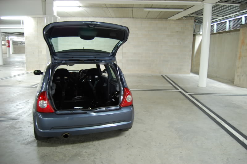

not 172/182 like, but.........
£250 for the pair off ebay, then had to buy sidemounts and harnesses, and have subframes made for the car.......worth it tho imo
  SchwepTek™
Ooooo really like them! Whats with the sidemounts and subframes?!?!?! I dont understand LOL!!! It don't matter that ur car isnt 1*2 anyway coz its sexy as fcuk!! Love the new springs too mate!
basically when you take original seats out, the mounts are attached to the seat, and the runners to the car...........which is no good for buckets.......
because the seats are side mounted, you have to get sidemounts.......but these need something to attach to, a subframe............ subframe bolts into the car using the original seat holes......then the sidemounts bolt to these, and the seat to the sidemounts :)
subframes
subframes in car
subframes with sidemounts bolted in
you can buy them premade...........just all depends what seats you want and if you want them to slide etc........as mine are fully fixed............
