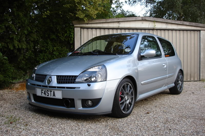

looking good brian, what brakes are they?
jamie
Aye, it is one of the nicest clio's going (even better in the flesh!)
Tho iirc you said the bremos didnt actually make that much difference? :rasp:
Lol! Yeah, like I said, I'm probably too used to them now and you kind of get reminded they are there when you 'use' them - which I don't very often! lol! If that makes sense!

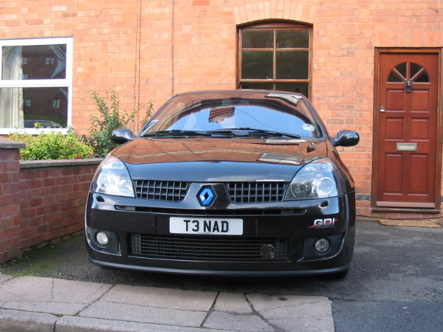

brian you havent got a silly massive exhaust on it have you? wouldnt mind a look myself at some exterior photos, if you have time and dont mind of course, turbodurbo@msn.com if you please.
cheers, jamie

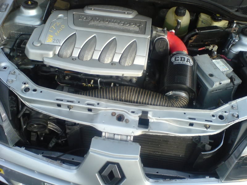

Hears mine, you can see the chrome pipe in the lower grill
  My trusty lil 182 :)

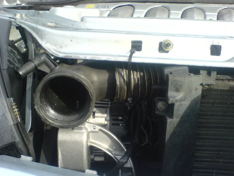

Might be a stupid question but how did all you guys get the feed down to the front grill? looked really tight in my engine bay, didn't think i could get a decent size pipe down.
Removed the valve etc to fit the feed wich is longer than the standard one you get with the induction kits :)
