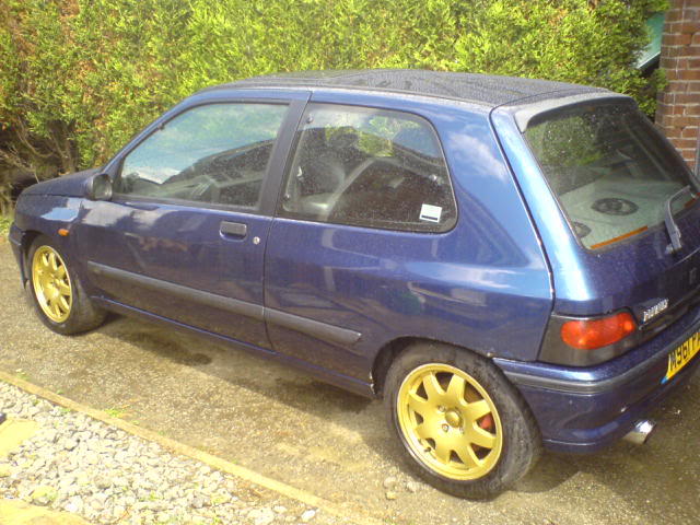

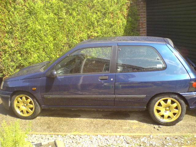

anyway after diagnosing the problem i treated the old girl to meguiars stage 1,2 and 3 ro brighten her up. could tell the car had never been polished in its life!! just finished waxing it and the heavens opened so the only pics i have are of it wet
(also removed the williams stickers the owner before last had put on :nono: )

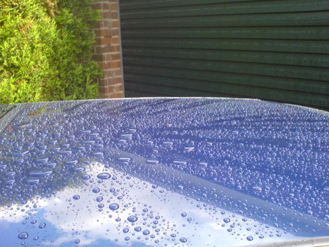

bit of beading on the roof
not bad for £380
not bad for £380
