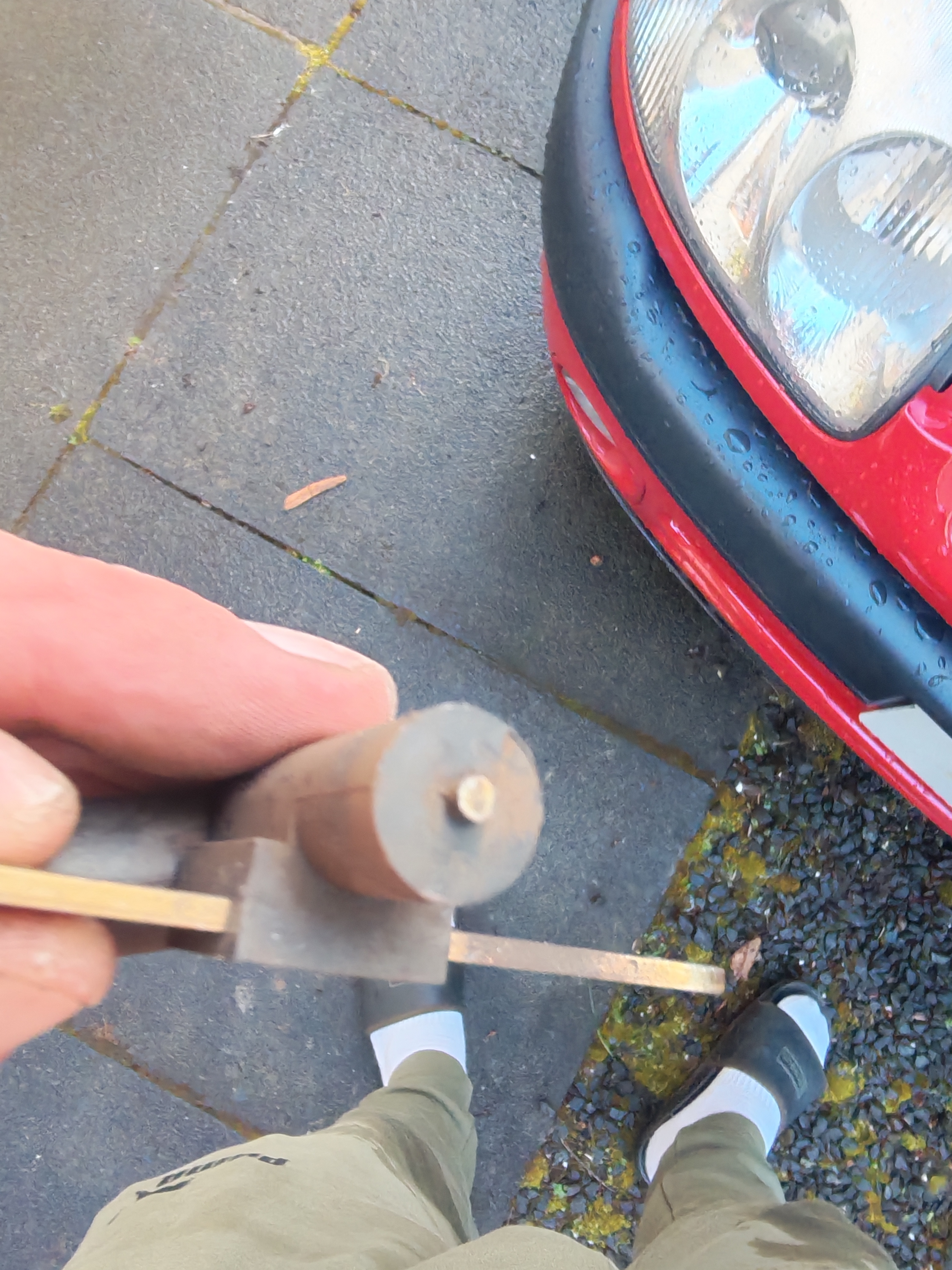

I don't see why it wouldn't. I have a feeling this is also on a Megane. Believe the in thing is a Skoda splitter, recall doing that back in the day.

Great, it's too bad Skodas were never sold in my country, I'd prefer not to import it... Hmm, I wonder if I could 3D print a splitter, sure it wouldn't be rubber, but it would allow me to shape it however I want🤔

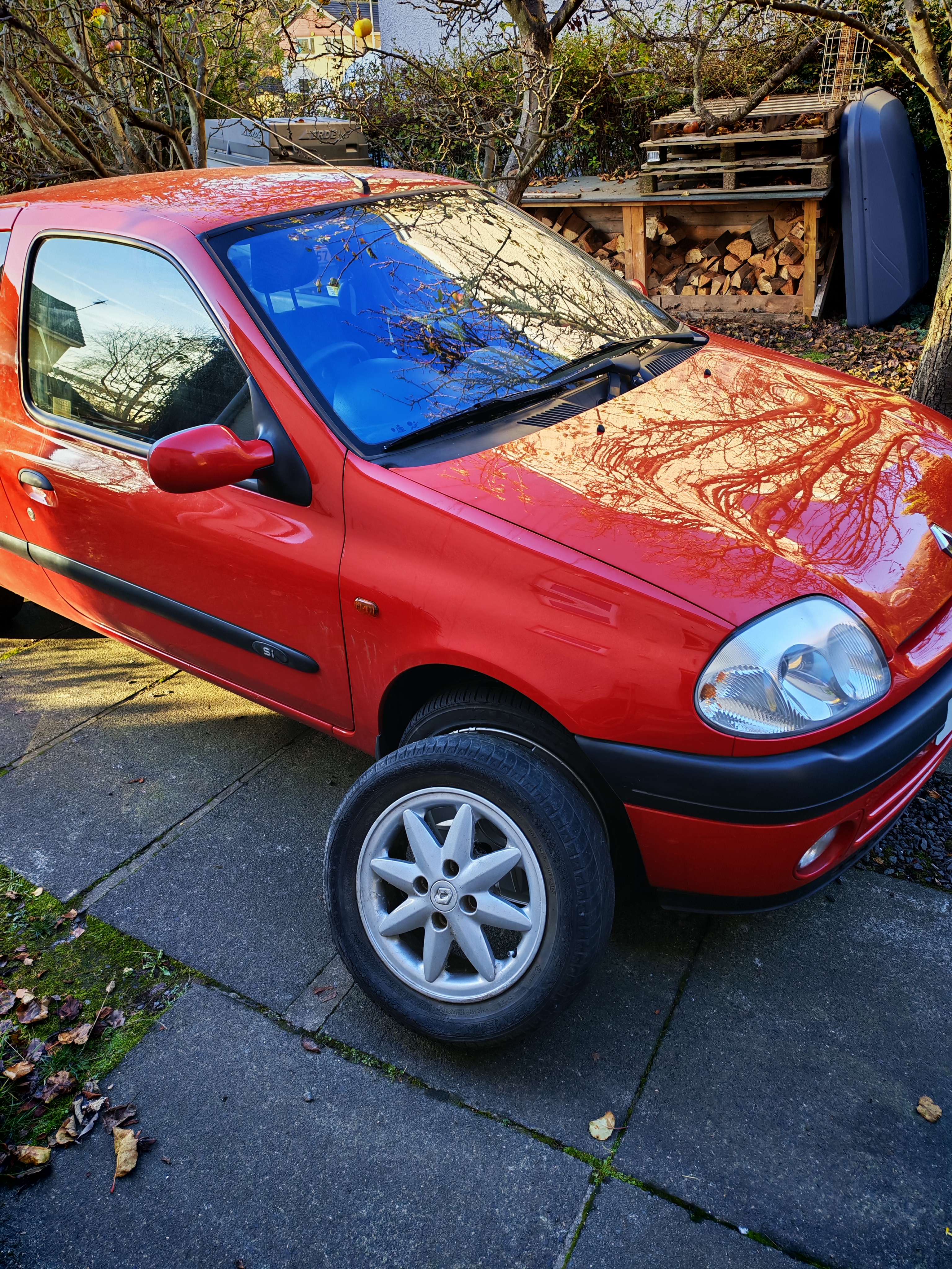

40mm drop on these non-Sports is a godsend! Here's what mine looked like:

Thats the springs i run on my RSI,

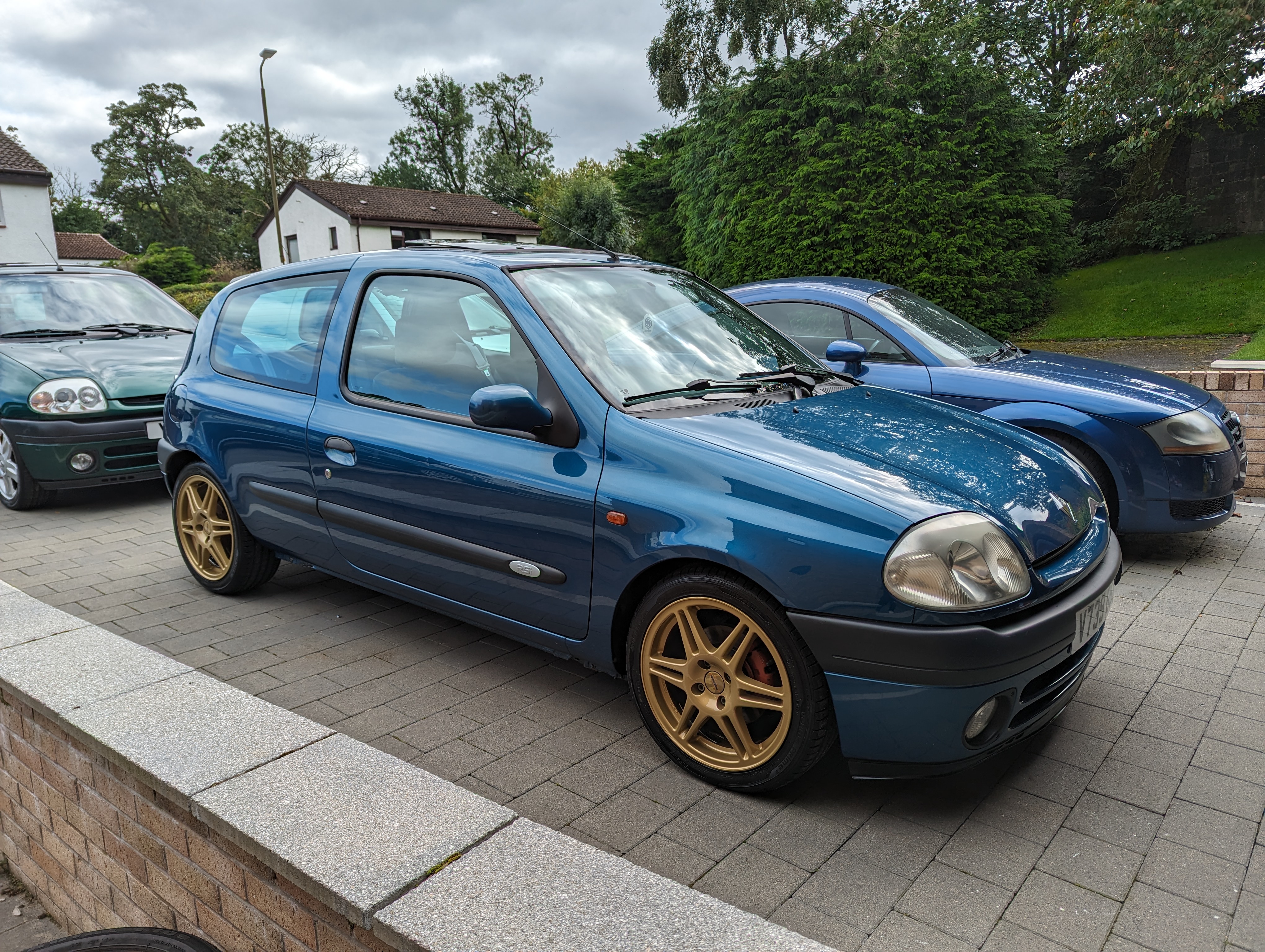

16s:
15s:
They are strangely really comfortable! i think the ride is better than it was standard!, doesnt handle great right enough :ROFLMAO:

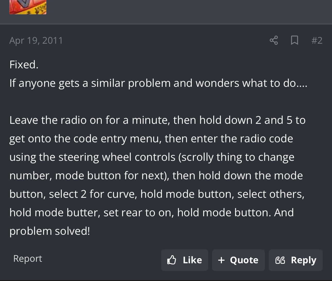

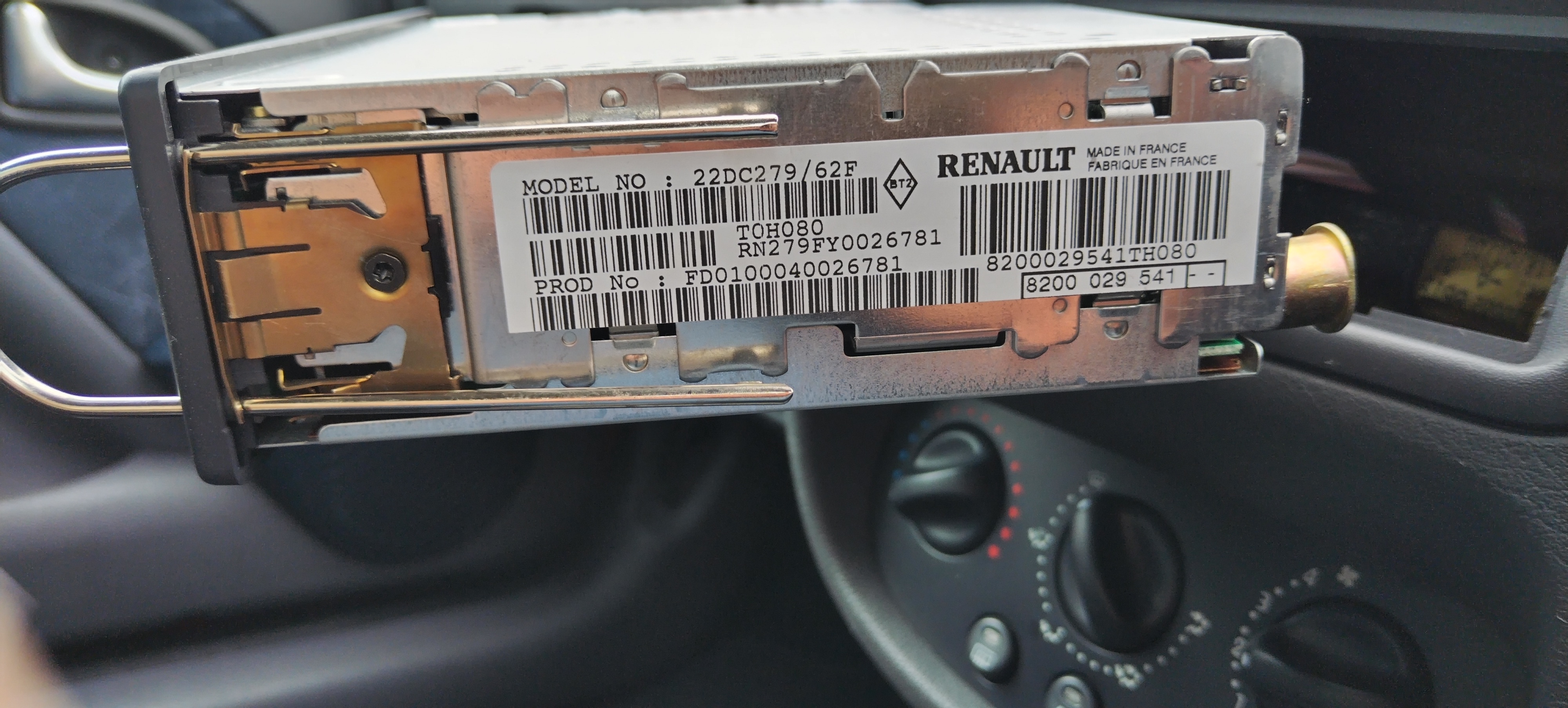

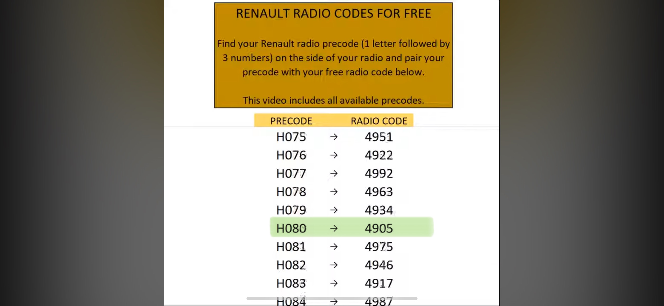

Can anybody help get a radio code please?

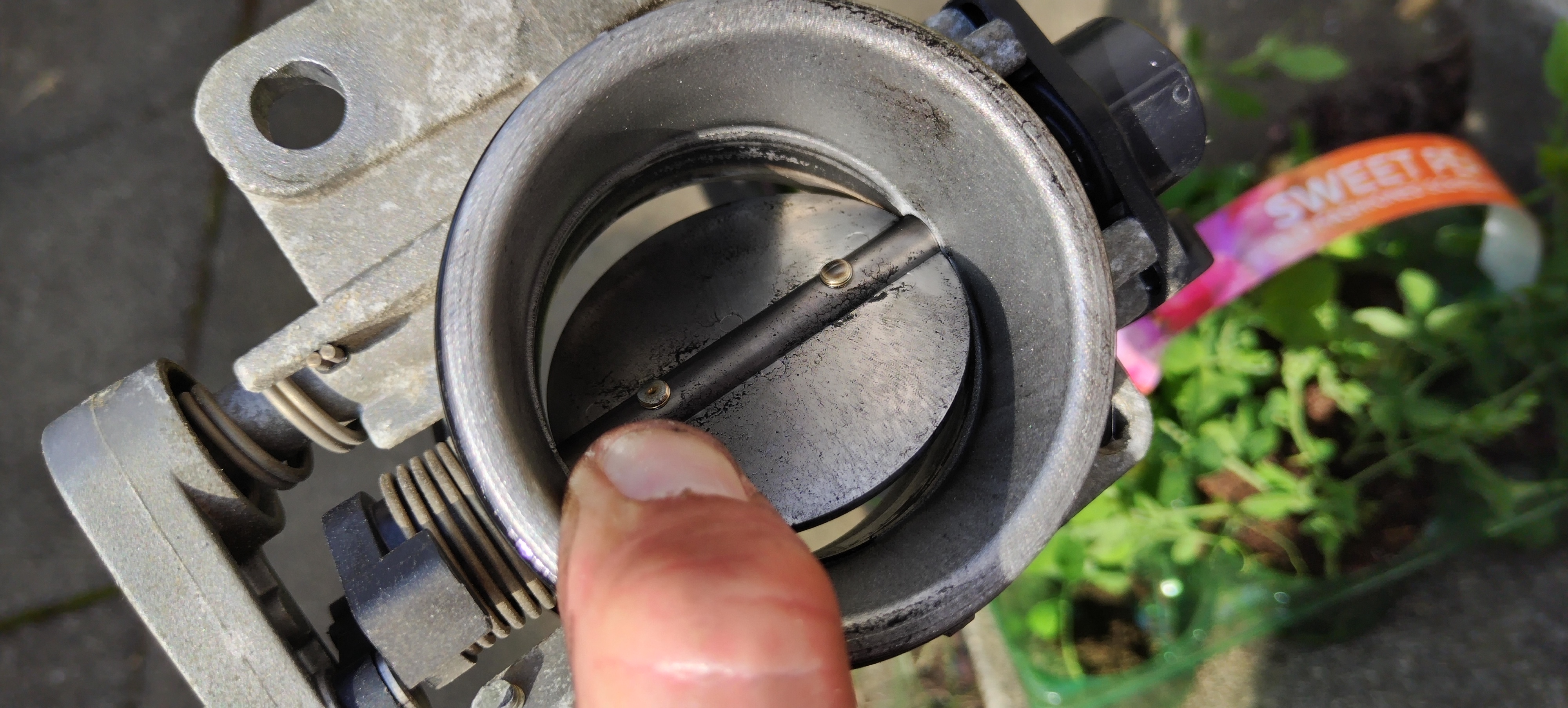

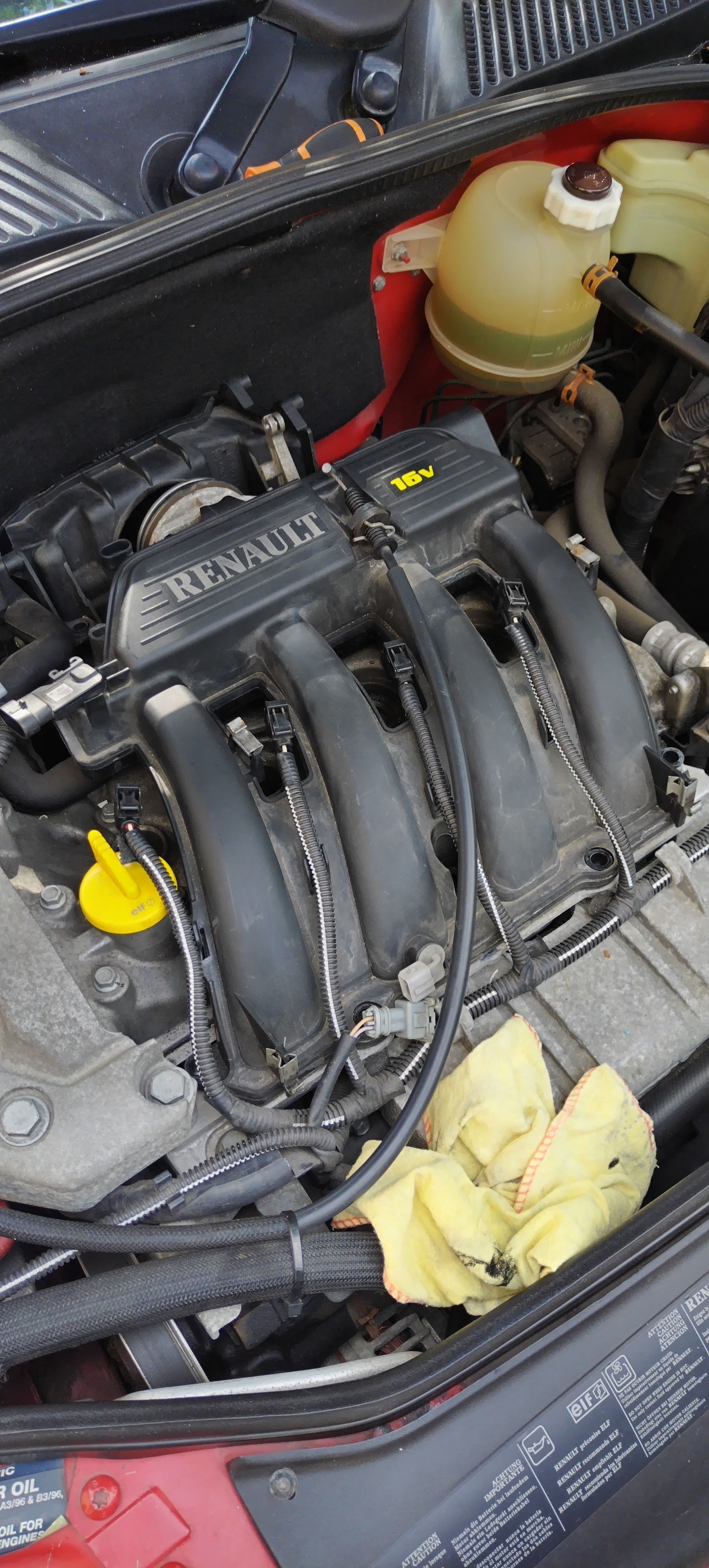

How on earth do I get the cylinder head cover removed, it moves as all bolts as far as I can see are out but it's just not coming away from the throttle body which is what I want to check.
Hi mate,
Have you thought about putting some phase 2 rear lights on it? I reckon they'd look nice :)
I think I must be in the minority but I like the old school look of the Ph1 rear lights.
Managed to get it off. Was being impatient. Guessing this doesn't look bad?
It has cut out on me a few times recently. Starts fine when under any pressure, slight hill it judders/struggles for power then cuts out. Starting then means keeping the revs up. Not ideal!
Not having much luck here. All back together but now revs are staying high once the throttle is blipped it's starts revving up and down. What have I done!?

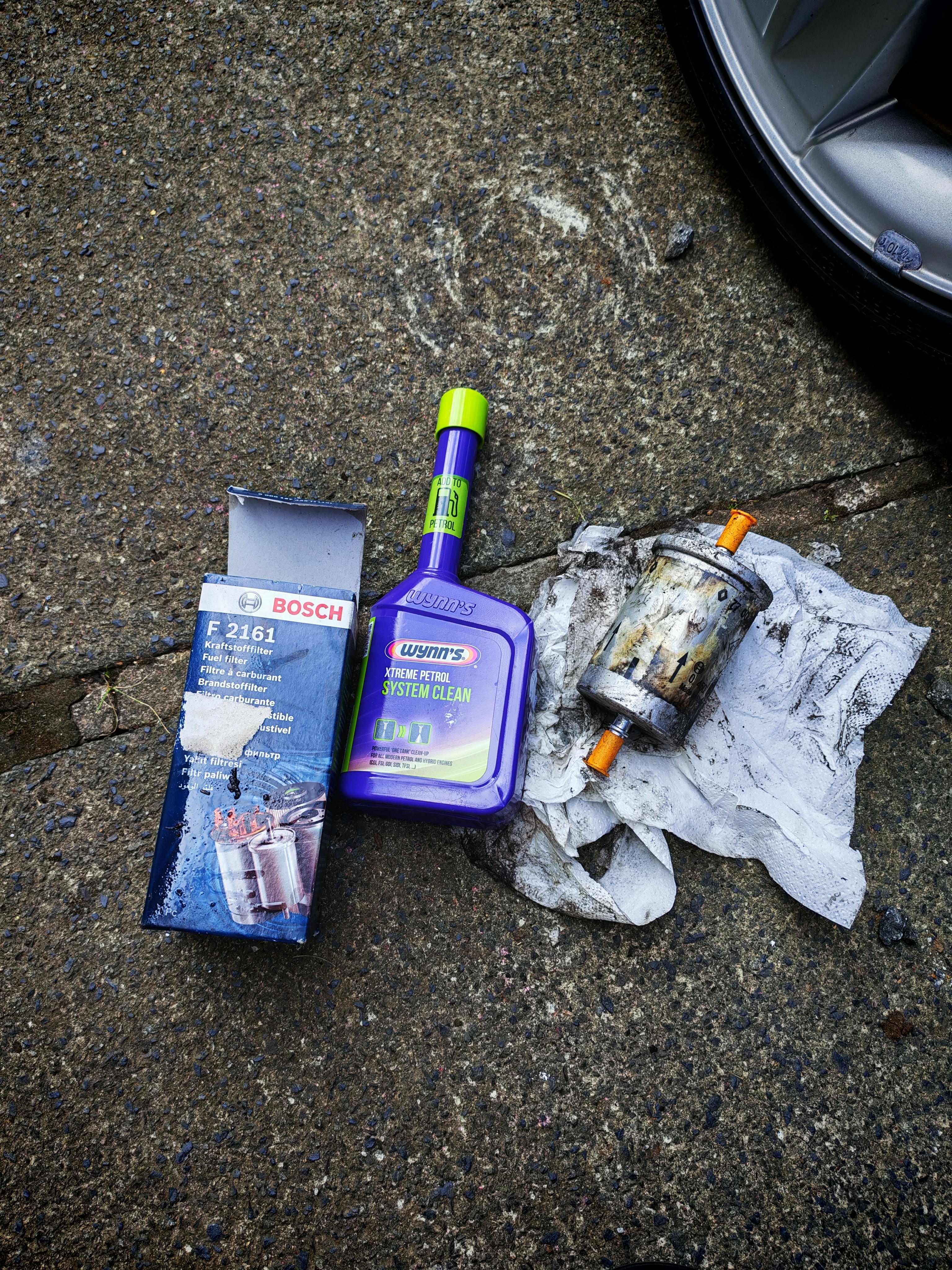

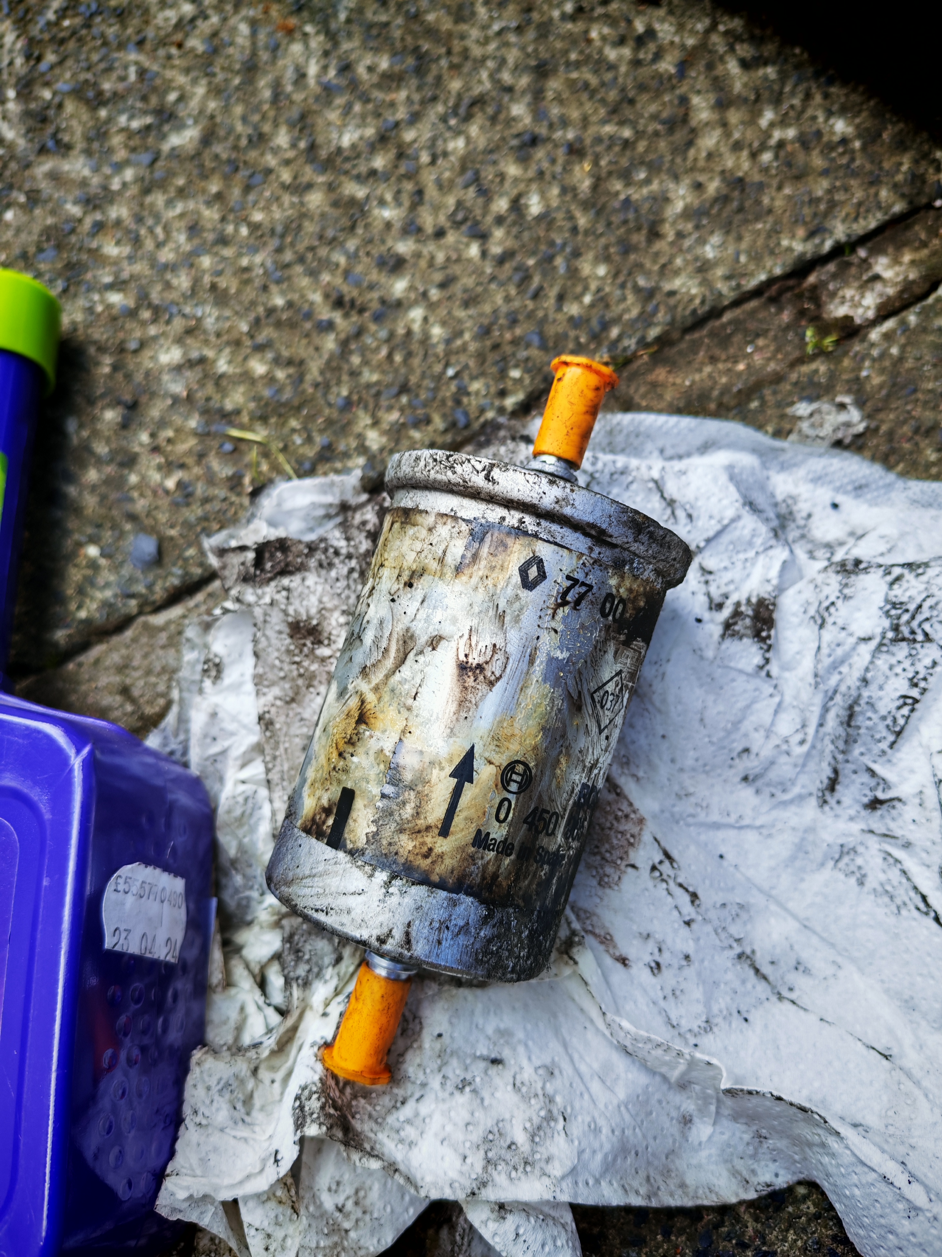

I had similar issues again with staring. Heavy revs, bang on 2k then cuts out and again once fuel got low also noticed any incline it was not happy. I today changed the fuel filter then put some fuel cleaner in. Struggled for a while but did start and seemed okay. Got along to the petrol station as only put 5litres in. Time will tell once fuel gets low.
Big thanks @Martin_172 for keeping me right.
One above is the old one. New one is a plastic Bosch. Couldn't see a date on the old one but looks to be a genuine Renault part.
Wouldn't be surprised if that's the original! I was fairly certain mine was too!
Here is hoping that's maybe solved it. I didn't have a wet vac 😅 otherwise I'd have bought the tool for the fuel tank. Maybe next step. I may hack the old filter up and see if it shows much.

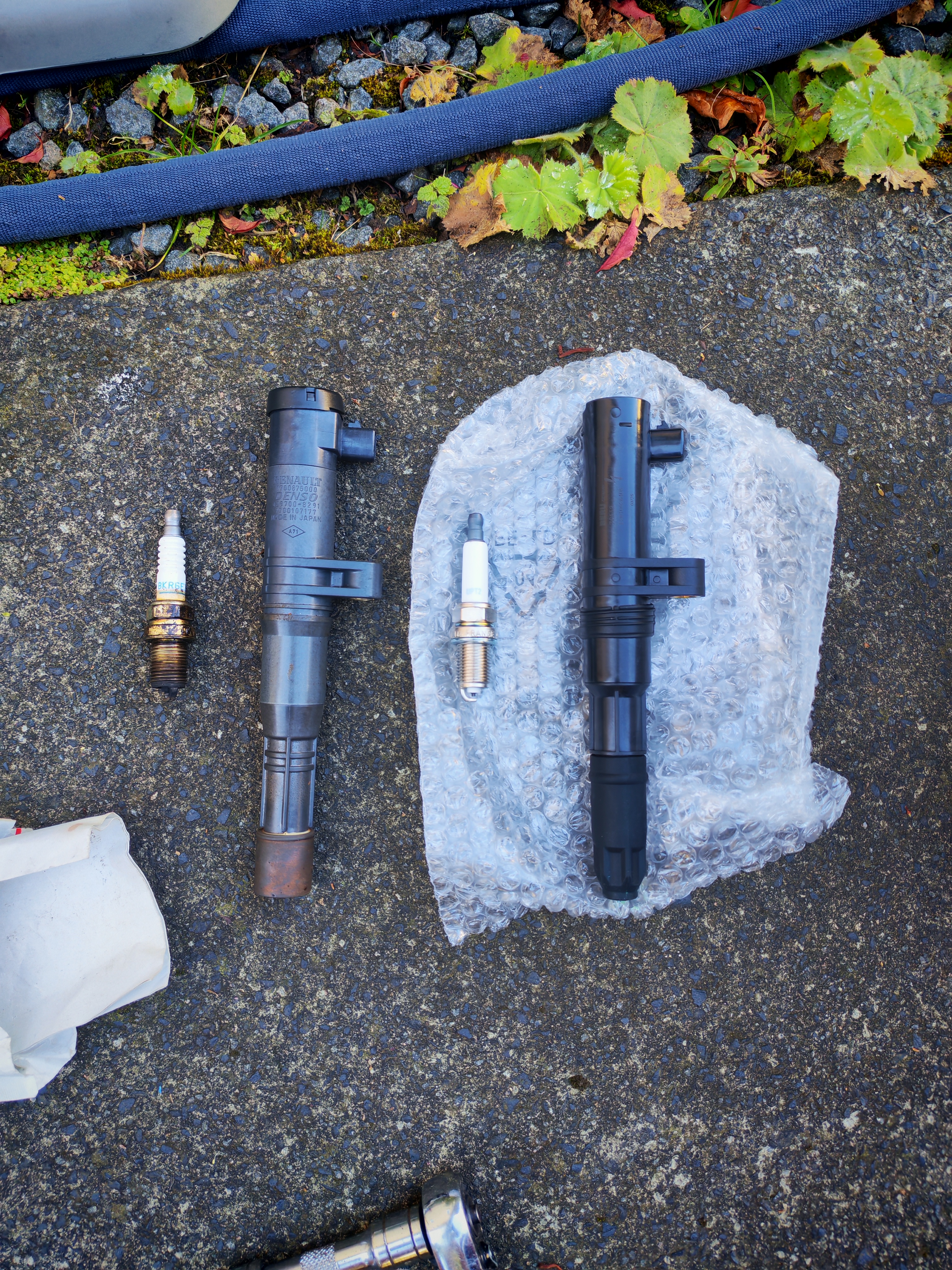

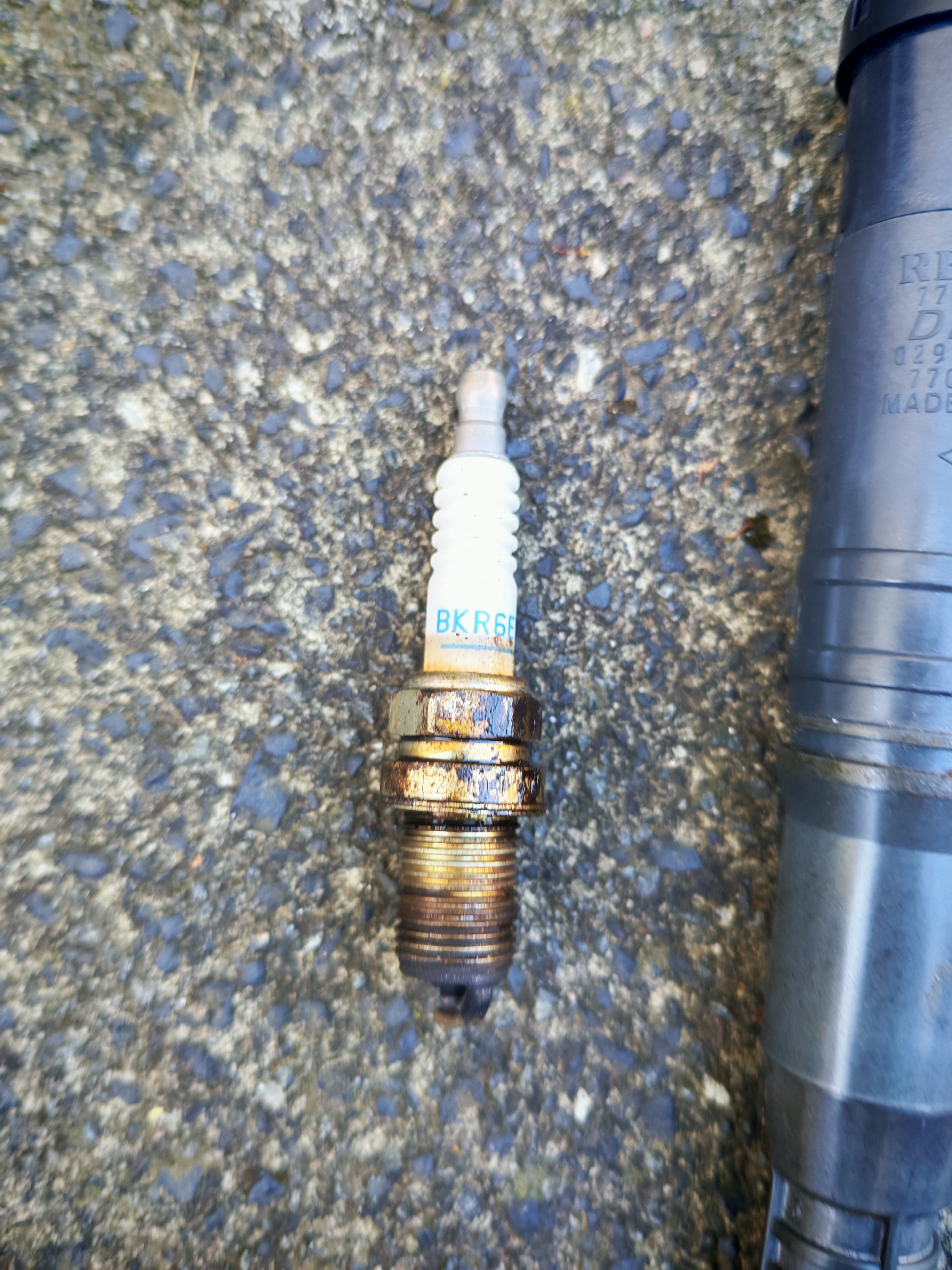

I have changed the fuel filter and this morning the spark plugs and all ignition coils. Unfortunately same issue. Switched it off left it a while then it started fine. Very strange and annoying.

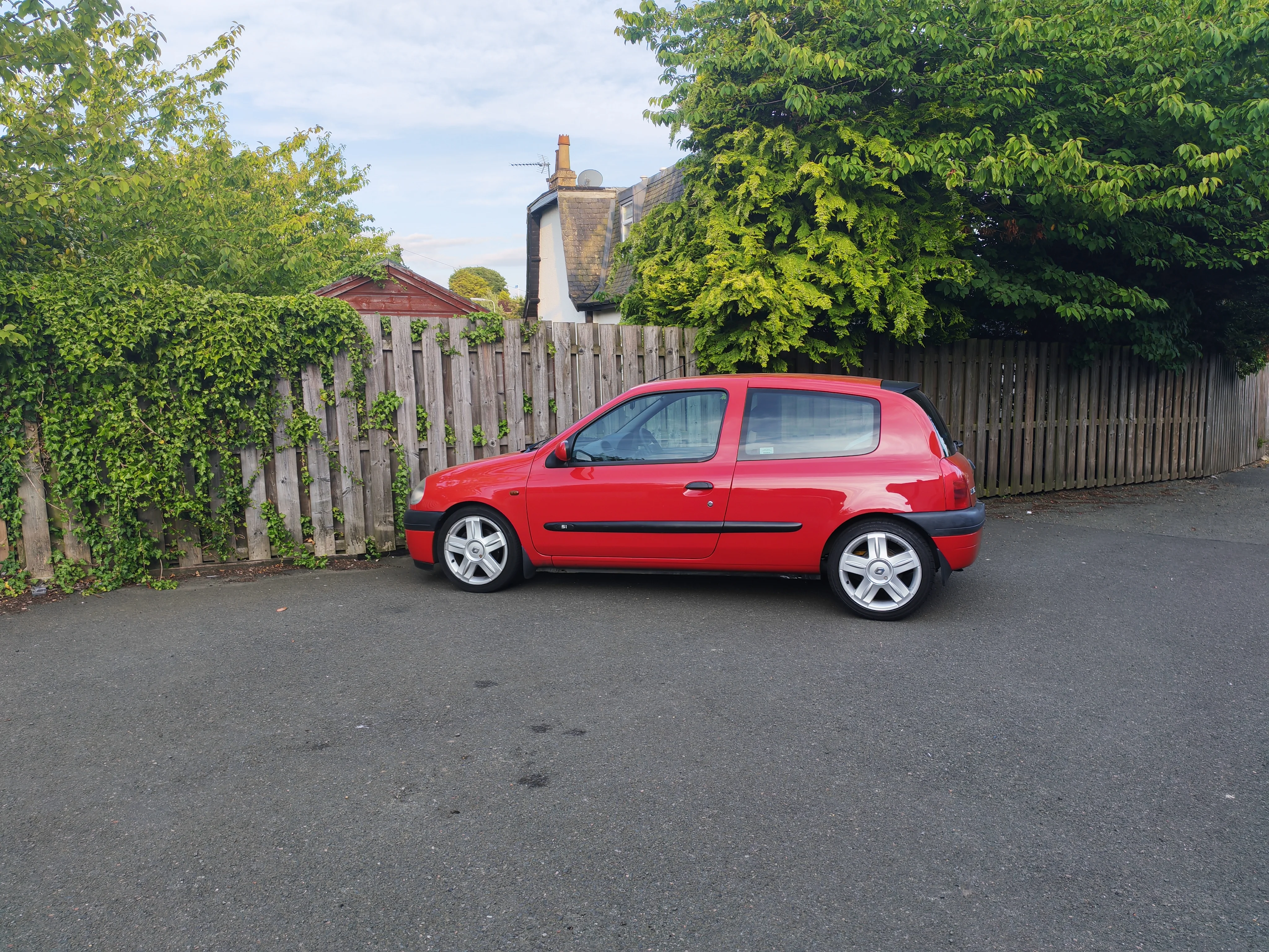

I left the car outside Haws Inn on Friday night so was picking it up. It again didn't start so probably looked in a foul mood 😅
bummer, was hoping a dodgy coil was the culprit! I've never known a crank sensor to cause one to idle high, just randomly cut out or struggle to start, possibly worth a go since they are cheap!
If not that thinking either a air leak or crap in the fuel tank. Just odd it works absolutely fine sometimes which wouldn't maybe make sense with the two above.

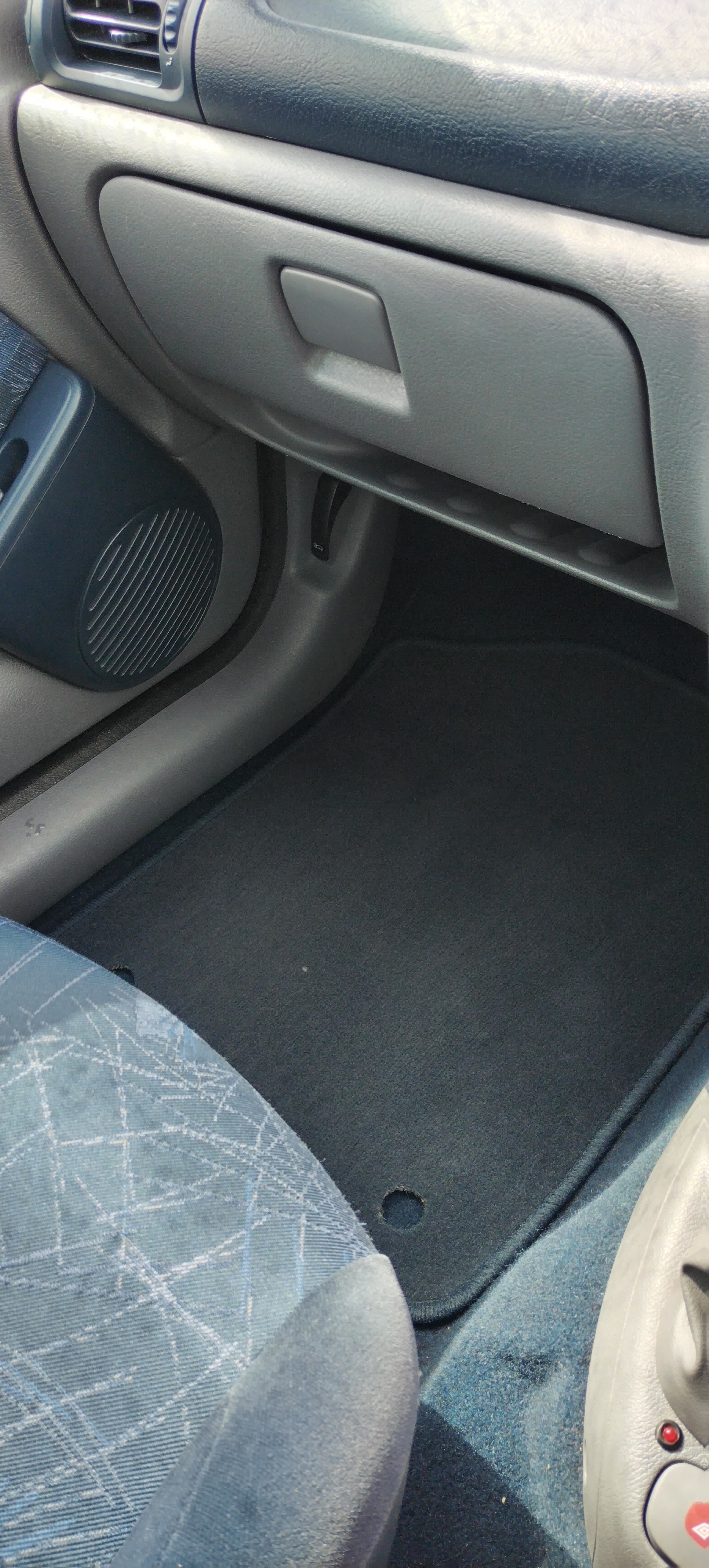

Stuck some rubber mats in today, christ they are cheap. £12 cheap from Argos but the original mats were staring to look worn then got a hoover and tried some ACF-50 in areas for rust prevention.

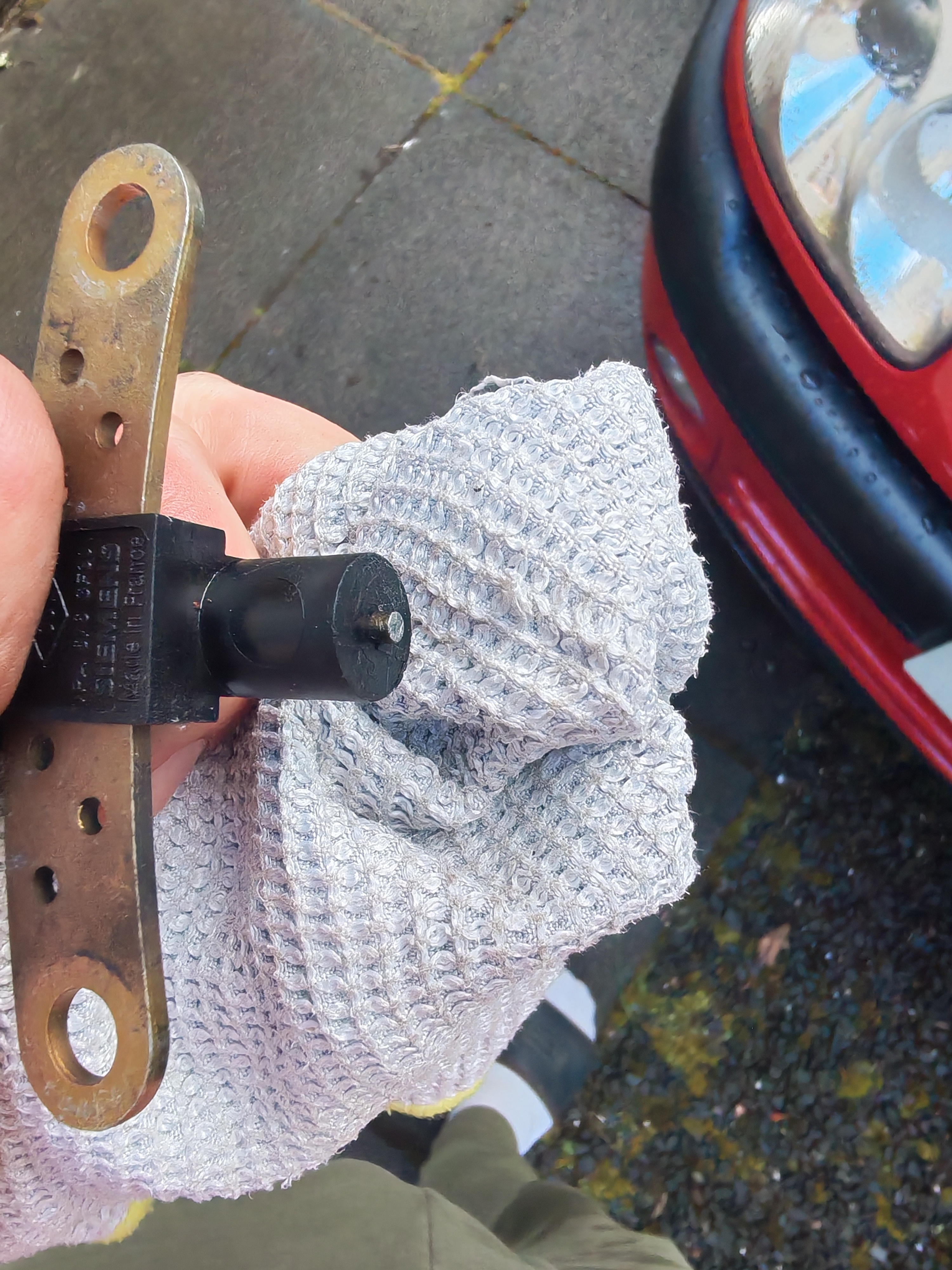

Little Clio has been grand MOT in August it was at 23,700 as of today its at around 27,500. Hasn't been any issues. Until today. Went out and it just wasn't firing. I assumed it was fuel related again as only stuck a half tank in whereas I've always put in full. Probably makes little sense as I would run it low then go full.
Anyway it ended up being the crankshaft sensor gave it a clean and it fired up. Nice, simple fix. Happy days.

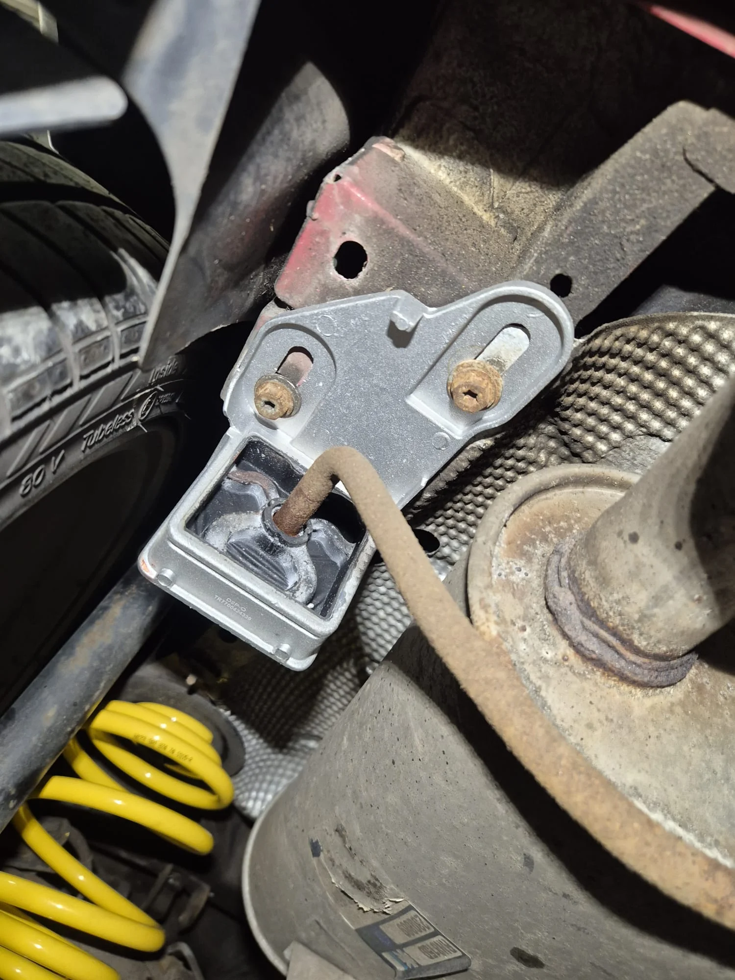

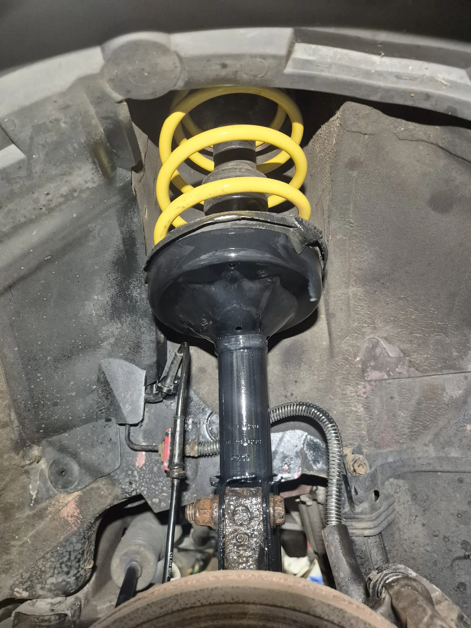

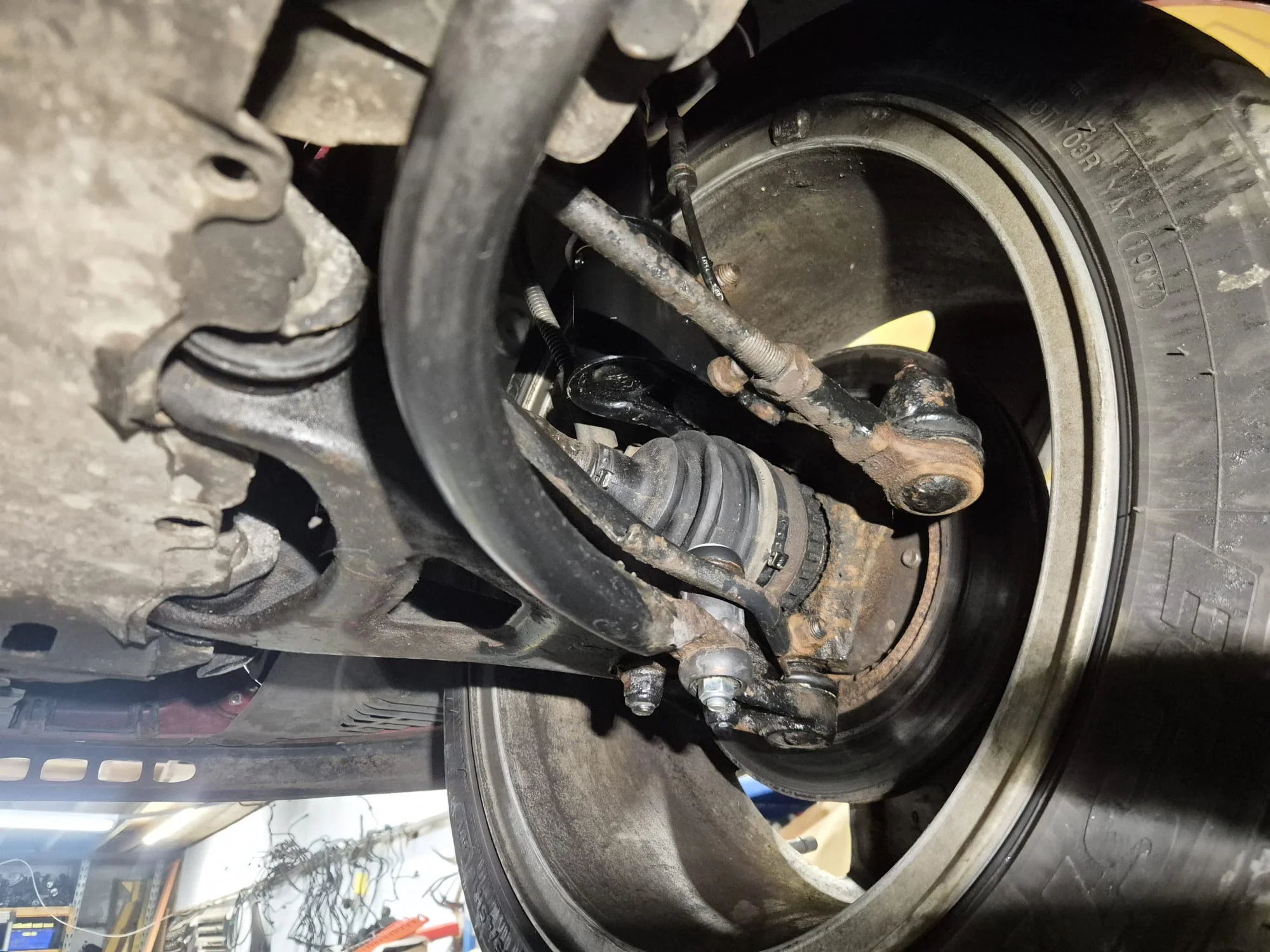

The car was well overdue a oil change having not even known when the last one was done. It was also making a noise going round tight corners and I assumed it was a spring. The worked carried was
Oil change +filter
2x front shock absorbers (one leaking)
2x arb outers front. (one gone)
Rear exhaust hanger
2 front locking wheel nuts removed. Who the hell designed these!
Check over
Lowering springs fitted 😁
I keep cracking up looking at it as it's looks the business but I thought my lowering days were done. Clearly not!
Car feels better just in general. Really impressed with Renomotive 100% knows his stuff and a true enthusiast for these little cars that we all love. Real credit to the community.
