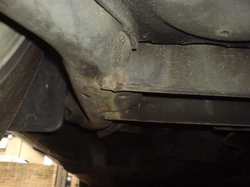

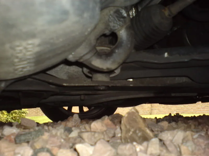

Right never bothered using these before but i rents got me a set so what i want to know is where to place them on the underside of a Mk3 as i havent got a clue at all and dont exactly want to guess and end up with a stand through my floor.
Couple of pics of the under side and where im asuming you could place a stnad....so good idea bad idea ??

Do Mk3s have two chassis legs running back from the front like a Mk2? Thats always a good place to stand the front on them, rear you can go either the rear beam or jack the beam and stands on the sills if you need to drop the axle etc.

Unsure about the Legs running to the rear mate are there on near the sills or further under the body ??
As for the rear in the pic the Round Tubing fixed to the rear beam alright for a stand as the rear beam itself is to wide to sit properly in on the stand

Ill go have a look in a bit, as for the rears would it be ok to rest the Tubular support on the stand ??

The chassis legs should be about 10 inches or so behind the sills.

i'll vouch for that too. use the front subframe, where it mounts to the body at the back where the axle joins the body if you can. the rear beam isn't the best place as it's used as a anti rollbar and is designed to twist(the antirollbar is inside it)

I still don't get how people jack up the mk2 then put axle stands under
DrR
  VW Golf GTD
But you can't as the jack is on the bit where you'd put the axle stands!
DrR
  VW Golf GTD
so thats where they go! That bits always looked weak to me.
been fine the many times my cars have been in the air. Damages the underseal though if your not careful.
  BMW M135i
Just get a tin of it and put some more on if your bothered about rubbing it off, theres no way you won't rub some off using stands there. I just smudge some more back on after, halfraulds do a big tin of it for about £3.
