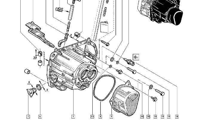

Thats the diagram and yes the drain plug doesnt seem to be there.
At least it wasn't the guy being incompetent.
But what is number 1(?) on the diagram? Can't quite see the number but it's the number between 6 and 13 and the bottom. It just points to the underside of the gear box - is it the gear box casing or plug?

The Renault diagram for the drain plug etc is probably on another image with the linkage and so on, but sounds like your sorted now RE: washer :smile:
