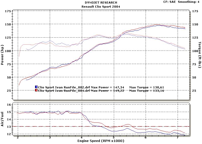

On the graph the car is noticebly leaner (higher number on the AFR graph) with the aftermarket filter but it barely affects the power readout.
I have been told peak power is 12.9 AFR so the car looks a bit rich with the standard filter?

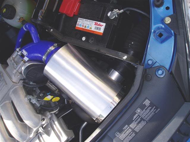

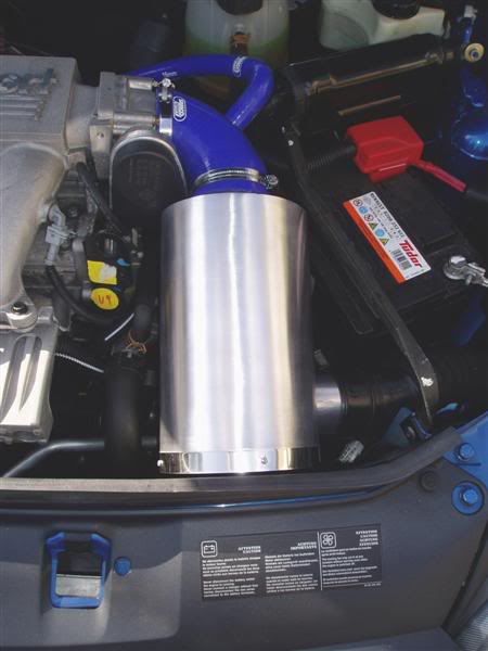

There are the pics of my k+n cone filter in the custom airbox i made . The end near the elbow isn't enclosed in the pic but when i get round to it it will be . Its running both the orginal air feeds , one hidden underneath which i might replace with a slightly larger diameter pipe . And the acoustic valve is still in place as well .
Like i said before the apollo having a smaller surface air seemed to loose power and the 5k kick was almost gone . With the cone filter it pulls as hard as with the original panel filter , if not slightly harded .
I don't have any pics of the ends sorry , but they are finished of in the same aluminium .
