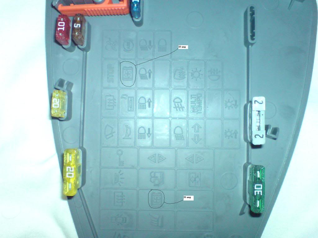

What fuse should be used or my fan in the end of dash fuse box?? (i.e 15a 20a) I asked a local motor factor and not a clue....
I ask this after wondering why my fan has not been kicking in for the two years i have owned the car.... was rather funny when i was changing a reverse light fuse and noticed there was a metal fuse connection with no fuse in the box so checked what it was and hey presto! Not quite sure how the car has managed to not over heat tbh!

If no one has got back to you by the time I get in tonight then I will have a look and let you know mate
Ello mate
Took a pic of the diagram as there is 2 fan symbols as seen below
Top one which is next to the STOP and ABS symbols is 10 amp (Small size)
Bottom one which is next to the heated window and heated seats symbols is 20 amp (Bigger size)
Hope that helps mate
