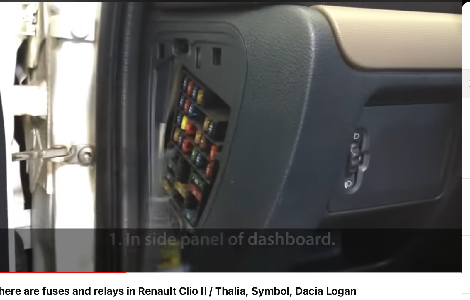

While not having a wiring diagram I did not know what fuse to check, but checked every fuse under the bonnet and every fuse in left side under dash - all OK.

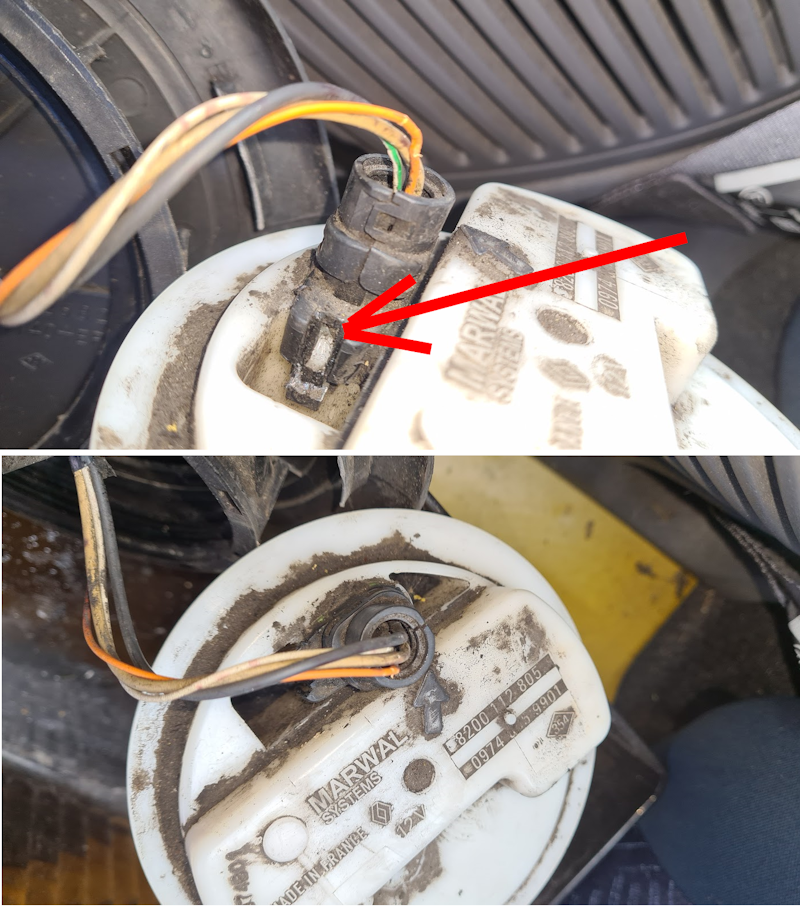

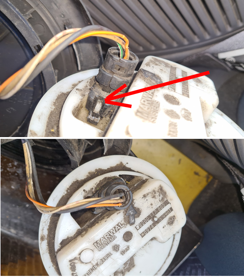

One other query. How do I get the connector off the pump. I assume I should press the metal strip on the side but it will not move. I have been reluctant to apply too much pressure where I should not.

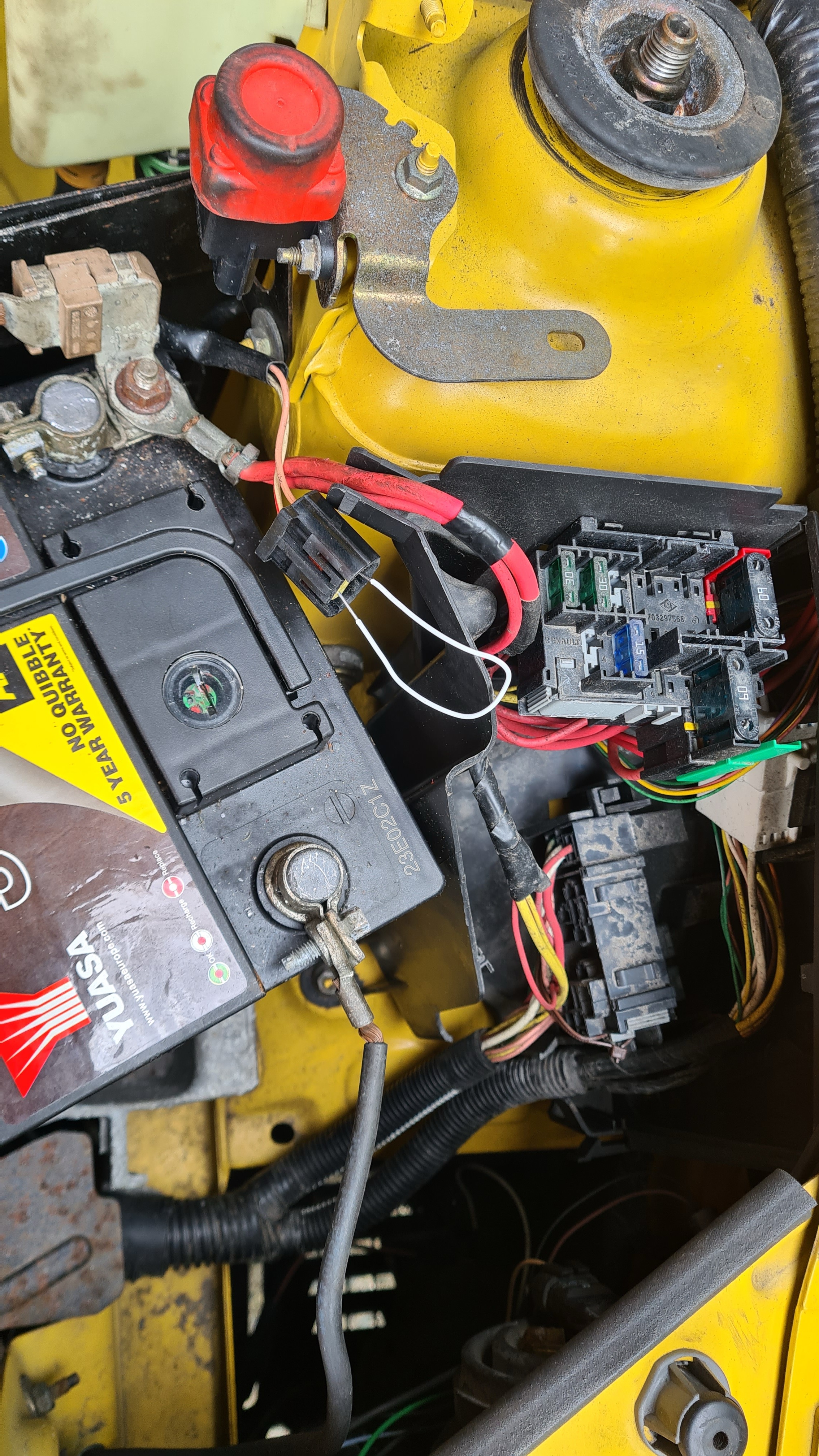

Is the cut off safety switch OK ?
~ 1" button near the battery on the ph1s.
Press that - might solve your problem.... worth a go anyway.

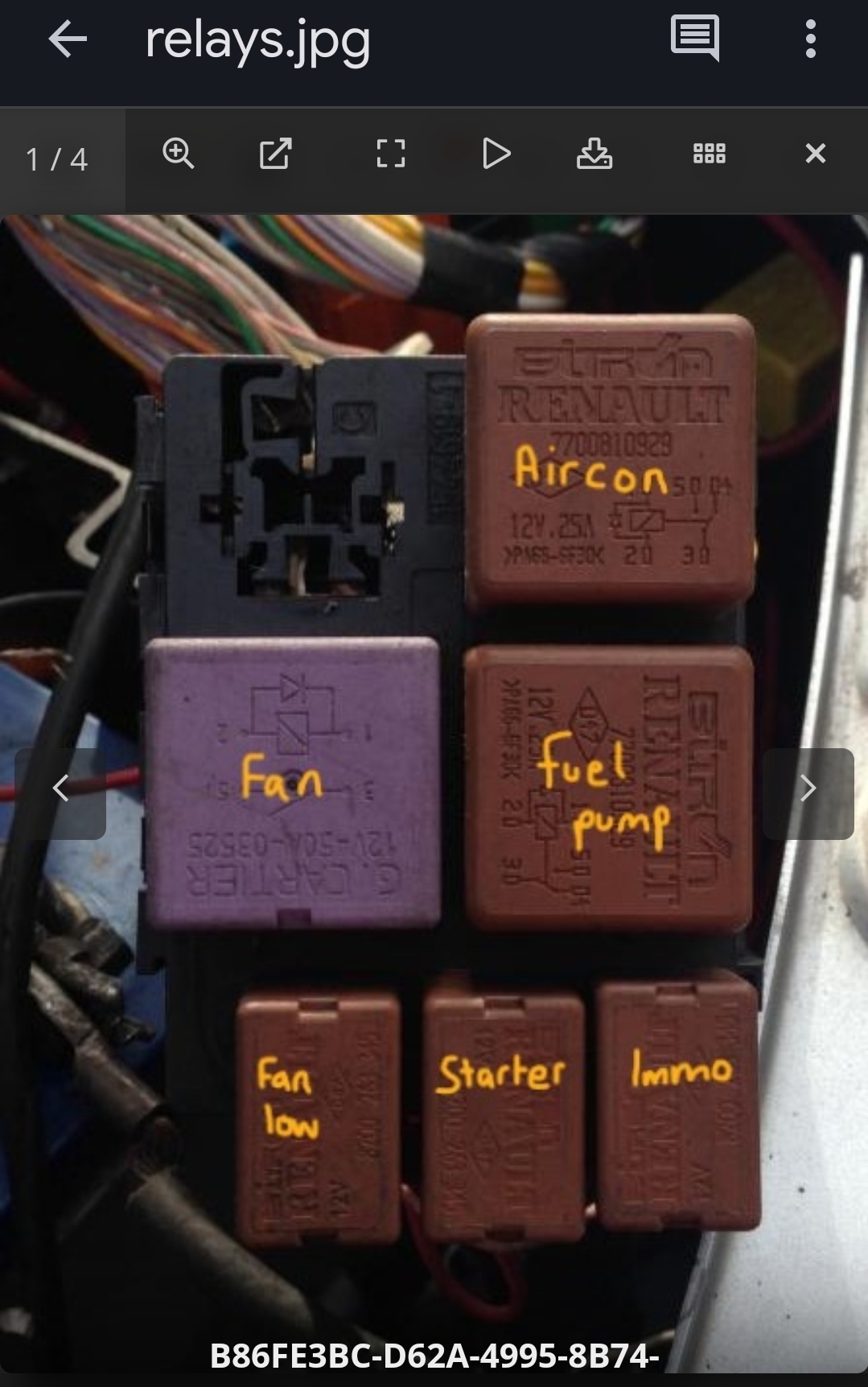

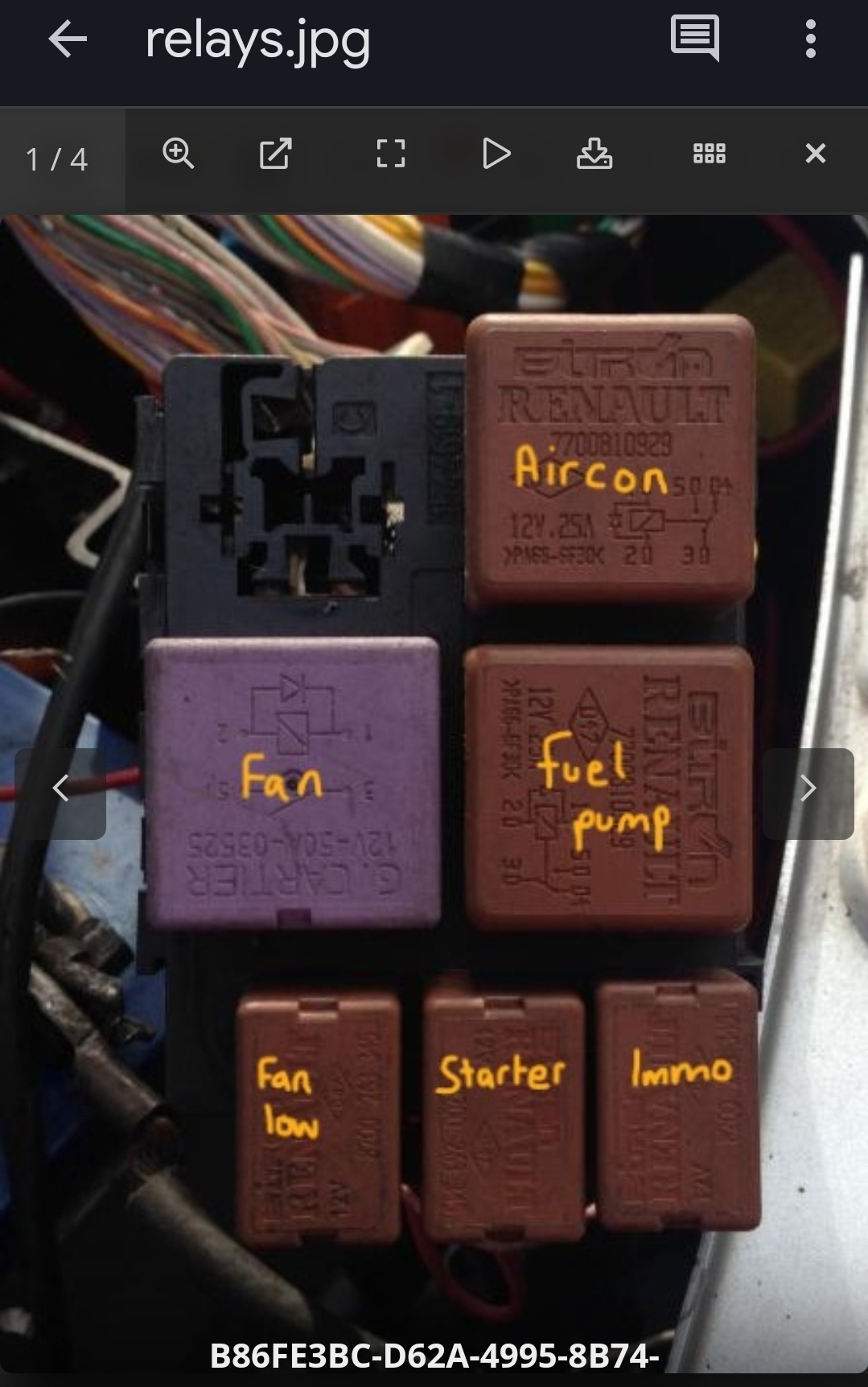

Try swapping the relay in front of the fuse box under the bonnet.
Swap the one marked aricon and fuel over it maybe bad relay. Had exactly same on my one

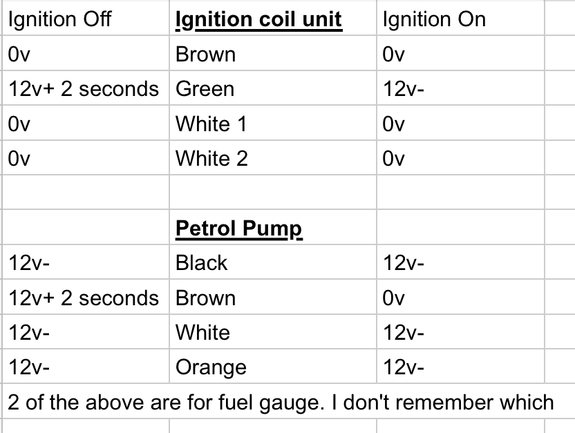

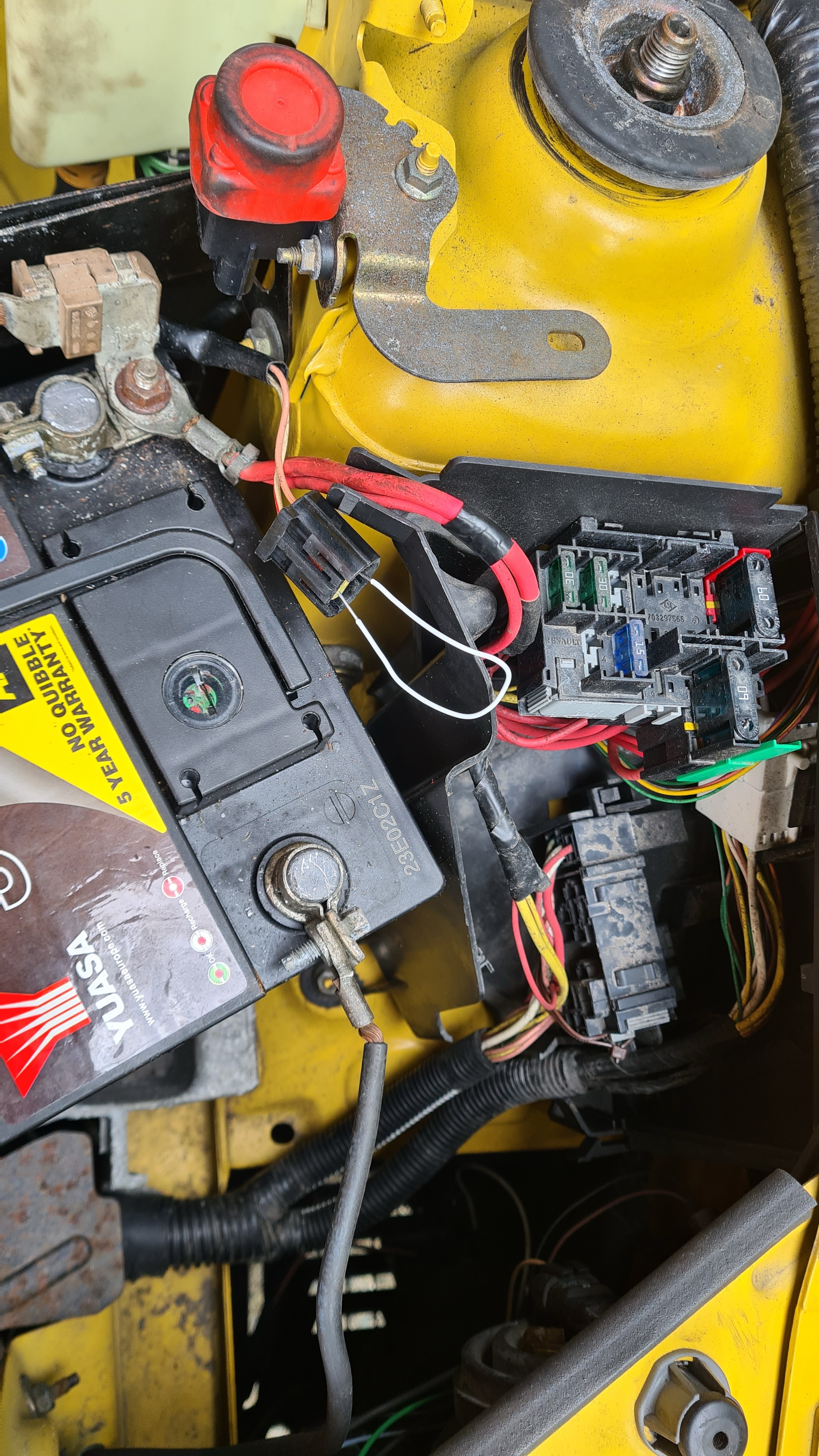

The key diagnostic is when ignition is turned on the coil unit and fuel pump get 12v+ for about 2 seconds, then 0v.
See image of test of all cables at coil unit and fuel pump.
The issue is not (I believe the red crash button). I have both pressed it and bypassed it. See photo.

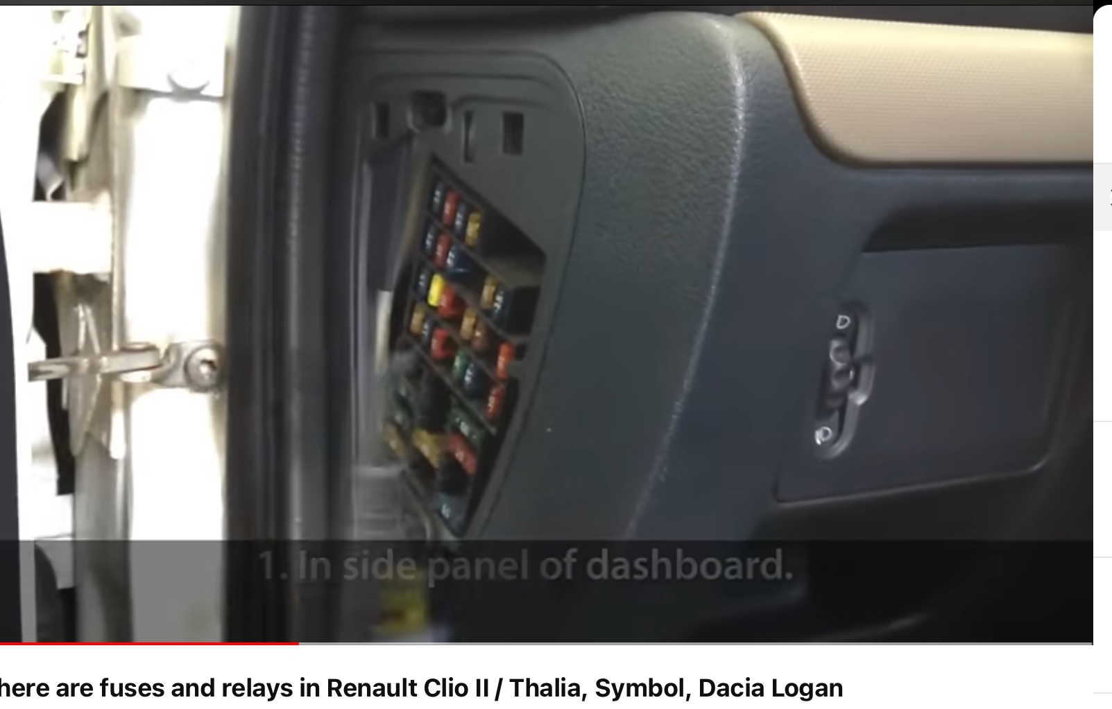

On first day of the problem I checked all fuses under the bonnet and to left of glove box (see image). All were OK

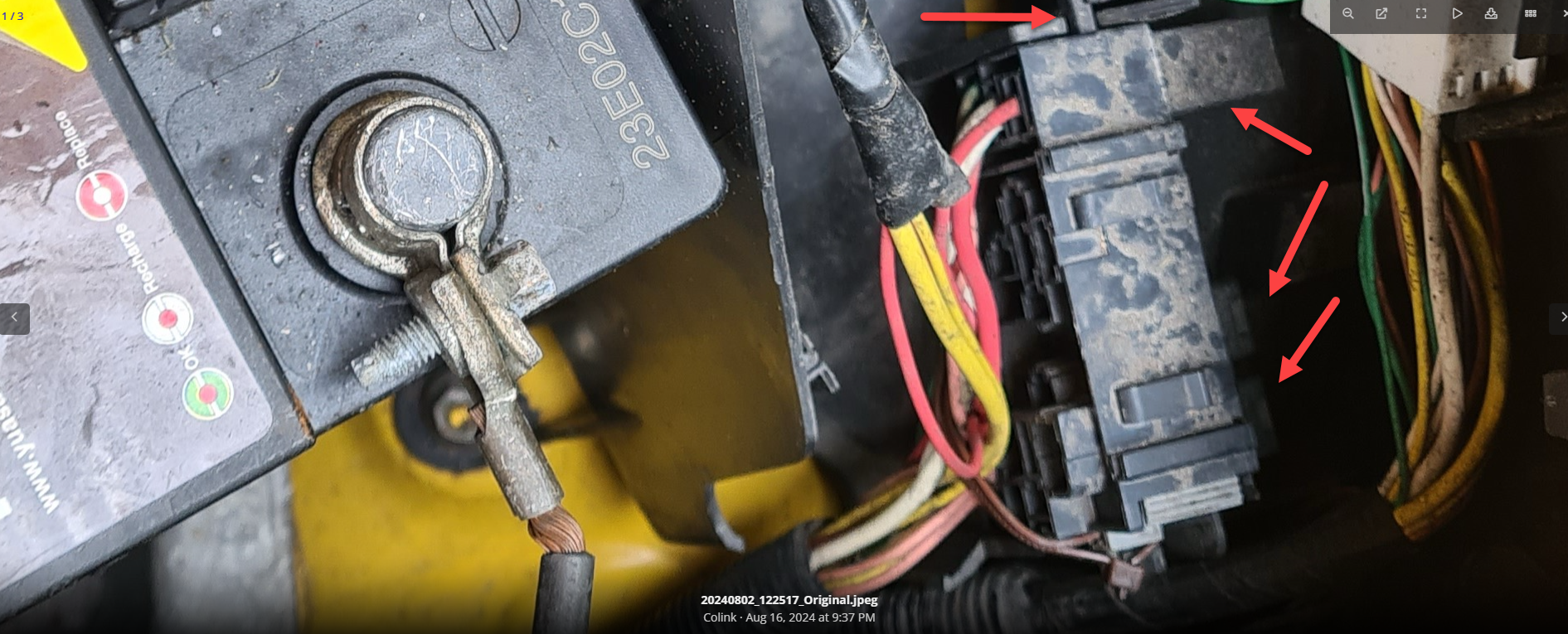

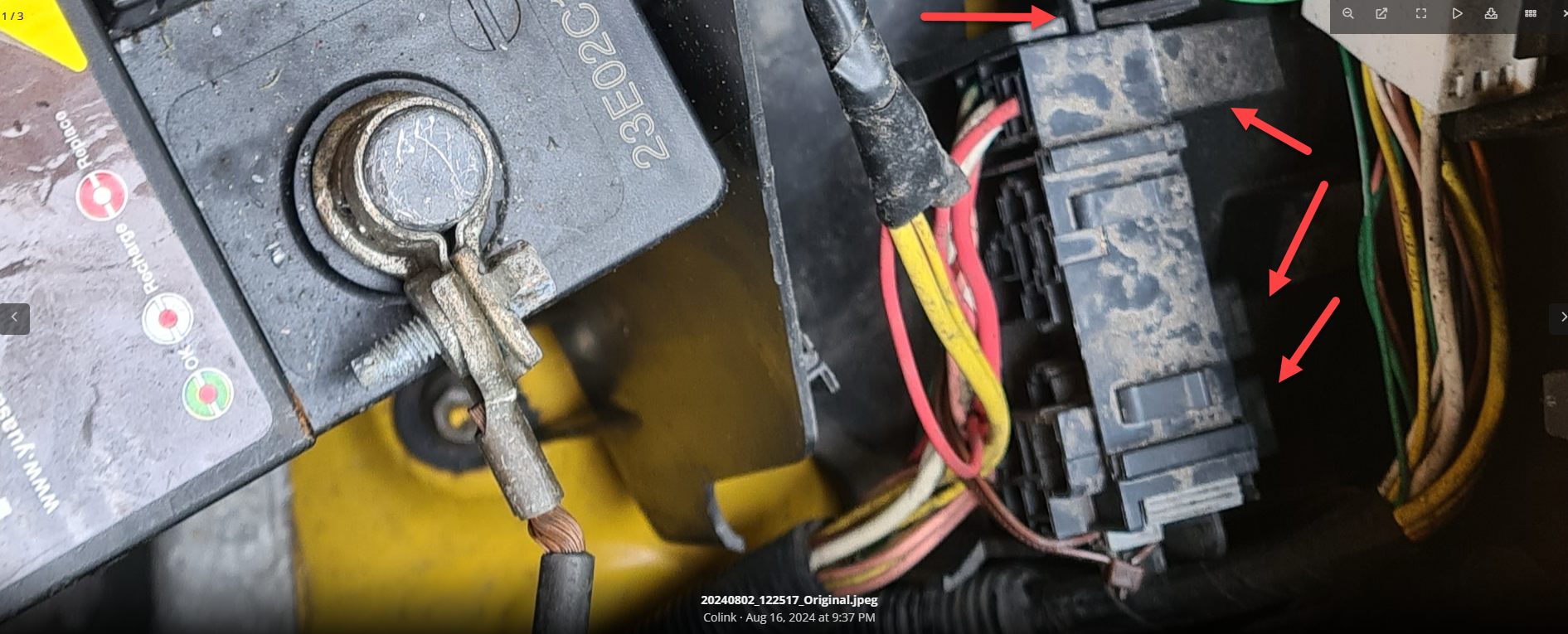

Hi @Colink
You are in the right place for the relays see your pic below I have marked it up red arrows, they are sat on a vertical holder that clips out, Mk2 Ph1 do have them there as I have an early one and sure both early and late version both had relays down there (alu bonnet and non alu bonnet)
Hi @Colink
You are absolutely correct. I was looking for full sized relays. Thanks - see my update below.

I switched positions of the three relays beside the battery

I have power to the fuel pump when cranking but no fuel coming from pump.
I assume I have a faulty pump, unless someone has some other suggestion.
It seems that it is the same pump for Clio petrol from 2001 to 2020 - am I correct?
Numbers on the pump: 8200 112 805 0974 665 9901
