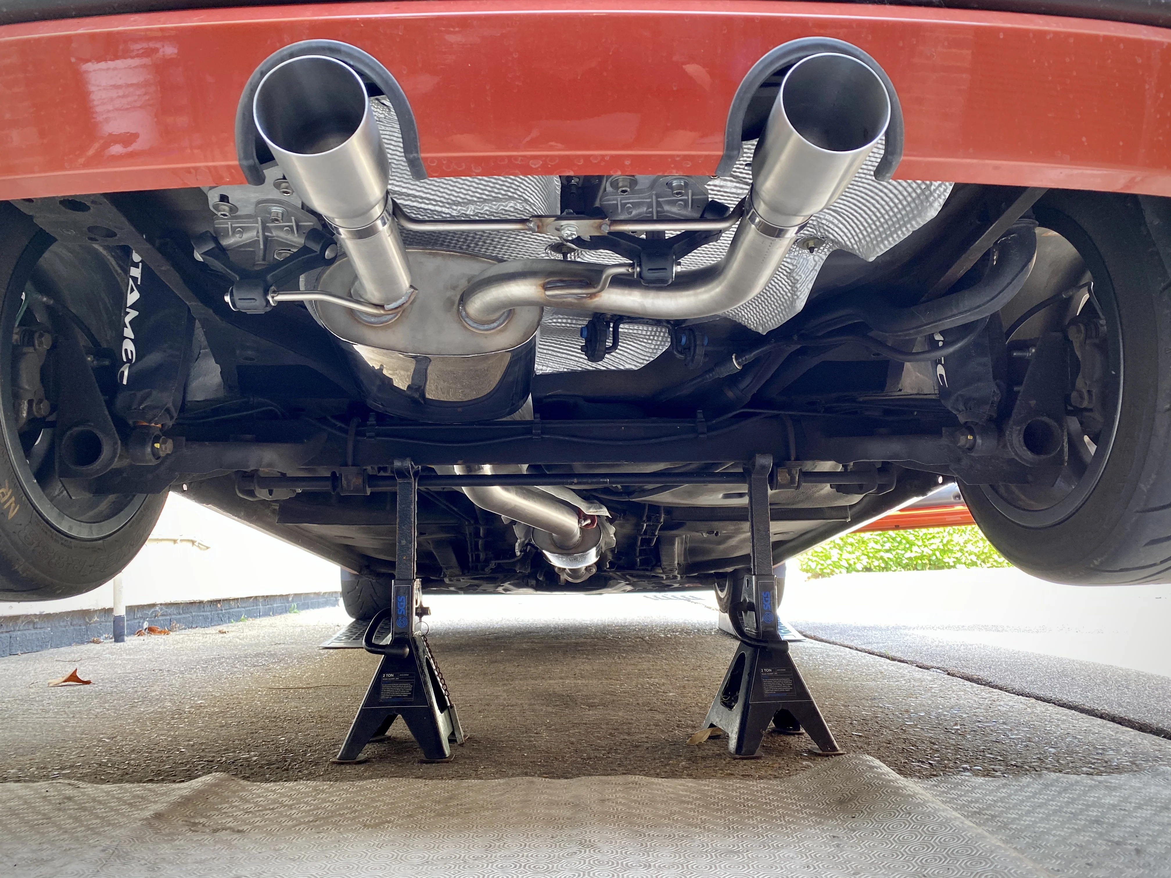

Had mine on a while now. Nick had it made with custom straight cut brushed tips. Sounds the best if any I’ve heard and fit/quality for the money is the best you’ll find.
I’ve got the cat derestriction kit for MOT time but runs a full decat the rest of the time.
