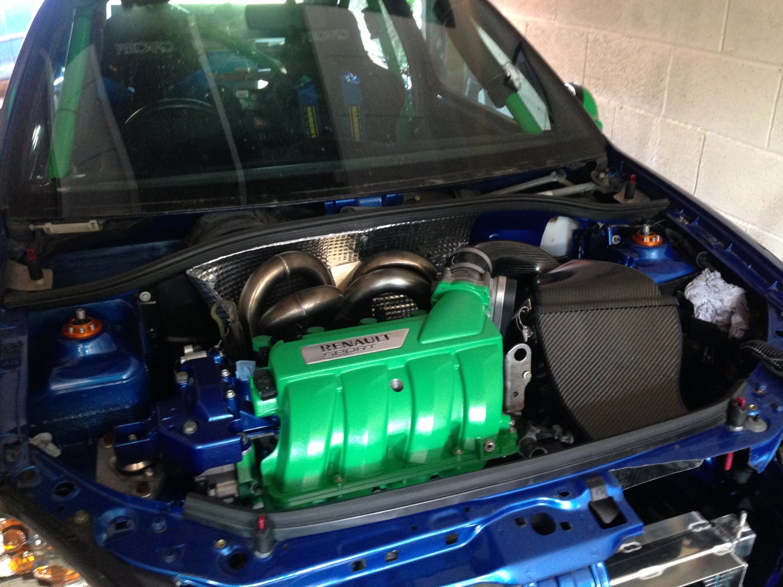

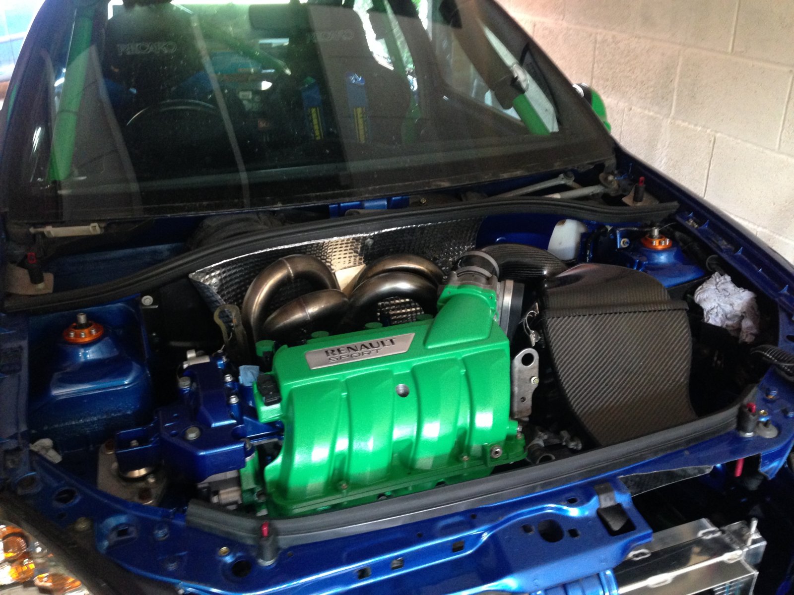

Any benefit from running the 197 inlet and how much work was it to do so?
You need to combine it with a lot of other expensive stuff to see the true benefits. Fitting it requires the use of a 197 head as well, and this needs a small amount of work to suit the 1*2 block.
That engine build in my pic made 230hp. Combine the right bits and that's the end result.

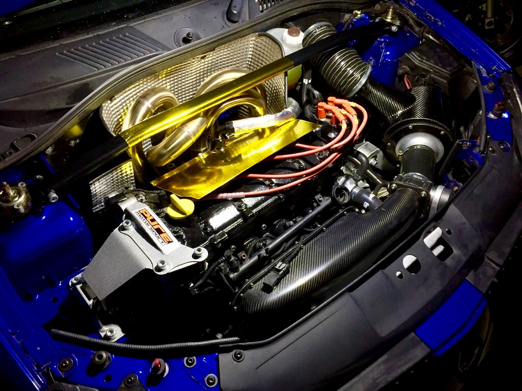

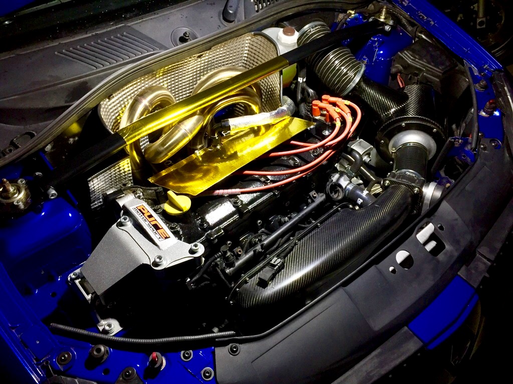

Do you mean fitted the PMS manifold with the standard inlet? Any pics? Where did he mount the coil pack?
gambit
  182 Trophy
Yes I have attempted it and it's still a work in progress ;) but at present there is not enough clearance between the rear of manifold and the headers unfortunately , it may in the end still only be possible with ITBs, RS2 or SM inlet type manifold.
