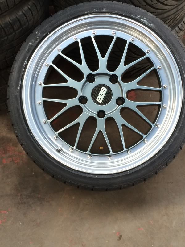

Ive just bought back a car i sold a few years ago fitted with BBS LM's and the wheels now need a good polish up so what is recommended ?
neil a
They are still on the car as I've just bought it yesterday.
I had them split and polished/ painted by 'Mike the polisher' 4 years and they were like new but don't really want to send them away to be done again just now.

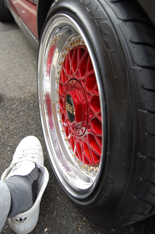

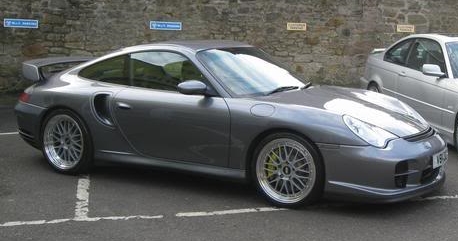

Nope Nope I love BBS LM's just hate cleaning them. Eventually I will get them split and polished , along with the centres going body colour.
Back to this sort of look.

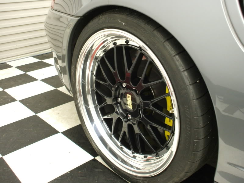

I think this picture was taken about a year after they were built and driven daily.

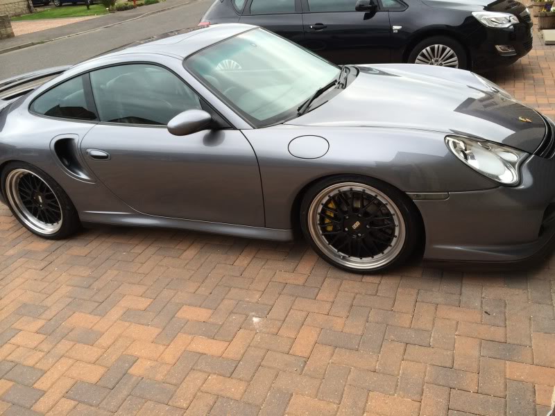

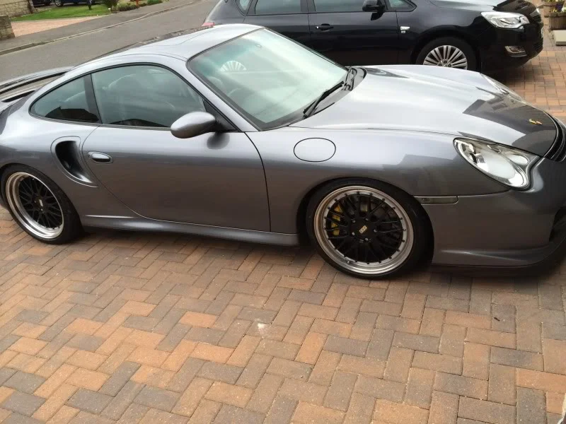

This was the wheels when i got them re finished and the centres done black.
If they can be lacquered then I will do that after a re polish, but I was under the impression that you can't as the surface is too smooth to take the paint.
