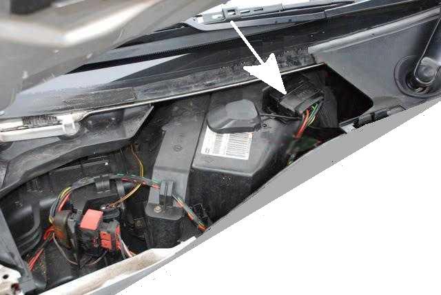

Arrows need to follow direction of airflow.
So they need to point into the car. Or down in the Clio's case.

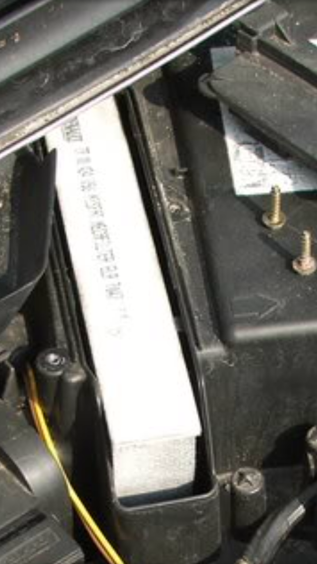

In the photo I've attached you see the casing with barcode on it, to the right of the pollen filter housing... This has an arrow on it. Is this the way the pollen filter arrows should point?

1. With the bonnet open, remove the windscreen half-scuttle grill from the right hand end of the bulkhead.
2. Undo the retaining screws and slide the cover forwards to unclip from the pollen filter housing.
3. Note the direction arrors on the filter and housing, then carefully extract the filter element by squeezing its centre folds together.
4. Fit the new element using a reversal of the removal procedure, but make sure that the direction arrors are aligned with each other.
maybe that explains better...
