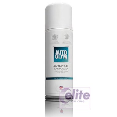

Regardless of the answer, this is what we do when we sell the vans the pig guys use:
All new matts
Plastics cleaned with APC
Wet vac carpets and seats
Then run 2 of these through it:
Fixes most things.

I bought the wife a car from a farmer years ago. It was disgusting but cheap! Managed to get rid of the smell by removing the seats, carpets etc and wet-vac the s**t out of it several times, cleaned the roof lying with the wet-vac and then left it in the garage to dry out before dropping an anti vac fogger like Waity suggested. Oh and replace the bloody pollen filter.
