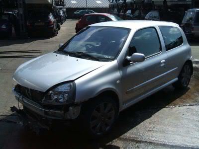

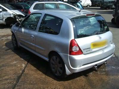

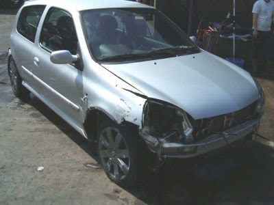

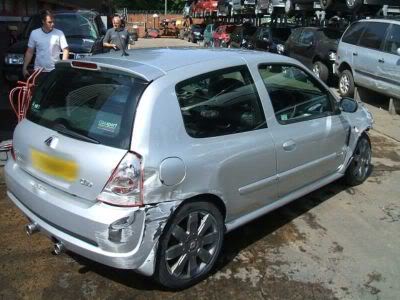

:S, new rear bumper, new o/s rear quarter, new o/s rear light, 2 new wheels, 2 new tyres, new o/s front light, new o/s front wing, new front bumper, looks like damage to o/s front panel, possible pull out with chain, gonna need tailgate repairing too from light hitting it.
this is just from the pics without actually looking round out/checking suspenion damage/underbody.
then you got paint/prep/strip/refit costs. basically an entire respray is needed apart from the roof.
Engine was super clean looking and untouched and really the only thing worth buying it for but at £2800 odd it was for sale for, it would be a very expensive engine !
