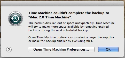

Didn't want to start a new thread...
My iMac has been happily filling up my external HDD since I bought it at the end of last year.
I split a 1TB in two and use half for personal back up / storage and the other half is left to Time Machine's needs.
Today, I'm getting this annoying message keep popping up:
I go into preferences as it shows me, and there's no options to do anything it suggests.
I tell it to delete old ones, but it seems to ignore me and lo and behold, the same message comes back.
Any freakin' ideas, Apple gurus ?!
Losing my mind here.
Thanks.
