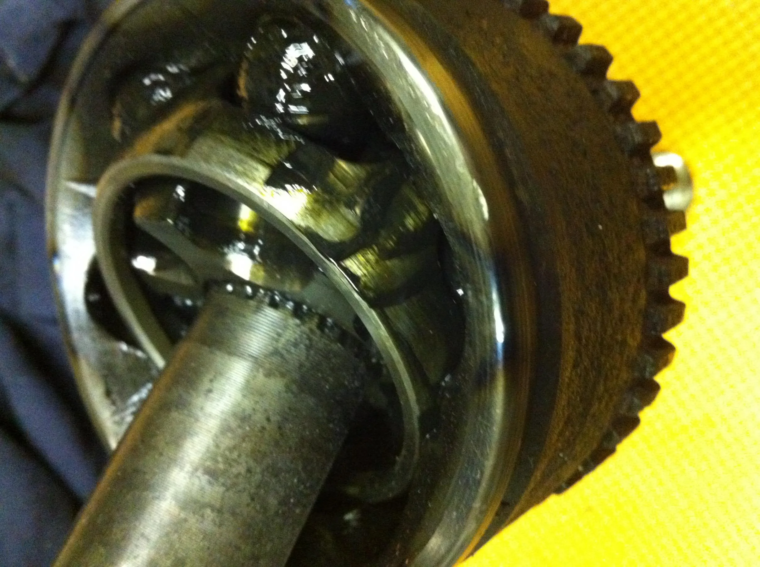

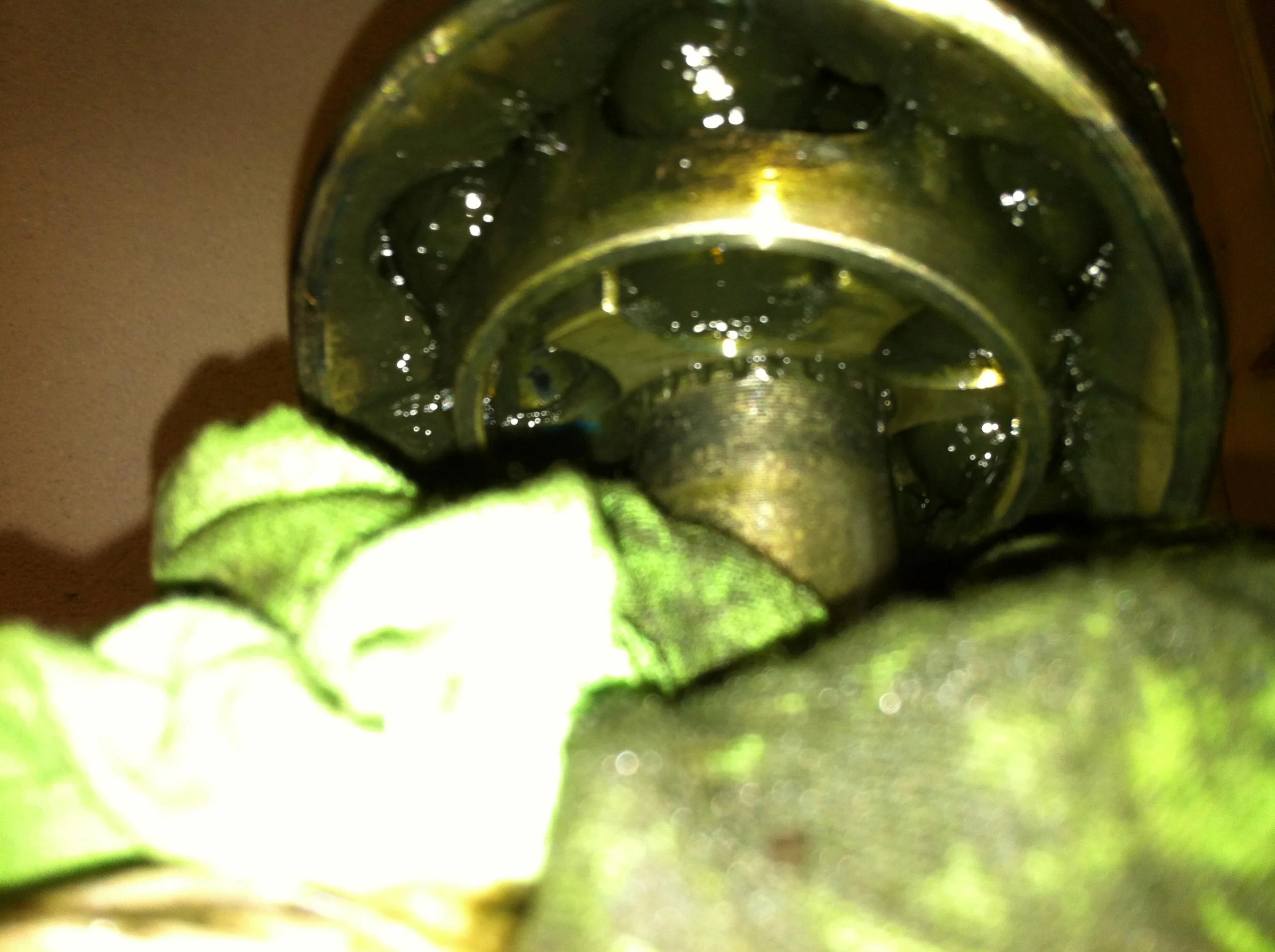

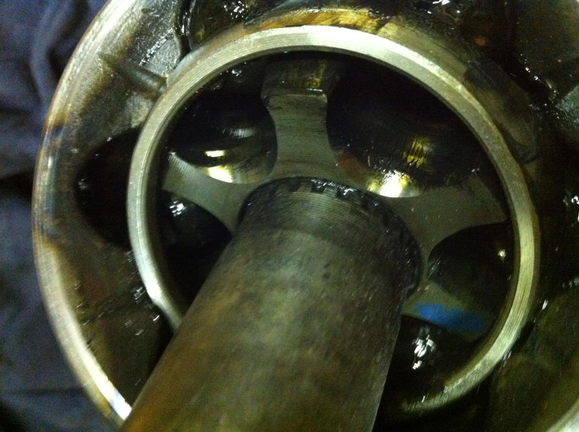

Hmm, had a real good look at the good cv tonight and I don't see any circlip to take it off. Am I missing something?
Is it one of this hammer off and on jobs?

Look further inside the joint mate. There's a circlip about 1" down the the shaft, inside the joint. They are definitely not hammer off joints.
Give it a good clean out inside the joint mate, you will see the circlip.

Are you really, REALLY sure dude?
This is the outside CV joint we are talking about now.
I see absolutely nowhere that there is a circlip. There is nowhere to get down the shaft at the splines.
Am i being completely thick?

Try giving it a bash then mate. Use a soft hammer to do it though. Every one I've done before has had a clip though mate, but as you rightly say, there's nowhere to get down the joint.
