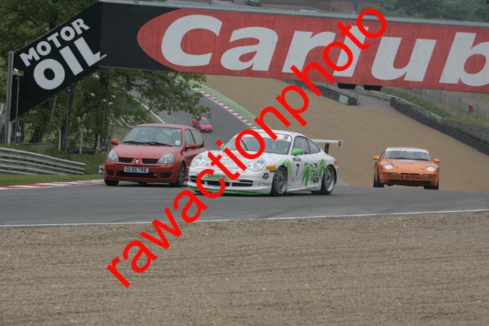

Might have well been a race meeting on the day, there were a couple of these things pounding the track almost constantly all day...
There were four race teams carrying out full on testing as far as I could tell. Various cars.
