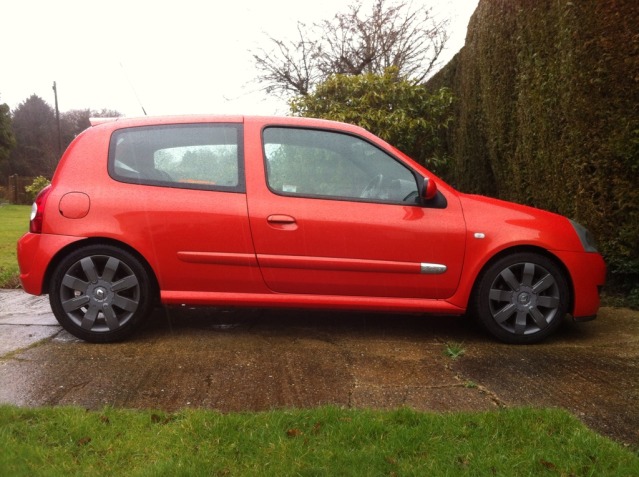

I got mine Powder Coated in a generic Anthracite which turned out to be about a shade off standard. You can only really notice it if looking closely and at certain angles.
For the advantages in durability that a Powder Coated finish gives over your average wet paint job I will happily take a slight shade difference, and I mean slight.
Might as well leave a picture where you can make out the difference most clearly. Bear in mind the centre caps are totally untouched, so they may even have faded over time.
