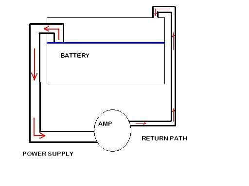

A circuit is just that, an outward path & a return path, current will only flow as fast as it can at its weakest/narrowest point....
Lets revert to a basic pic, makes it easier to explain & hopefully easier to follow;
As current is drawn, voltage will dip, (blue level line), if return path is restricted then voltage will remain low, if return path is similar or larger then current will flow easier, (quicker), so maintaining higher voltage level....
By 'NOT ADDING' a new battery to chassis earth to MATCH the new power supply, your simply creating a dam that will restrict voltage throughout the whole car....
A power cap can supply the initial high transients that are required on big bass hits, but if the charge circuit is restricted elsewhere then its usefulness over anything more than a few seconds is very doubtful....
In short, a power caps usefulness is limited to your actual charge circuit, if the charge circuit is adequate, then you simply don't need one....If your charge circuit isn't adequate, then fitting one is pretty much pointless....

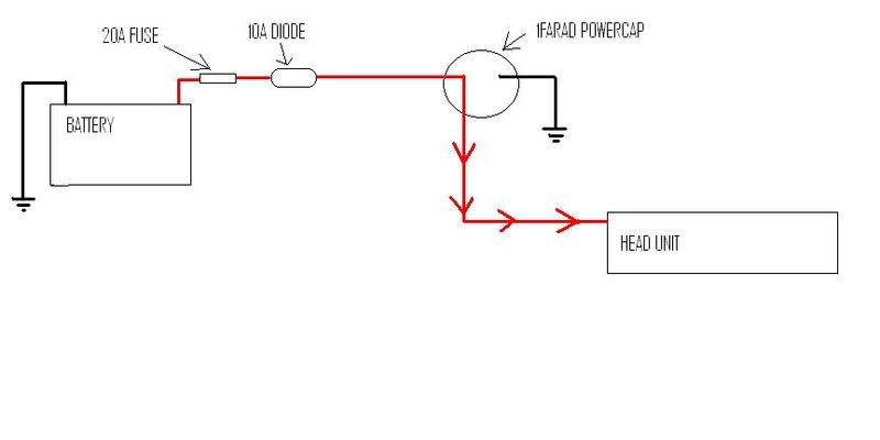

Nothing stopping you from using one on the supply to your head unit though
