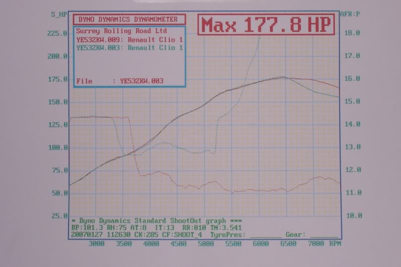

On this graph, the 2 lines were run 13 months and 24,000 miles apart, at 70k and 94k.
The red curve was the latter.
There's no power loss if serviced properly (ignore the torque/fuelling lines, they're not comparable)...
