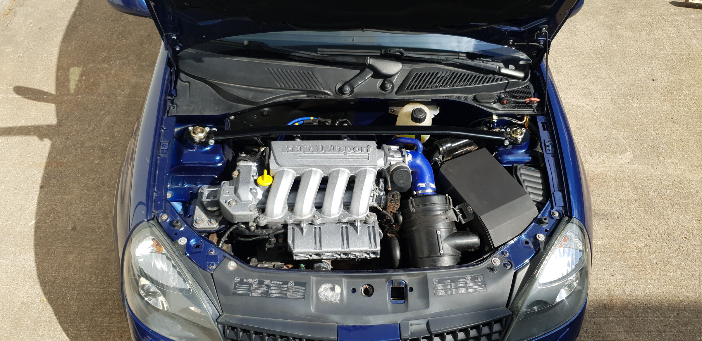

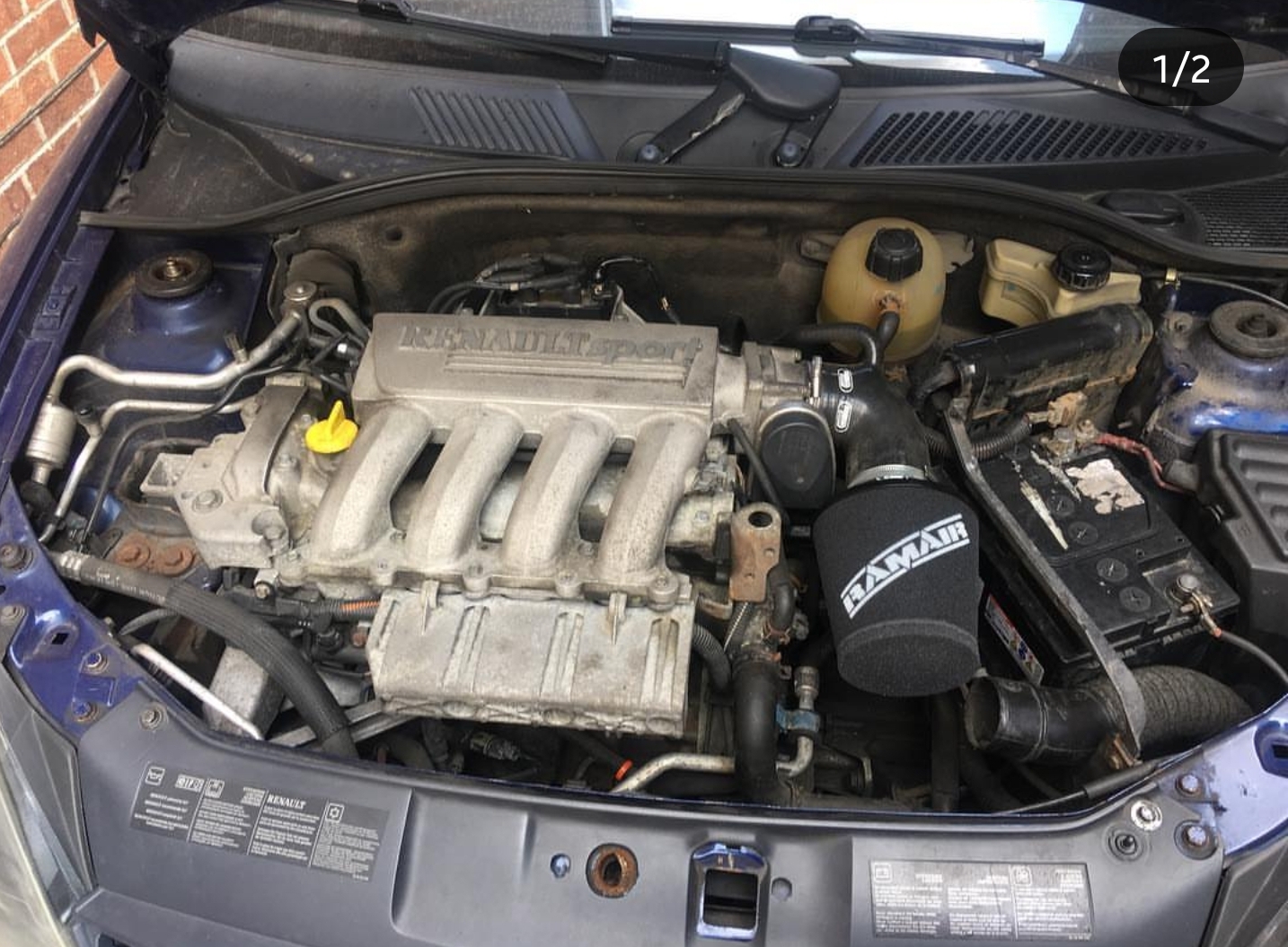

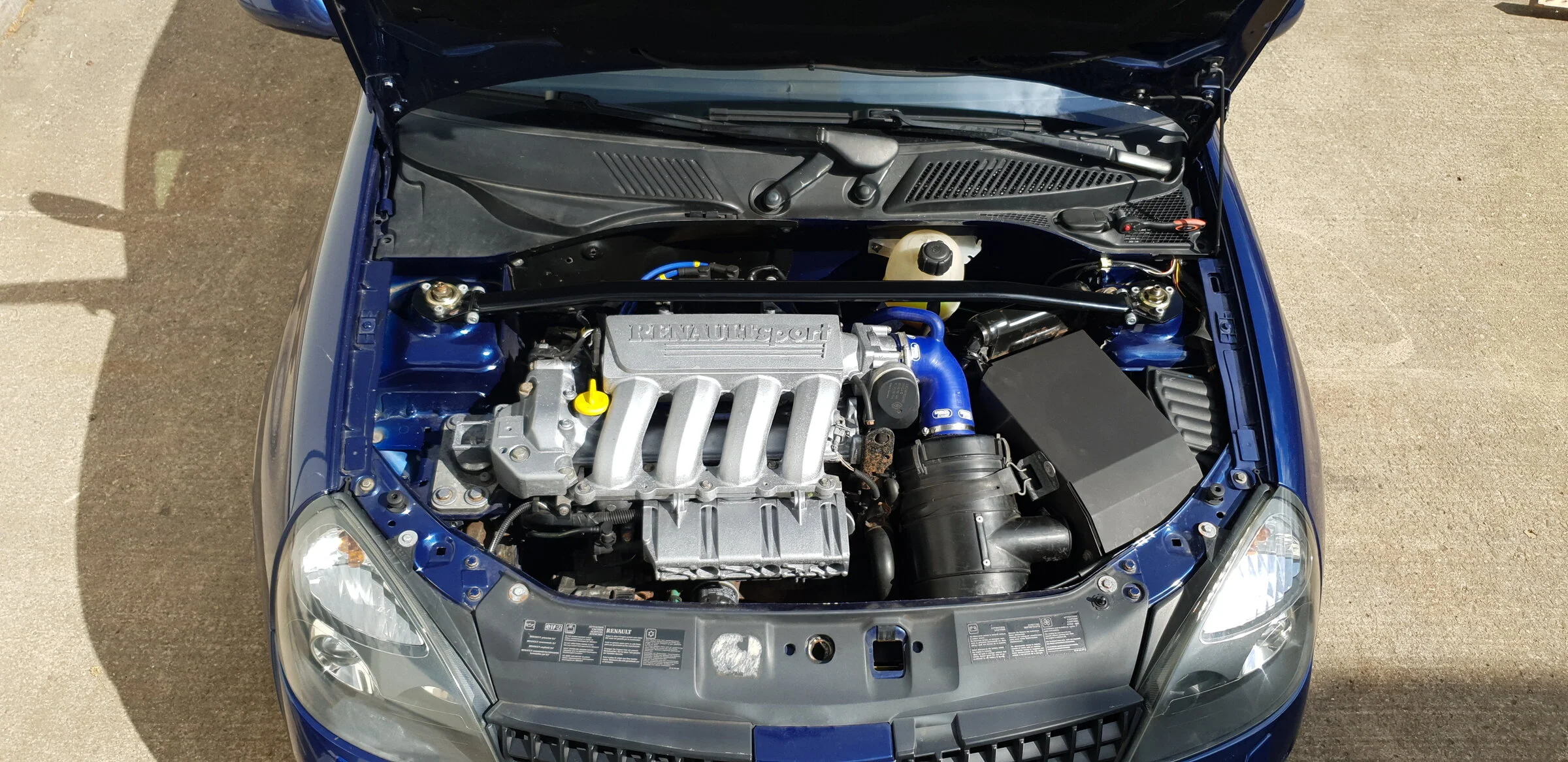

Doing away with all that bullshit cleans up the bay so much!!
Before
After

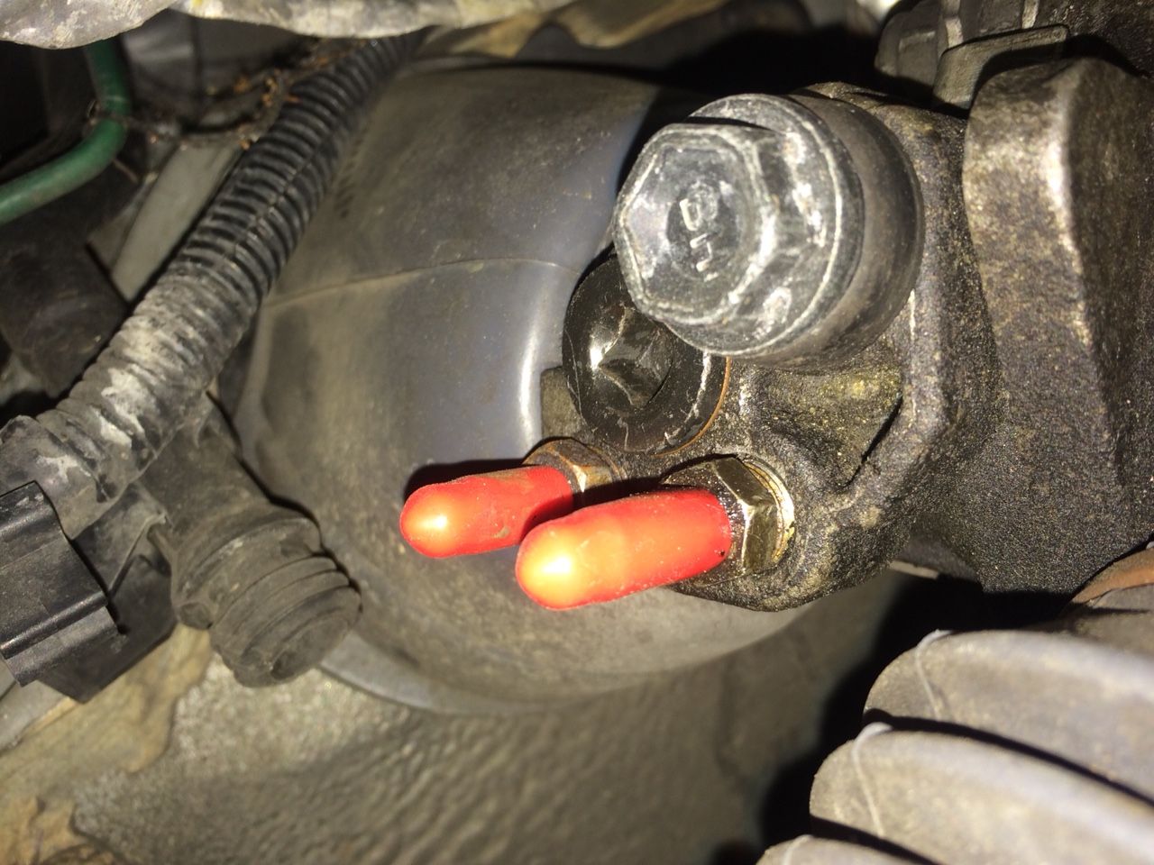

Well after trying to get the broken pipe out today the EPAS is becoming ever more tempting...
I've shamelessly stolen this picture from another thread on here (no idea which one, google images found it for me, this is not my car)
So, I've partially dropped the subframe (Column UJ bolt out, rear subframe bolts out, gear linkage dropped, dogbone mount out, front subframe bolts hanging on by a few threads, inner wing subframe tie bar things disconnected, little rack heatshield moved out the way as one 10mm is spinning in the subframe) to allow me access to the rack.
Now, I've removed the two smaller (12mm?) ones no bother, straight out.
The one with the Bolt in it in this photo, that's the pipe/hose that has a hole in it which I need to remove/replace (caused by the heatshield bracket rubbing through it)
The one with what looks like a square drive sump bung in it is currently blocking access to the one i need to remove. The pipe has seized inside the union and therefore won't thread out. Destructive means have very nearly crossed my mind but i'm still not 100% on whether i'm going EPAS yet, so any tips on how to remove either the pipe that's seized in the union? (Is heat safe in this area? With the rack boots and now open ports?)
Or does anyone know a way to remove the one I actually need to remove without disturbing the already seized one?
Can anyone tell where this pipe is going just from what port it's going to? Once again its the hose/pipe connecting to the port that has the bolt in it in the above photo
Sorry for the bunch of questions, there's been lots of swearing which has got me thinking there must be an easier way, I just cant fathom it
