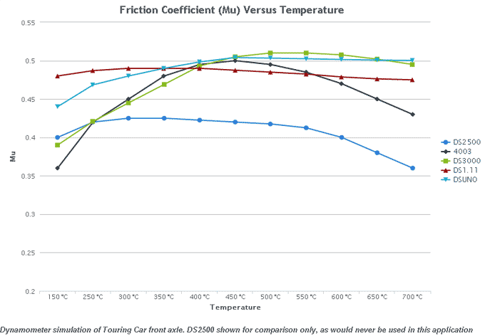

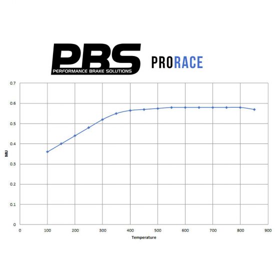

Looking at graphs from Ferodo and PBS the PBS pads actually are the higher friction pads though aren't they?
They apparently need a bit of heat in them to work but peak friction looks significantly higher than the ds1.11.
I've got both the PBS pads and ds1.11 but not tried the latter yet so sadly can't make a comparison!
JamesBryan
View attachment 1502216View attachment 1502217
Yeah, although you won't really see those higher temperatures for sustained periods on a track day so the ds1.11 have a higher coefficient from cold.
MLB
Crossover seems to be around 280 degrees between the two pads. I have no idea what brake temperatures you would see if continuously monitored over a lap (all very much driver/weather/track etc dependant of course.)

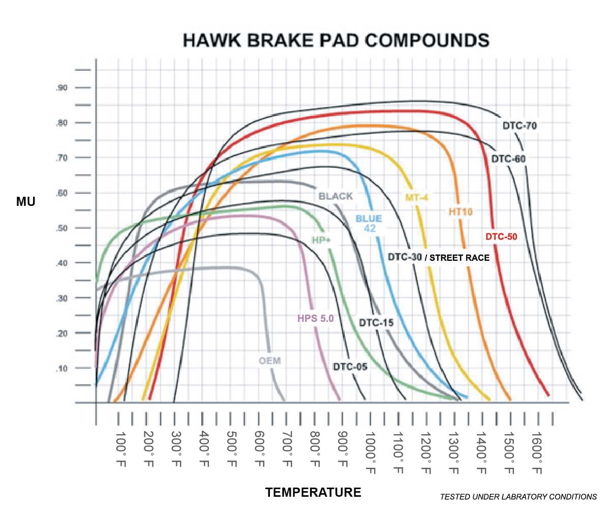

I've found Hawk HP+ to be very grippy from stone cold - I think they have a similar mu to the DS1.11? (although I note the graphs above start from 100/150 degrees, which is not 'just set off when it's snowing outside' cold :D lol)

I've commented on the Hawks before. I had HP+ on a previous DC5 and they were excellent. Good from cold too which was surprising considering they're predominantly a track pad. They kicked off tonnes of dust though but it was worth it for the stopping power. Expensive though.
Both from kam racing for ease but they are also published in the PBS and Ferodo website.
Sadly there is no standardisation for measuring braking friction so the comparison of graphs gives you an idea of how the pads react to temperature but nothing else. Friction can change based on clamping load and many other factors on a test rig

I'm very happy with the Hawk HP+ :) but I think I read somewhere that they operate differently to other pads, in that other pads use some element of transfer to the discs to improve braking power, but the HP+ literally just eat the disc :LOL:
I got through a set of (admittedly very cheap) front discs in 8k miles with the HP+ IIRC, and I am *very* light on brakes! :D lol
