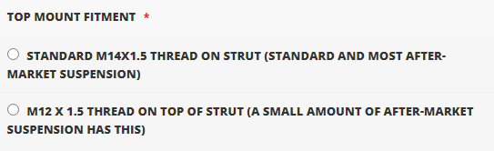

Easy to fit. Drill three holes in each mounting point for them. It if you want to use the PMS strut brace make sure you drill them the right orientation.
And I think if you need a different option for them to fit the Bilstein B14’s. It’s just a section box before you add to basket on the PMS website.

yea you can choose two options but how do i find yout what is for the b14 i bought the car with the b14 already in so i dont know ahahha
