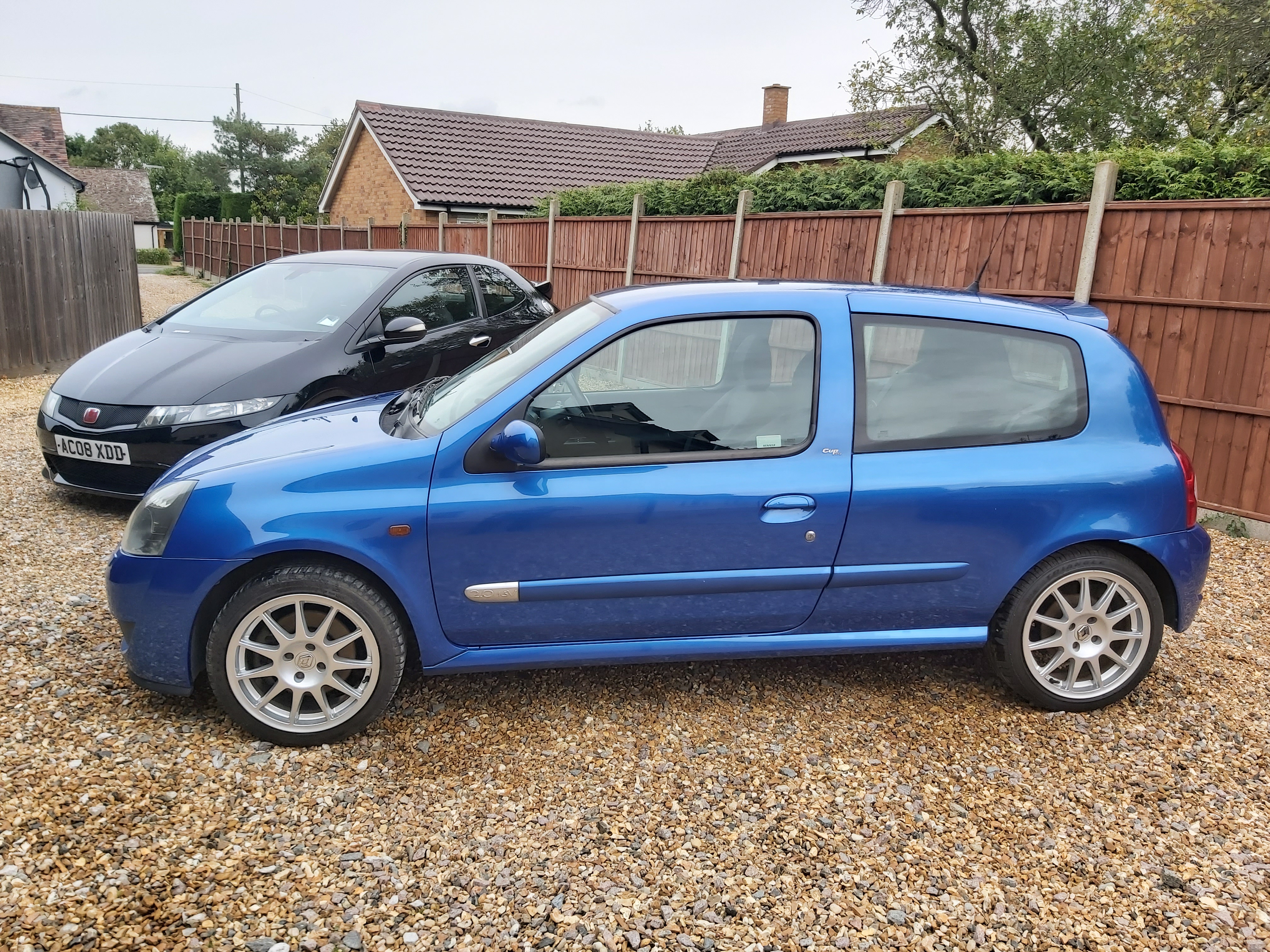

Hi all,
I just wanted to give you an update on progress with the Clio...
I took it to Alex at AW motorworks for some bits and pieces to get it through the MOT and to my surprise it only needed a couple of things and came through with just advisories on two tyres and a cracked ABS ring (it's a 172 cup 😂😂😂)
So I had belts and dephaser done along with a few other niggly jobs and got some great advice regarding a few other bits which I'll do next spring.
Its great to be back on the road in it again, but within 2 weeks of getting it back the exhaust started blowing so it's now the proud owner of a PMS catback exhaust which I would highly recommend.
I've done a few little bits to freshen it up like give it a full inside and out valet, fit new boot struts, paint the calipers, restore headlights and fit a fabia splitter and it's looking good again.
If anyone is in the south east and needs anything Clio related I would definitely recommend Alex, he's really knowledgeable and helpful.
And thanks for your help and advice on here, it's great to be back driving it again.
Cheers Ian

Looks great!
Which exhaust tips did you choose for the PMS exhaust? Have you got pics from a couple of different angles?

Looks great!
Didn't need to have them, the exhaust is hidden behind the rear bumper and angled down.
