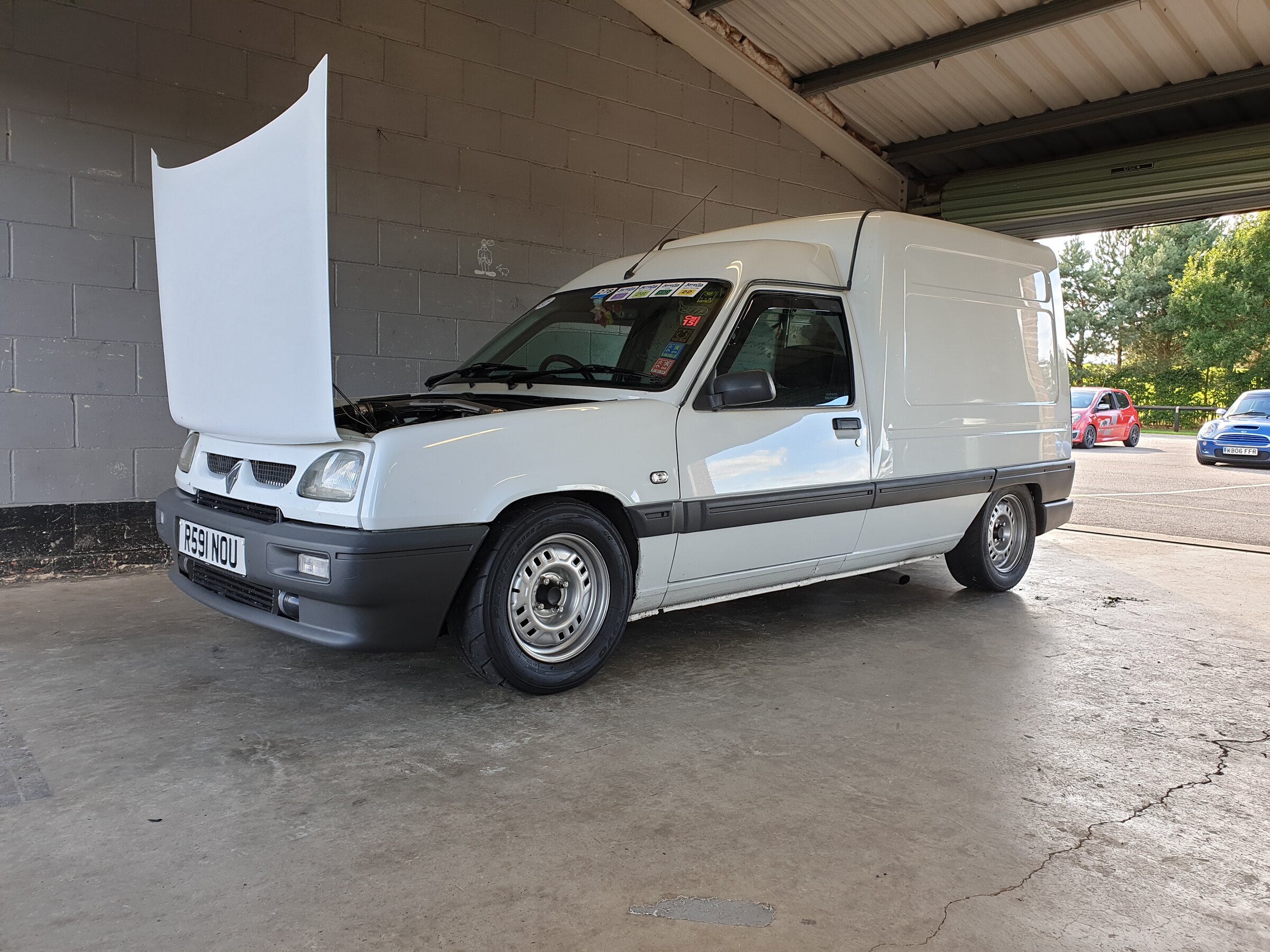

Got any pics of the van? Sounds fun! Were these based on 5's?

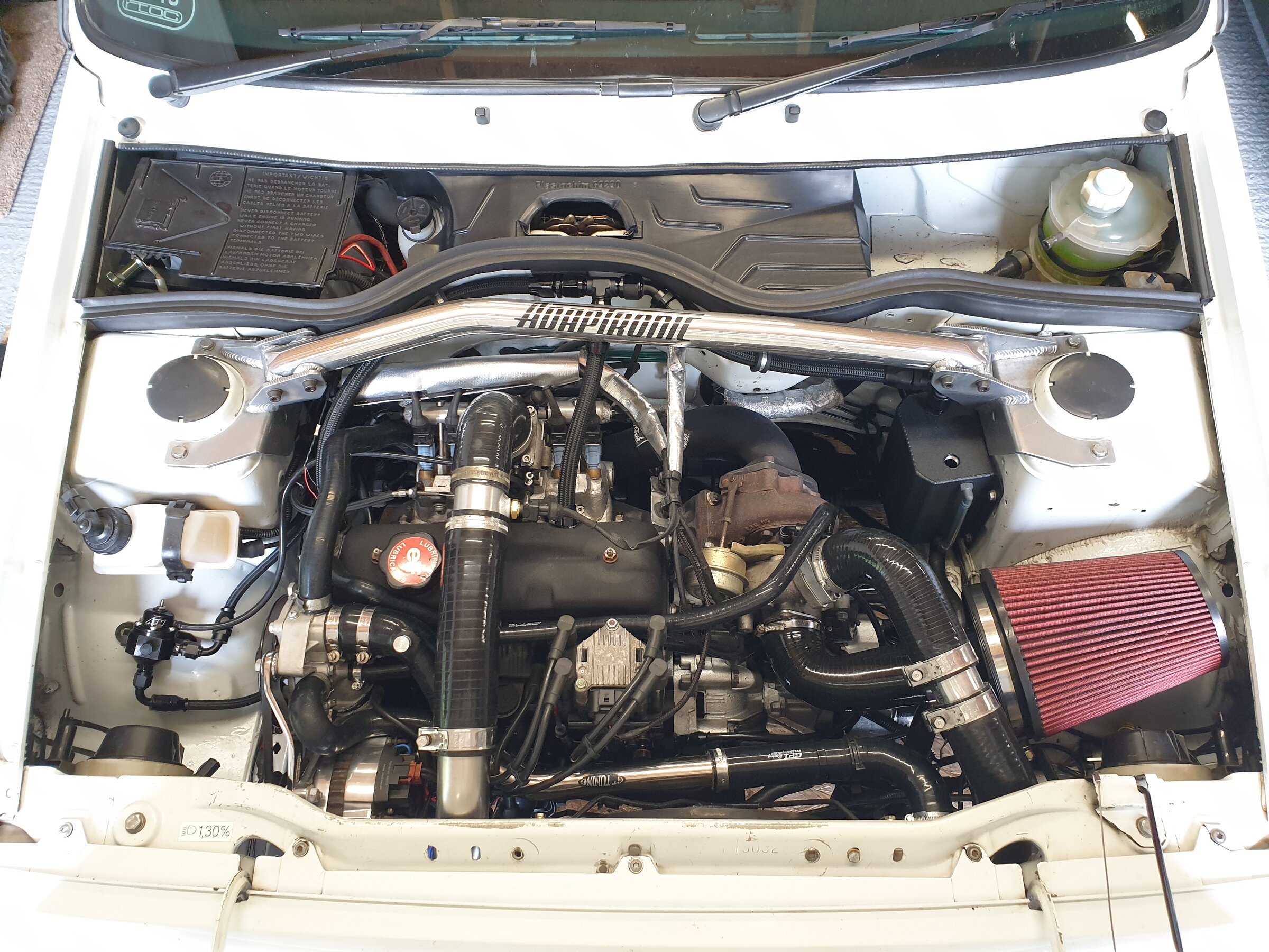

It is indeed based on a super5. Everything gtt related bolts straight on Theres a load of pics on my thread for my old Kangoo from the recent efi conversion & freshen up its had.
Felt good taking it back out on track again as not been out since 2016. It actually corners now with the quaife and harder front springs. Low boost 12psi 171hp & 900kg seemed quick enough.

It is indeed based on a super5. Everything gtt related bolts straight on Theres a load of pics on my thread for my old Kangoo from the recent efi conversion & freshen up its had. View attachment 1494497View attachment 1494498View attachment 1494499
Love it! Wheels are spot on too. Good job being awesome mate 👍
