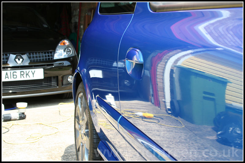

  106 GTi
By Machine -
This turned out ok.
Sonus Yellow SFX Cutting Pad - Poorboys SSR 2.5
Sonus White SFX Polishing Pad - Optimum Polish
Waxed by hand - P21s

Some bits come up on ebay.
The Blue one was one I did for a Dave (Dave Hughes on here) mine is the black one behind.
  BMW E46 330i Touring
Can't see the point of getting anything off ebay to be honest, the savings won't be much.
Follow Rich's advice and you can't go far wrong...
