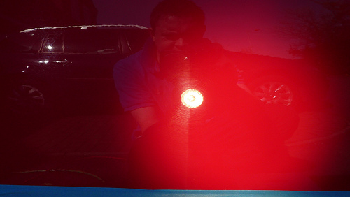

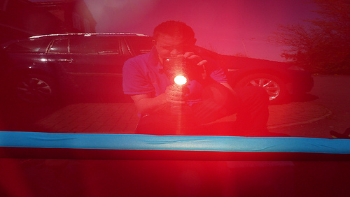

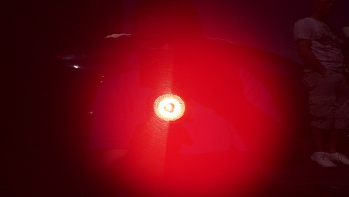

The car was then assessed for swirls using a DIY Sun Gun, to reveal...
P1030789 by RussZS, on Flickr
:doublesho:doublesho

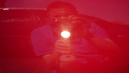

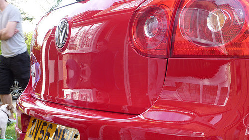

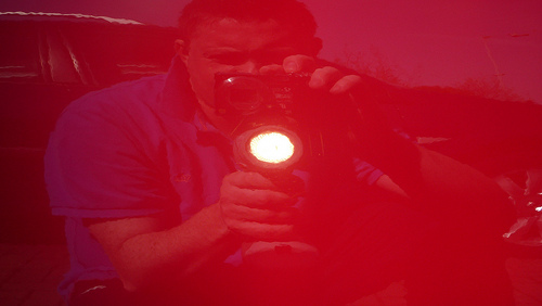

I wasn't in the mood for, and didn't have the time to, fully correct this, so expecting it to be rock hard, I decided to lightly "enhance" using Dodo Juice Lime Prime.
I used my CP Rotary and Megs Polishing pads to reveal...
P1030788 by RussZS, on Flickr

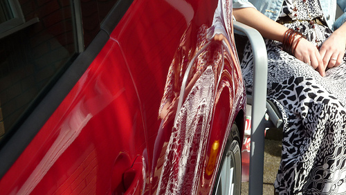

Just goes to show, you can't "assume" something is "hard" or "soft" - I was certainly surprised anyway...

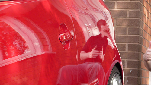

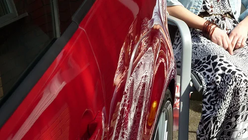

P1030791 by RussZS, on Flickr
P1030792 by RussZS, on Flickr
P1030795 by RussZS, on Flickr
Not bad huh?

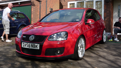

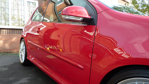

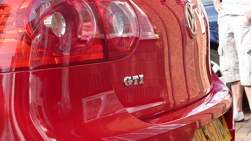

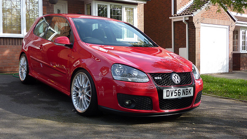

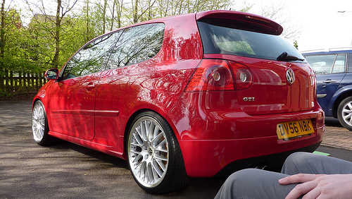

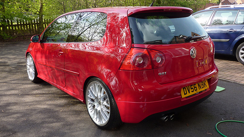

Some "afters":
P1030797 by RussZS, on Flickr
P1030800 by RussZS, on Flickr
P1030801 by RussZS, on Flickr
P1030802 by RussZS, on Flickr
P1030803 by RussZS, on Flickr
P1030804 by RussZS, on Flickr
P1030805 by RussZS, on Flickr
P1030806 by RussZS, on Flickr
P1030807 by RussZS, on Flickr
Just a quick one, but a pleasure, and such a lovely car. It's only done 6000 miles!
