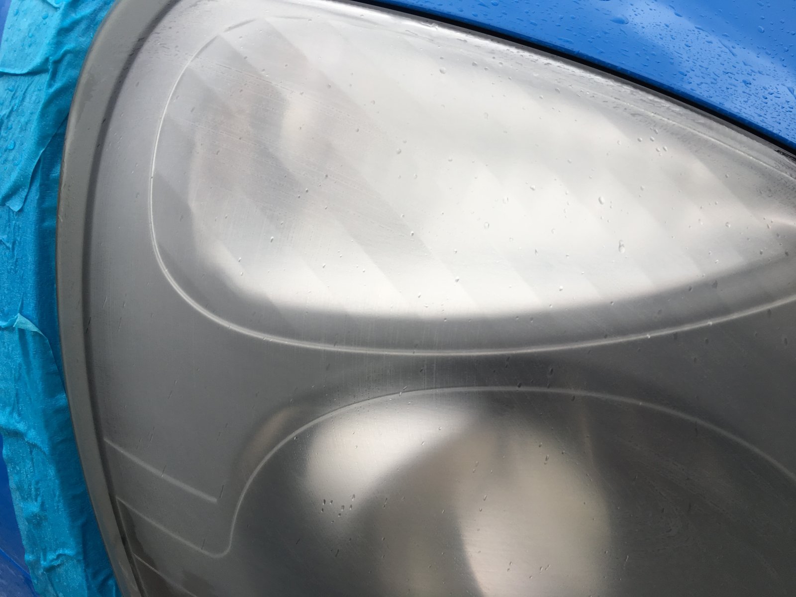

Here's one I made earlier.
Sanded with 800,1200,1500 and 2000. Will get polished up tomorrow.
I need to sort my wife's car headlights. Happy to use a machine polisher without fear, never tried wet sanding though - @Knuckles any guides anywhere?
