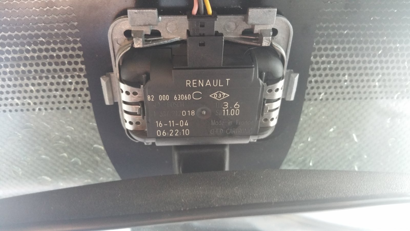

I'm looking to change my rain sensor and have seem the guide but unfortunately the pictures no longer work!
Does anyone no how the senor in clips from the surroundings?
Just don't want to break it! Have attached a pic

@timlowthian The metal clips/brackets on the left and ride hand side prise backwards towards you. They hold it in place - be gentle however!
