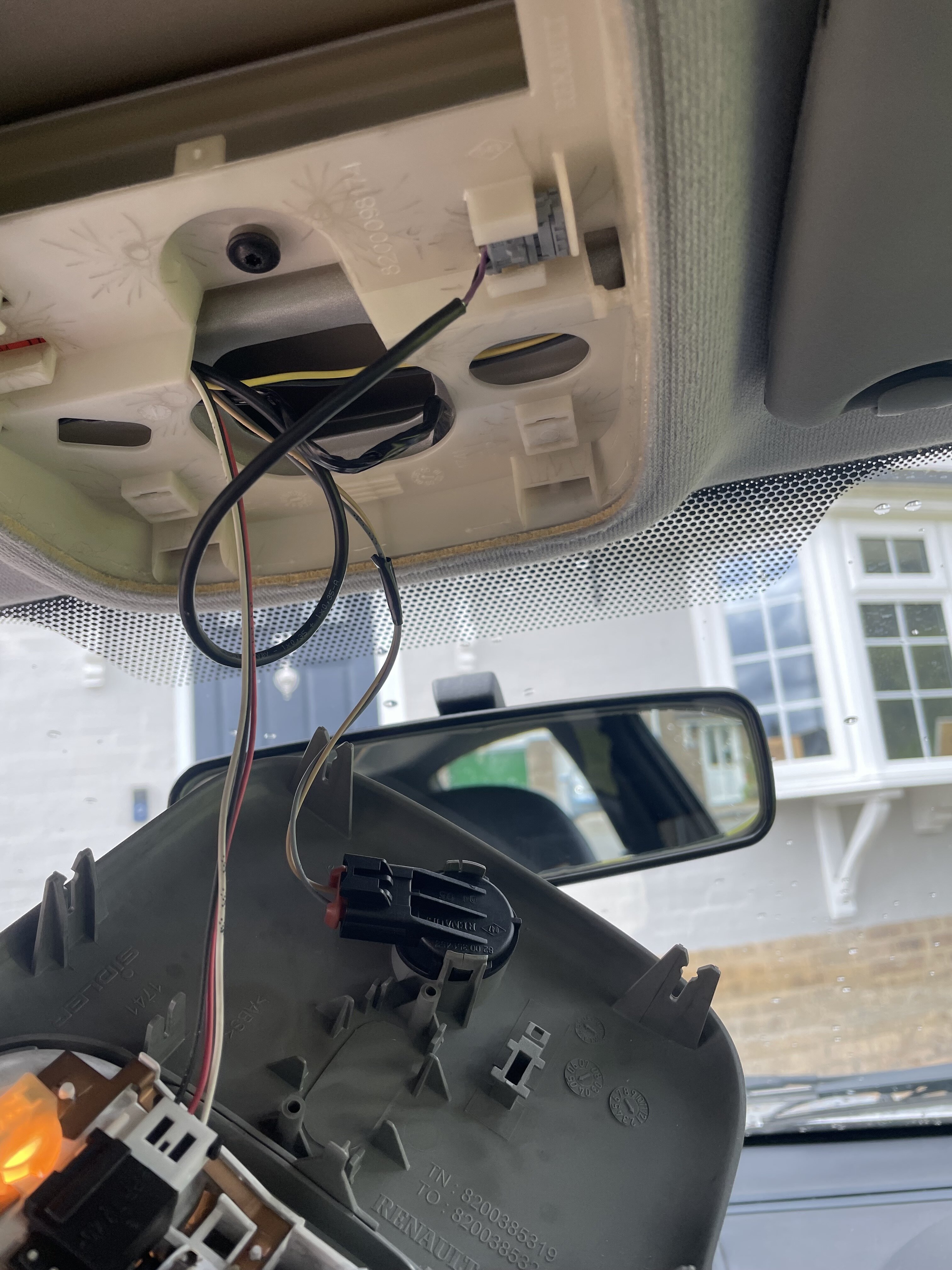

So i realised last night that my auto headlights don’t work and neither does the auto wipe function. It didn’t occur to me until later that something was missing from my windscreen! Seemingly the sensor and housing are not there. I pulled down the lining and found the wire tucked up behind it. It would seem that i may have an incorrect screen fitted as it doesn’t have the sensor cut out. Why anyone would accept this and remove the sensor is beyond me! Anyway, i have found a sensor and housing on ebay, but can anyone confirm if the screen has a bracket attached to it as i cant see how it would all fix to the screen? And im guessing i now need to buy a new windscreen !😡

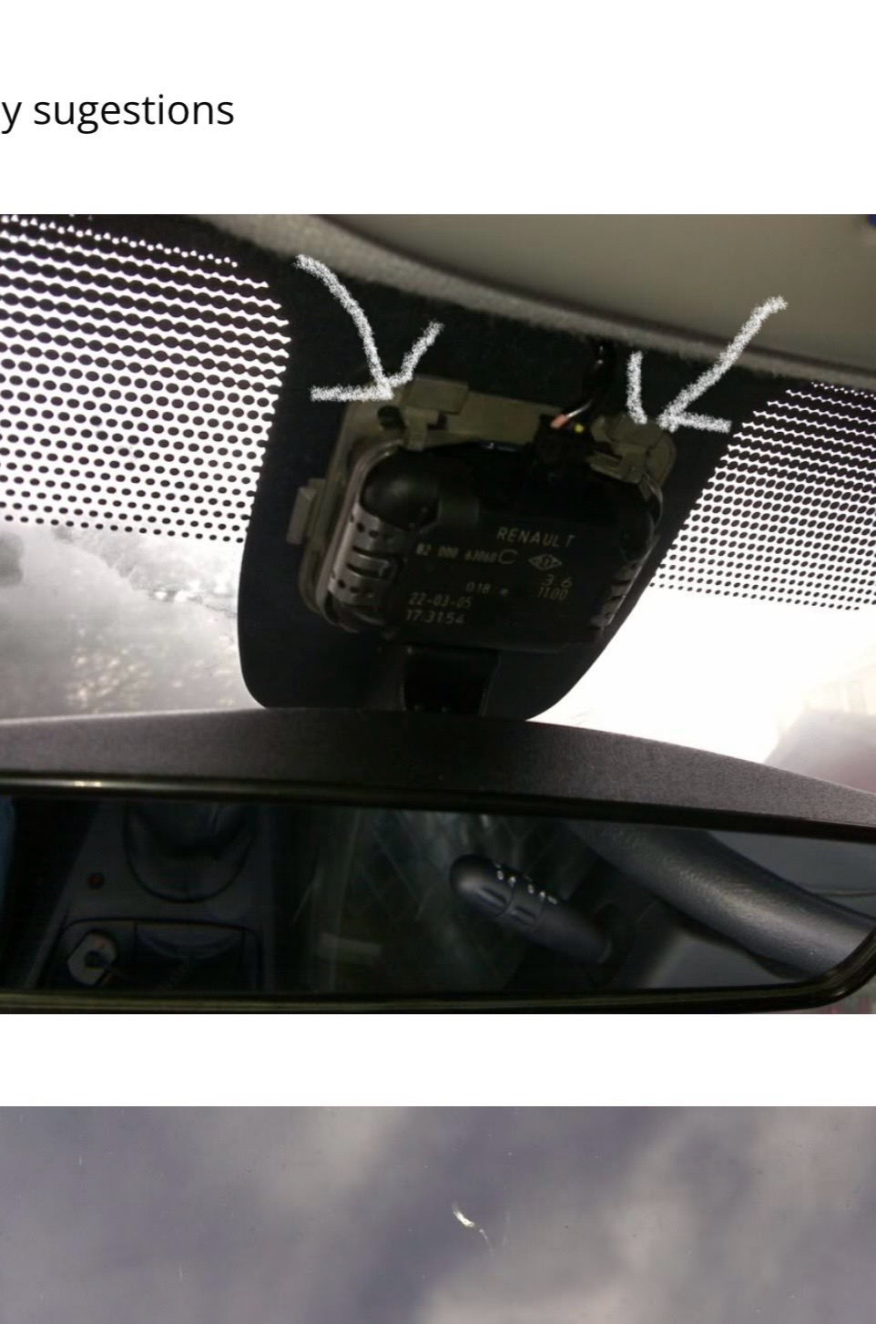

Found this image on another thread- is the beige frame part of the screen? Or is that a separate part i need to source?
It was about 4 years ago when I had mine replaced, but I'm 99% sure the plastic clip in your picture comes bonded on the screen. I've also recently had a new rain sensor replaced and that didn't have the plastic surround, rather it clips into it.
The Rain sensor is - P/N 8200063060
That’s awesome, thanks. I’ll probably source a sensor and see what a screen would be cost wise…. Accidental damage or otherwise ! It does look like something that would be bonded to the screen as the coul/cover for the sensor doesn’t have any fixings from what i can see. Thanks all 👍🏻
That wire isnt for the wipers / lights. Its for the other interior temp sensor as Renault used two types for them.
The wire i found you can’t see in the pic very well, its connecter was in the lining. Ill have a look at the sensor connection to check. Cheers 👍🏻
