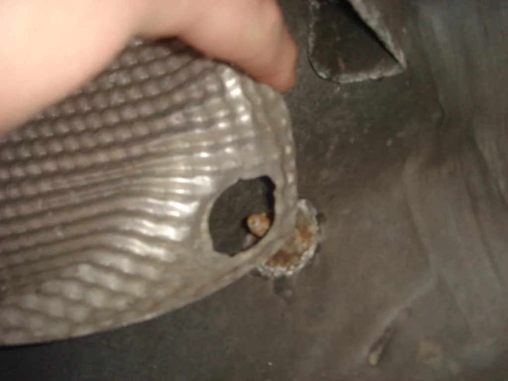

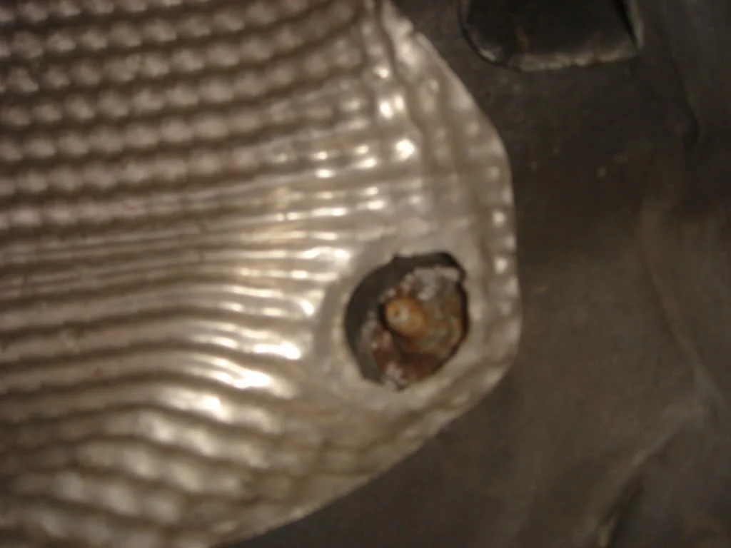

since getting a cat fitted i noticed a rattling from the exhaust on looking it think it may be this???
happens mainly at low rev's, its annoying n sounds sh!t when setting off coz it rattles,
common problem?
any ideas on how to sort this? i was thinking thick rubber washers n a nut? need 4 tho?

They all do it. I've glued mine up with araldite. Doesn't move anymore, regardless of whether I want it to or not.
Darren S
Piece off piss fix, m8.
I went to B&Q and got a pack of larger washers for about a quid. Sprayed some WD40 on the nut to loosen it take it off, then slid the washer back on with the nut over it - trapping the tray up against the chassis.
Worked a treat and stopped the rattling noise straight away. :)
D.

exactly what i did
i dont have any rattles anymore
ive had to sort 5 or 6 diff ratlles out from around the car
i now class my self as an expert lol

cable ties are your friend :D. Couldn't be arse removing it as the bolts were a b**ch to remove. Normal problem. Just take the heat shield off, not going to make much difference really

yeah i did what darren s did. thing is after a while the heatshield also tears around the new bigger washer. getting the araldite out when the weather improves.
  clio 182
washers short term, araldite long term? looks like ill be glueing then! or i might just get the garage to sort it when it goes bk in of a part under warrently?
