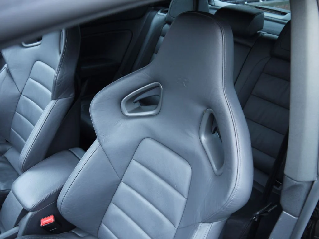

It's replacement has a rather lovely set of heated Recaro bucket seats :)

Haha, you haven't by any chance dropped a 3.2 V6 in there have you? That could interest me!
RDH
Will they fit?
