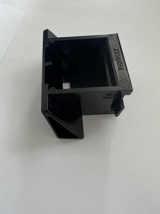

Second question is - I had to take the fuse cover etc off to get the BCM sorted out ages ago - when I put it all back together again, I had a bit left over and I cannot work out what it is or where it goes :rolleyes:. It a small piece of black plastic that looks as though it slides in somewhere - the number inside is 7700415853. Looks like this;
https://thumbsnap.com/1BEgM5WJ

Pic of 'bit' attached

I don’t recognise it, but a quick forum search brings up
Photo 6 looks like you can see it on top of the plastic housing
Yes! That's the puppy - I vaguely remember removing it when I sent the module off to be repaired.
