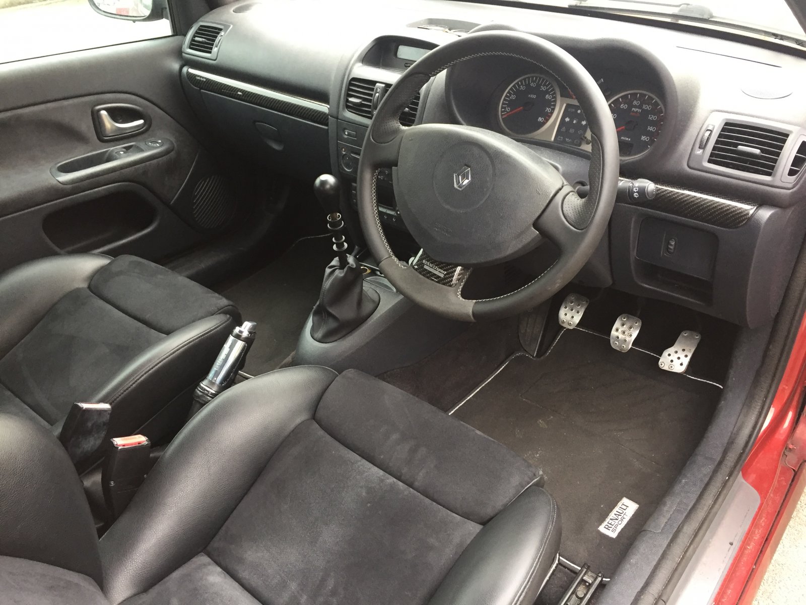

I have just collected my first Clio 172
One thing I do find is that to get a comfortable seating position I have to reach further than I would like to reach the gear knob. It's just low and close to the dash.
Now I looked at a longer knob but with the lift up reverse there isn't any about. Anyone found a solution other than a very expensive pms shifter?

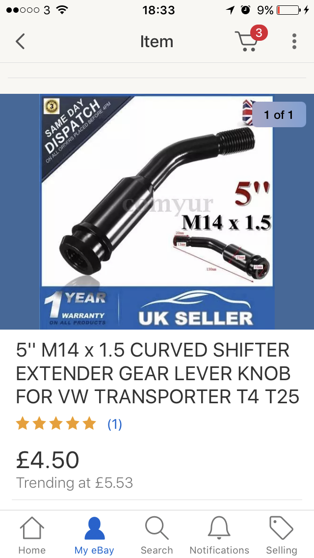

Would this work?

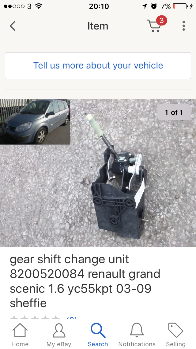

Some use the scenic shifter and bend it so it feels better. I've had this and now the pms.

How much would a scenic shifter be?

I've got the scenic modified shifter and really rate it. Miles better than the original one. Tbh though the PMS one is epic I imagine but haven't tried one.
  dan's cast offs.
scenic one is a crap as the normal one except you don't have to reach as far as the ashtray do feel how crap it is!!

Search 'burpspeed linkage mod' or 'shifter mod' and you'll find some info on effectively shortening the linkage under the car which brings it nearer to you. Works a treat.

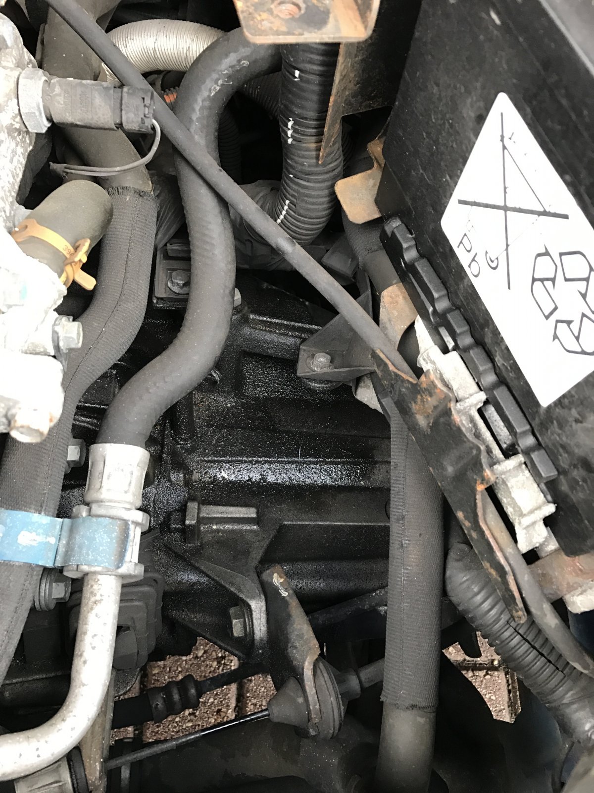

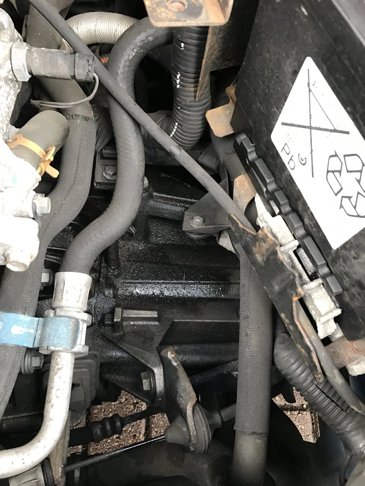

I noticed there is quite a bit of oil on top of the gearbox too! Any ideas where this might come from?
Same as mine. You fill it up until it cant take anymore, so may just have gone everywhere when filling up.
