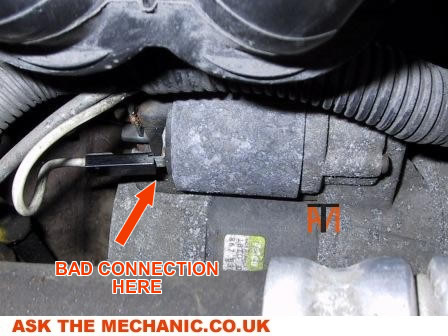

Strangely my problem just went away, I have been told in the meantime that the alternator connection can be a common fault as it becomes loose. This picture I found should give an idea http://www.askthemechanic.co.uk/images/Renault%20starter%20motor.jpg

I had this problem last year, progressively got worse until I couldn't start the car. AA ended up coming out and diagnosed it straight away saying its a poor connection to the starter motor. Cleaned the connection with abit of wire wool and has been great ever since. He said he's seen it before on other clios.

I will look into that thanks Liam, where is the start motor located exactly? Any photos about?

I see! So where bouts is that located then? The photo is helpful BPY thanks.

In a horrible, horrible place on the 172/182. Right at the back of the engine under the exhaust manifold... enjoy!

It comes on solid for about 10-20 seconds then turns off along with the SERV light. The immobiliser doesn't seem to be the issue based on other comments. I'm thinking the start motor connection may be at fault - but not sure if I'll be able to sort it myself based on Mick's comment.
