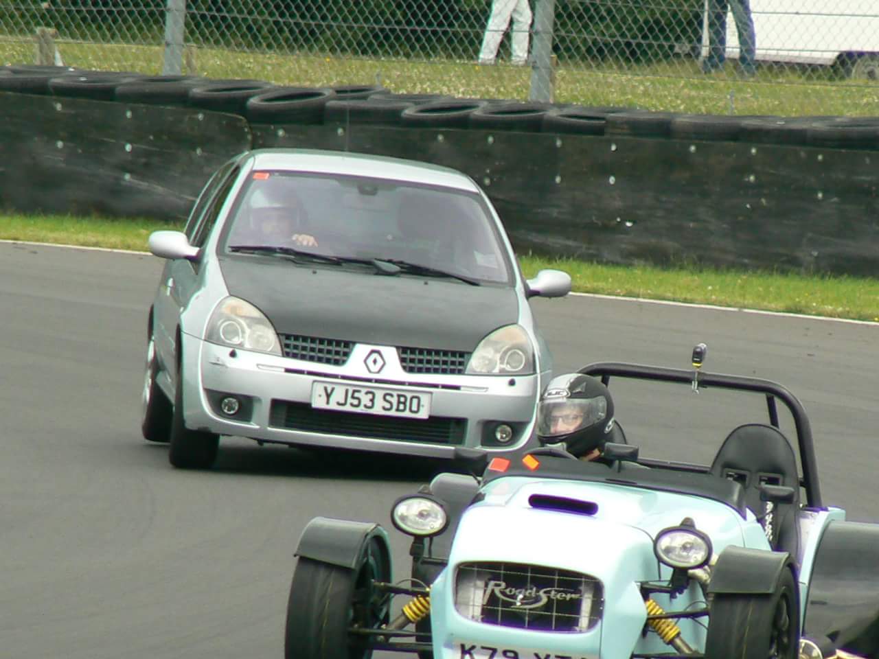

I can just tell the front needs stiffening up a bit more. Looking at the pics from Retro car show it's looks like its leans on the passenger front a hell of alot.

One of the pics

Doesn't matter if it leans or not, it's what it handles like etc.
