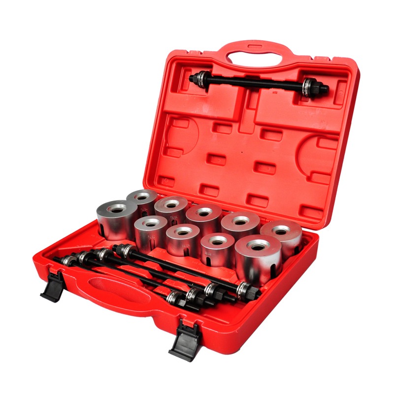

Yeah they need pressing in, metal sleeves first, then the bushes themselves, we used these to press mine in.

@DaveDreads - whats the name of that kit as I want to get one. @JP83 and me kind of made a similar tool when we did his rear beam bushes but would like to have a proper tool.
