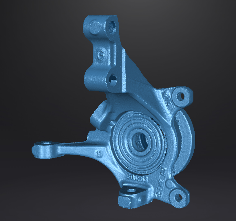

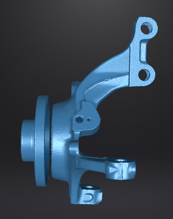

Where are you based? I can 3d scan one for you for free. The software/s can take measurements and can see angle/height differences of the hub faces and everything else needed. Pretty accurate considering I paid 5.5k 😅 (0.05mm accuracy and 0.1mm per metre volumetric accuracy)

The quality of that is awesome.
