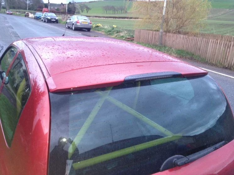

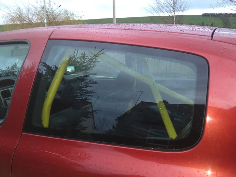

i dont know what make it is.. It comes in 3 pieces : 1 Across the 2 rear struts, 1 going from the floor beside the bottom of the b pillars all round to the top and across the roof, 3 and last is like a cross piece that joins the 2 pieces together. will get a photos in a min :)
  Ly Megane 230 F1
thats the only photos i have at the moment
Il be honest and say at this moment im unsure if it is a real cage or just for show.. the cage is really sturdy and not the lightest(feels like the metal is quite thick)
