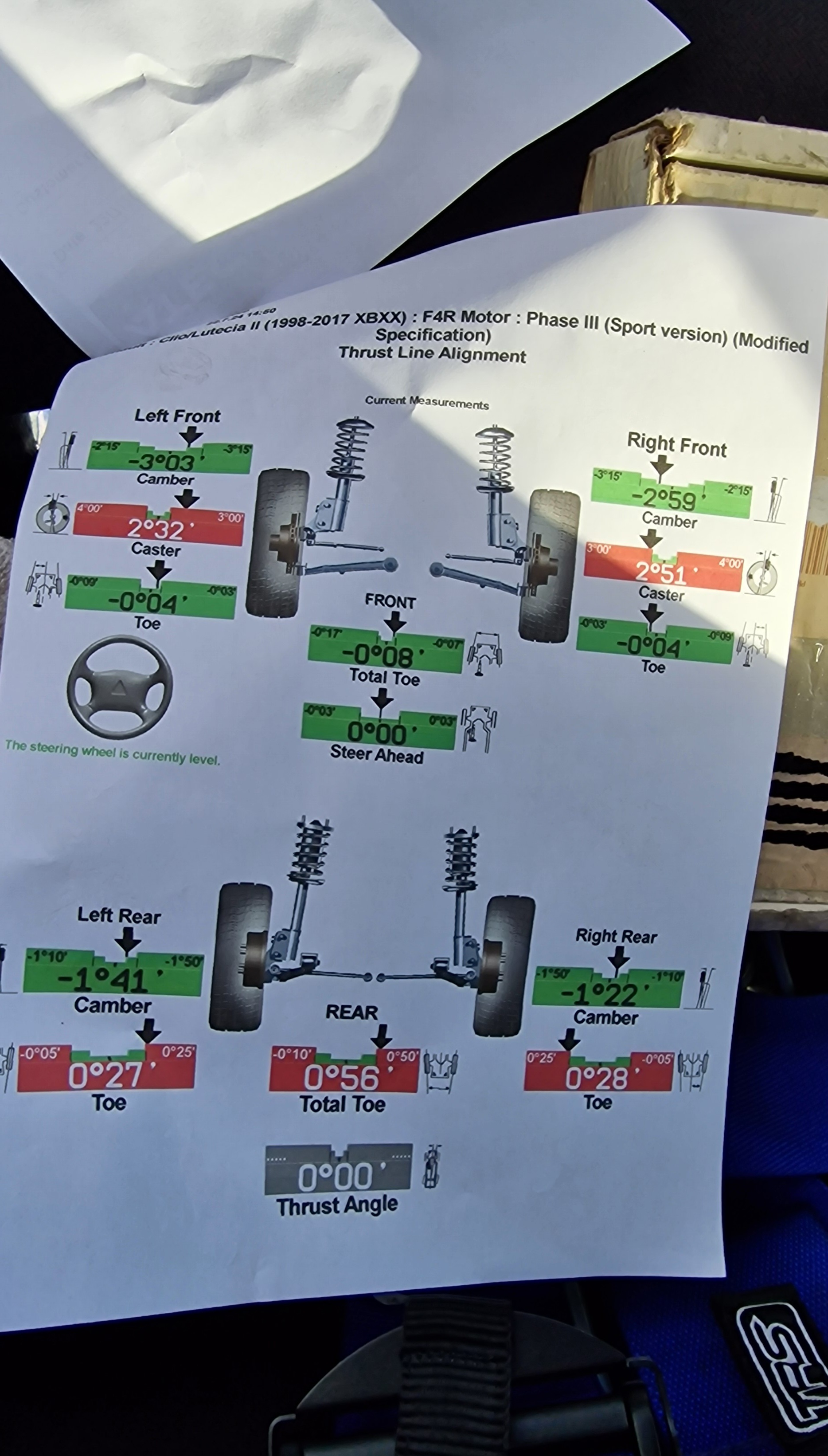

I also have shims, but I can't recall the exact setup - though -1.22 and -1.24 degrees sound familiar. It's not drastically different from your setup, so perhaps they were adjusted to correct it.
I'll check with my friend Dave, who set it up at Croft, to see if he remembers the details.
You can see the setup in action as I'm cornering. That’s a fast corner and the rear OS wheel is only lifting slightly, but the car is so flat. The tyre wear and temperatures are perfectly even, and the grip is incredible. I didn't modify my last car since I didn't think it was necessary, but now I've changed my mind.
It's definitely worth it, if only for the tyre wear benefits.

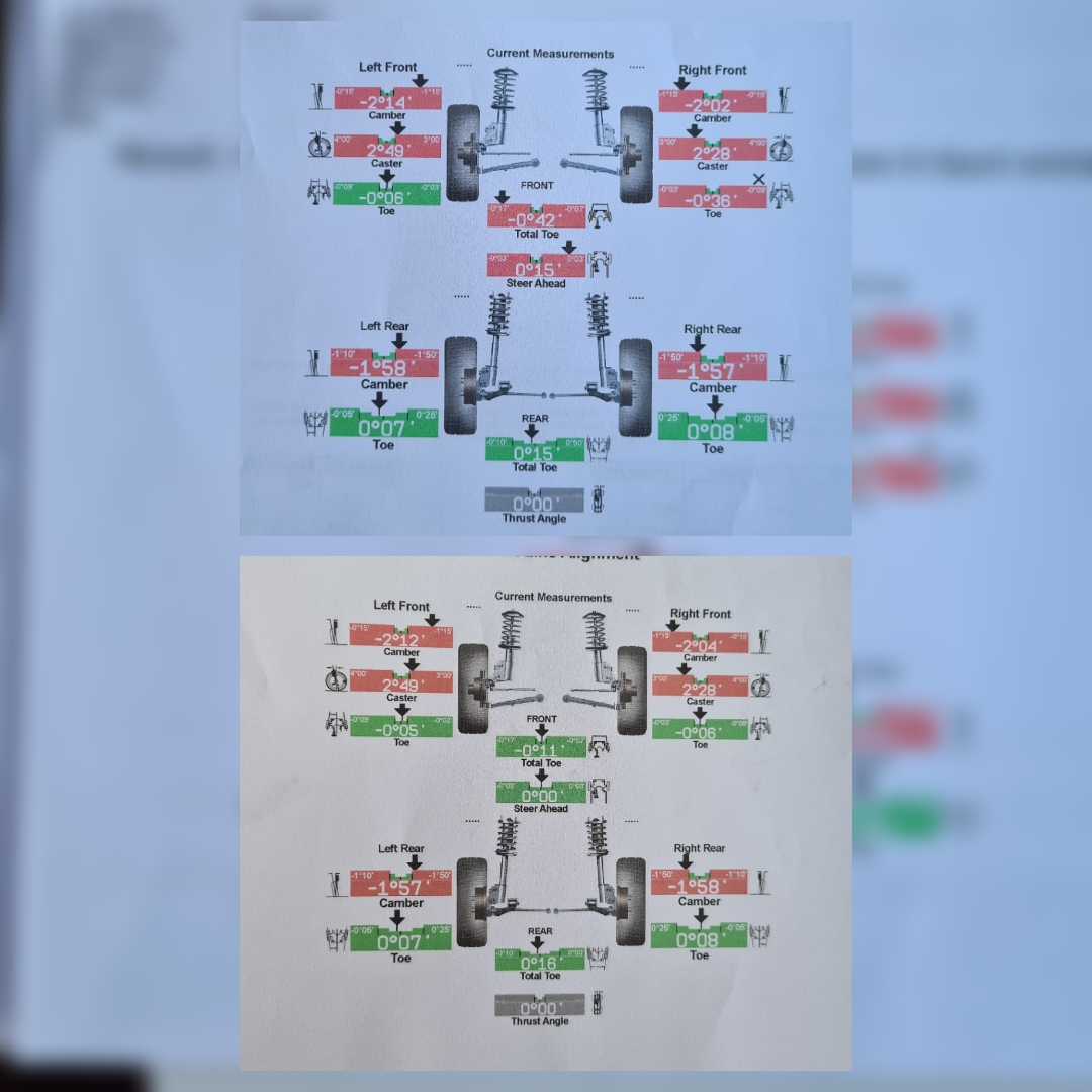

I've used shims to bring back the rear toe and they work fine.
Feels quite lively with the whiteline ARB set to hard. Does still eat up the rear outside edge a little bit so I'd say about -2° camber would be perfect.
This was before fitting coilover though so probably will need to revisit the whole thing again once it's all set up properly.

You have got -2 on the rear there practically mate.
60' being a degree, you've got -1°58' so 2' off.
MLB
You are absolutely right.
I've been looking at three different, old alignment sheets I've got and been up since 4 this morning 😂
To clarify, above was spot on, currently got 1°33' camber on the rear after messing about with the suspension again and that still wears the outside of the rears a bit.

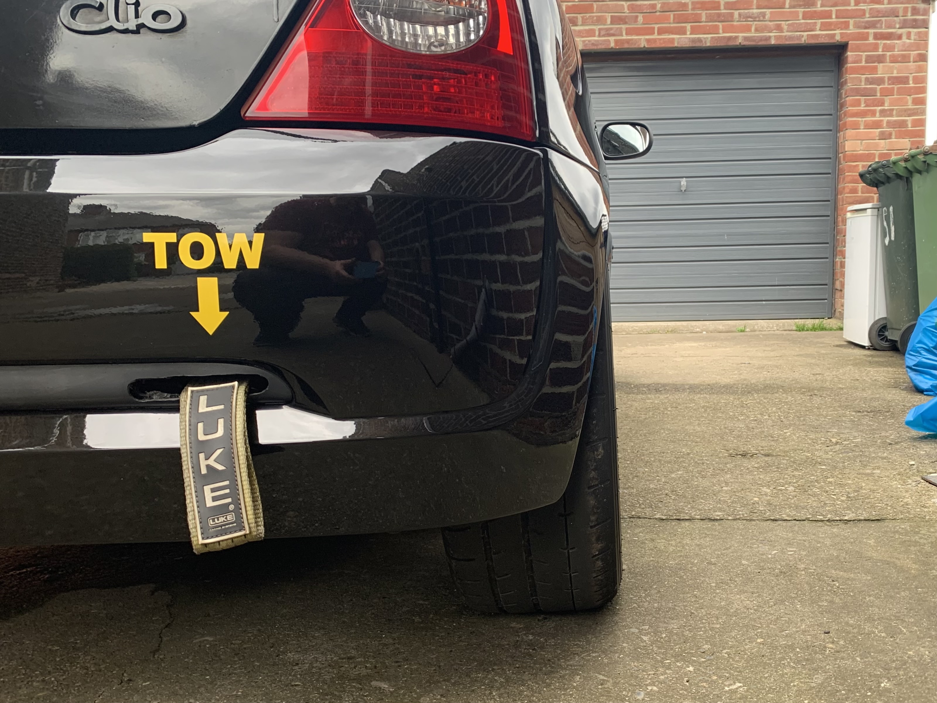

Your rear looks spot on there! (oo er)
Mine is similar, found -2 at the rear with a bit of toe in gives good turn in and stability, without rarb atm
From factory the front camber is much lower than the rear (0.5 v 1.5 +/- loads of tolerance for both) so increasing the rear a bit when increasing the front a lot, seems logical (I haven't read the suspension books etc)
Zero toe was pretty good as well, but I wanted a bit more stability being the daily, so added some toe in back
Yeah it’s spot on. The tyre wear is so even. I’ve done 5 Trackdays so far on a set of new fronts and partly worn rears. I reckon there’s another 2 left in them.

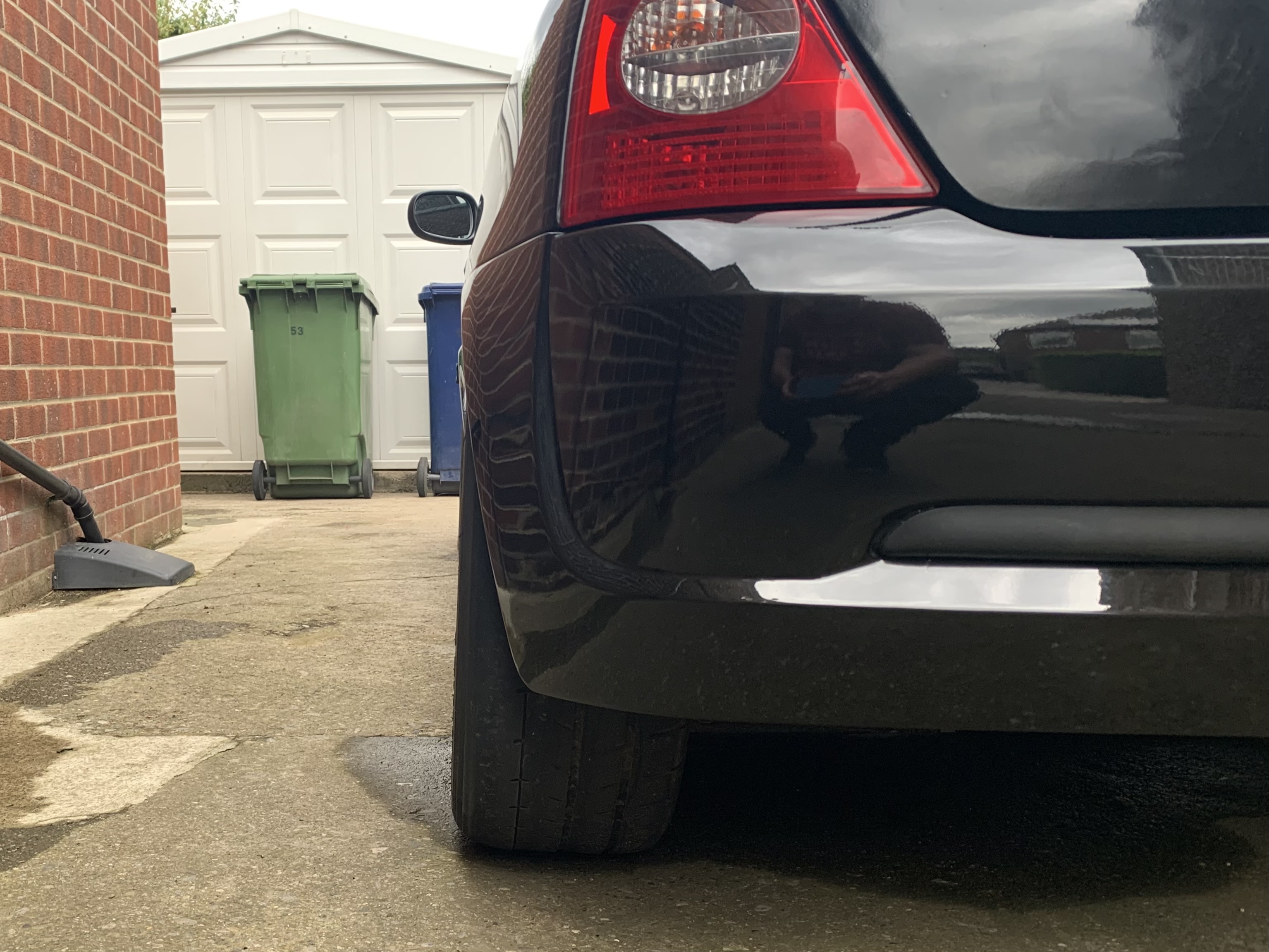

A better view of it. We did measure it a few months back but I can’t remember what the settings were 🤦🏻‍♂️
