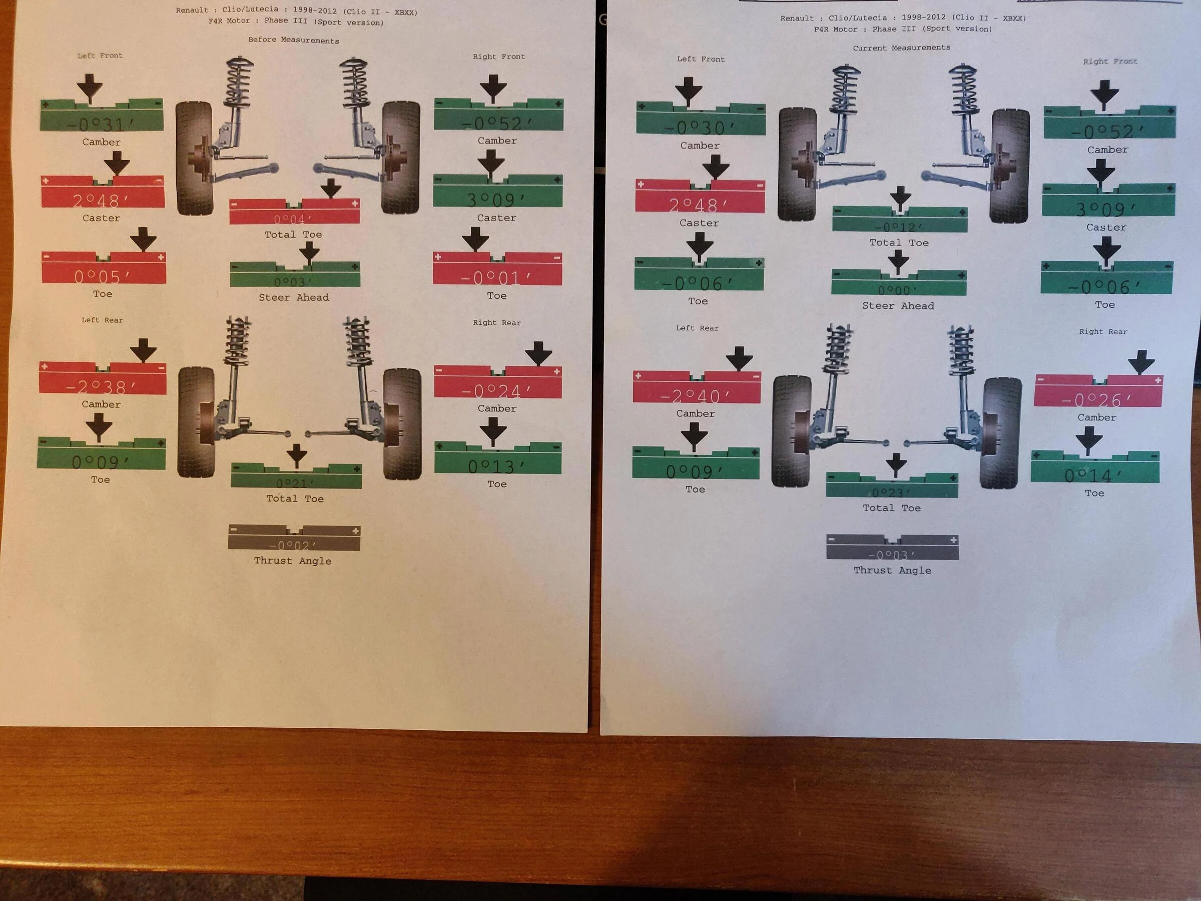

Got the 182 tracked yesterday following all the work on the front end (brand new OEM cup setup). Front has come into spec nicely, with the exception of NS caster, although not too worried about that as it's only slightly out.
Rear camber on the other hand is miles out. Any common suspects for this? Bloke writing up my invoice thought it might be rear beam bushes - doesn't quite seem to add up to me? Could see that knocking toe out easily but less sure about camber.
Could it just be an old slightly out of true beam? Bang some camber shims on it and call it good?
I've read the spec for a standard road setup is about -1°30" so a degree shim on each side seems like it would sort it out nicely, long as there's nothing else I'm missing.
Cheers
Before and after alignment printout below!
Sent from my ONEPLUS A6003 using Tapatalk
Cheers
