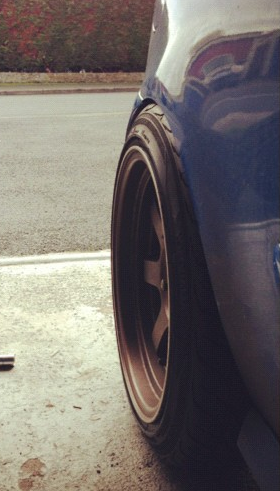

So if I were to fit that 2deg shim above, get the alignment checked and buy another shim (10,20,30min) to get it back to correct toe?
Would the extra shim make a difference to how far the wheel sticks out? I know the camber shim will make the bottom of the wheel stick out a bit more.
yeah it does, but you're talking tiny amounts of adjustment from the shims, 0.2mm on the shim could mean 3mm at the bottom of the wheel (think pythagoras LOL!)
I see, my brain is struggling to process it ha.
I'll have to do some pretty diagrams. Or just leave it and hope it works :o
Thanks Fred.
More worried about the clearance at the top anyway :o
