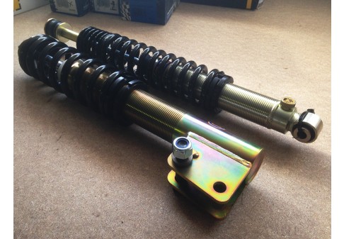

I've fitted a set of Escort Mk2 rear Bilstein Coilovers to the rear of my 172 Cup, and need some spring advice.
I had some14.5" 160/200lb springs on them, and the car just sat to high. I've changed the springs to 10.5" 225lb and the car sits way to high, with no room for adjustment.
Can anyone advice further on how to get it sitting right. When the weight is put on the springs, it drops about 1".
Helper springs have been fitted, and fully compressed?
GAZ use 9" rear springs with helper springs,
This leaves plenty of threads for adjustment.
You can fit them to a Twingo 133 so would assume that on a Clio they would work. I don't know what length spring or lb. People use Escort ones on loads of different things as there cheap and you have lots of options.
Need to measure damper without spring on fully compressed and full sag and take it from there but as kev says could just be it's to long.
